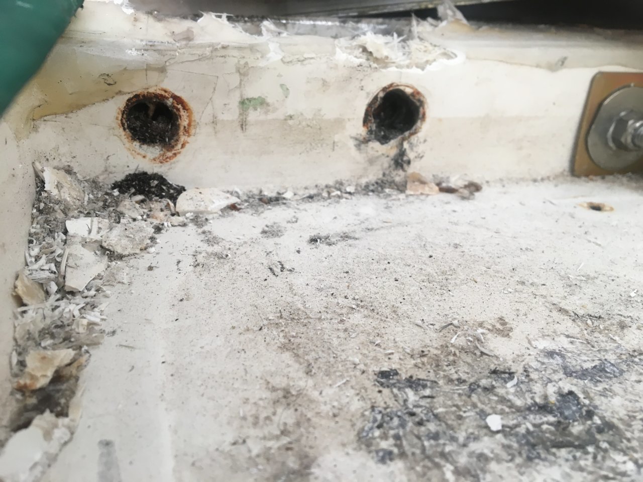

    I’m trying to remove one of the broken hinges for the top section of the camper (removing a sheered bolt and broken hinge) does anyone have experience with this? For the life of me I can’t get the broken hinges out of the housing! Are there actually 3 bolts holding it in, like the bottom hinge, or just 2. Can’t seem to find the 3rd bolt if there is one. Any insight would be greatly appreciated!

    Here is a picture of the 2 bolts I was able to remove, but still no luck getting the old hinge out. I’m afraid I might have to cut into the fiberglass and cut the actual metal sleeve to access the hinge. If anyone has some ideas on how to avoid this that would be amazing.
    This is the hinge to the top part of my Flippac.

    I believe those are it for the fasteners. @G.T. may prove me wrong though. :oops:
    I do know that they are siliconed in and you’d have to cut all that out to be able to remove them.

    Heaps of silicone in there. I don’t have a FlipPac anymore but if memory serves me there are only two bolts per side. The structure channels that the hinges fit into are steel and there may be a case of dissimilar metal corrosion going on creating a weld that you’d have to fight.

    I thought the same. Thx for chiming in! :thumbsup:

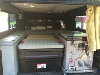

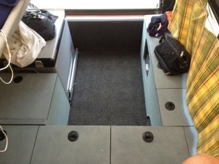

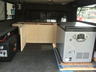

    I thought I would contribute to this post with how I set up the interior. I copied/modified some other ones that I liked and this was my final design. It was also my first time using a Kreg tool, building boxes/cabinets, lining up latches...LOL. But It all came together. I used trunk paint for the color.
