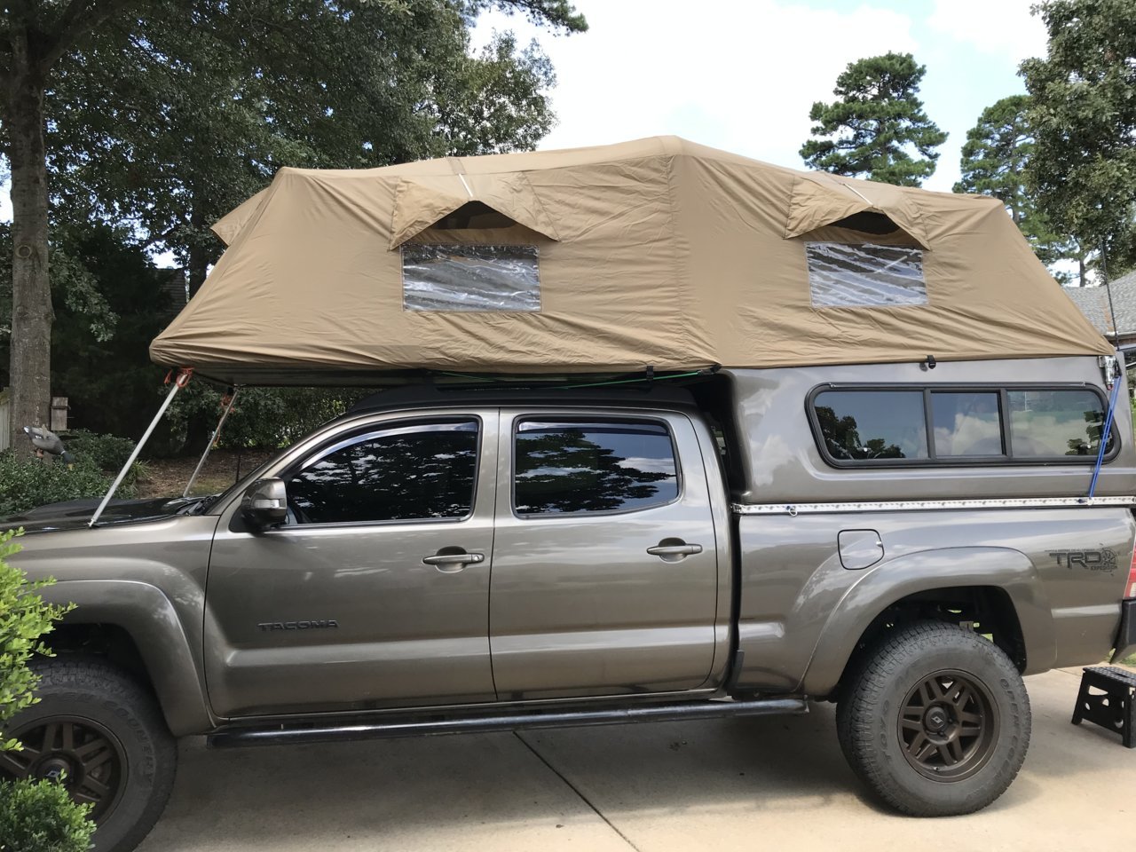

    So I'm gonna pull the trigger and order a new SLO rain fly. Do any of you have a picture of the "Texas Tan" color? on the website, there is just a swatch but Id like to see the whole thing. Debating between that and the "Silver".

    It’s perfect on my pyrite and easy to solo install...

    Well damn that actually does look really good. I just ordered it last night and talked myself into the “Charcoal” color to match the magnetic gray.

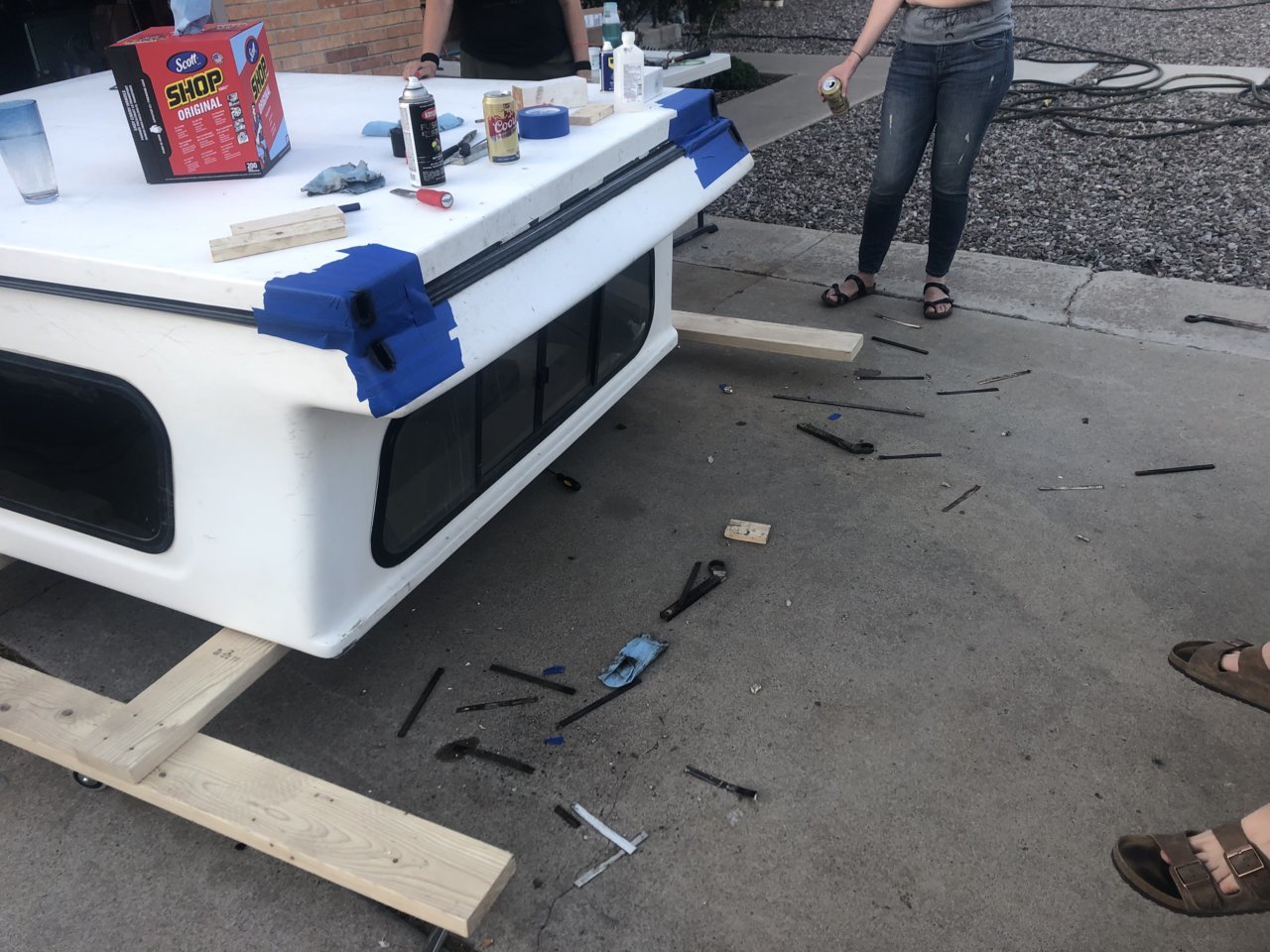

    Alright fellas had a heck of a day (more like 3 hours) workin on the FlipPac. On Tuesday I got some Sawy-A-Way hinges and got a few friends over to help take the FlipPac off the truck. We had to pry and hammer out the old hinges, damn they were in there. Cleaned out the holes and spray painted them with some rustoleum. The pac is in the garage till tomorrow until I can get the new hinges in and hopefully the torsion bar. Also the truck looks like a toy without the FlipPac haha.

    Welp with the help of a few friends got the hinges installed and the new torsion bar. Really not as bad as the videos I watched on YouTube, thought it was gonna been fuckin terrible. Just happy I can flip it open the way it’s supposed to!

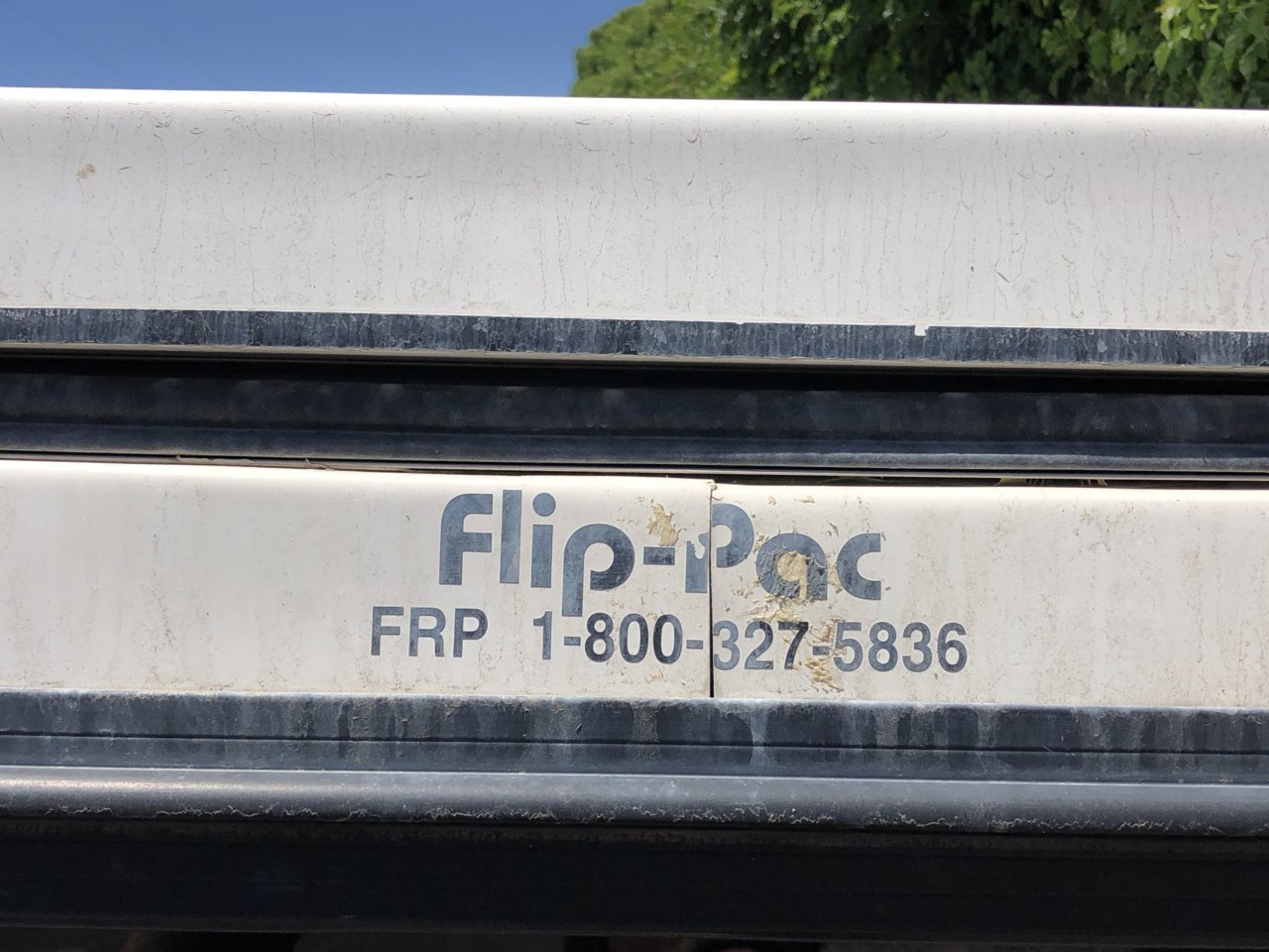

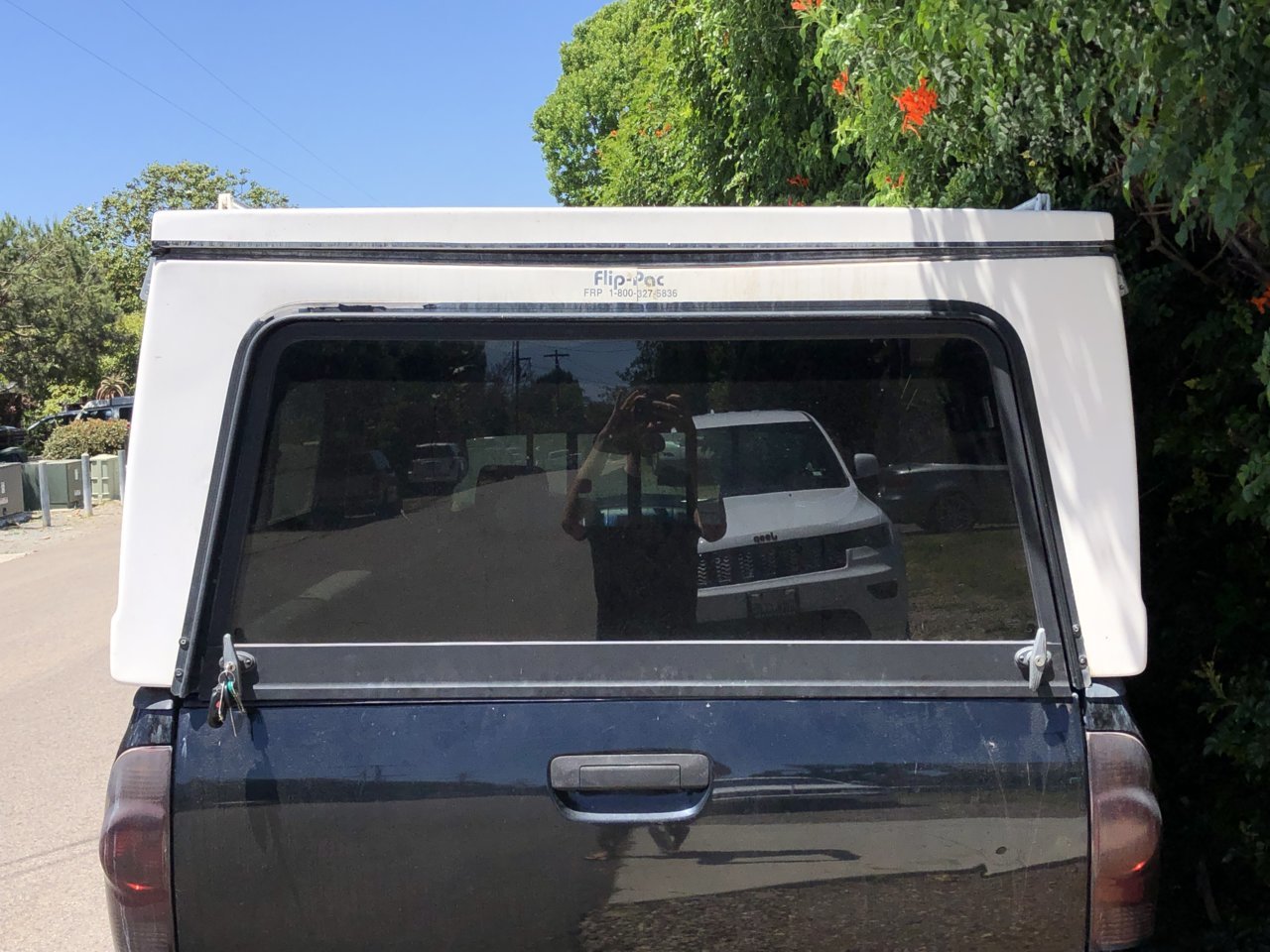

    How's it going everyone. New to the forum here. I've had my Flippac about 9 months now and the back of it has a crack that has gotten worse since I purchased it. As you can see it's starting to bow and not seal in the back. I've seen this crack in the same place on other Flippacs but cant seem to find any info on it. Any tips on how to fix this or how its constructed through that part of the camper? Thanks in advance!

    @G.T. Any thoughts?

    Well that’s a shame and of course right in time for camping season huh? Are you thinking about replacing it?
