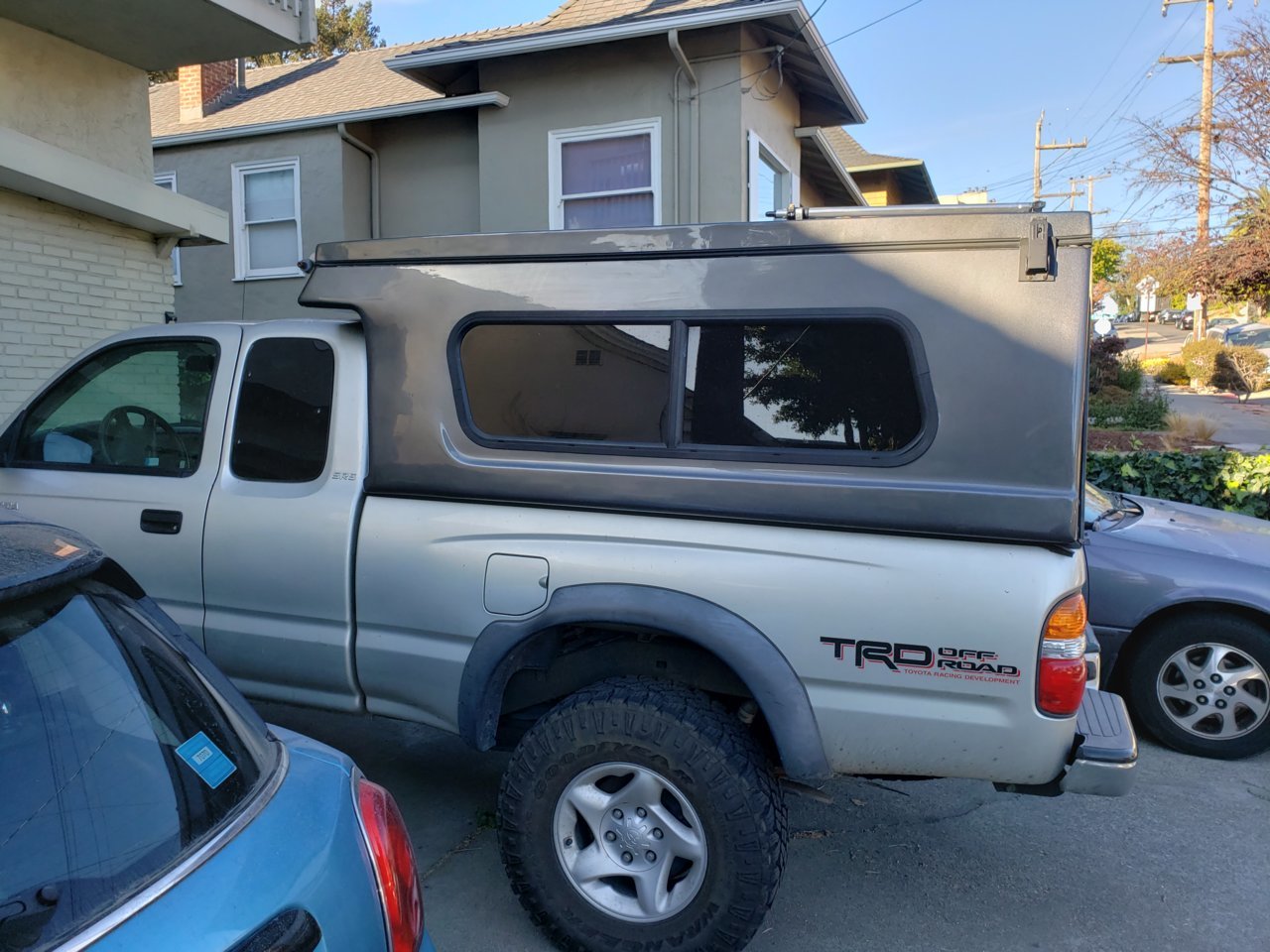

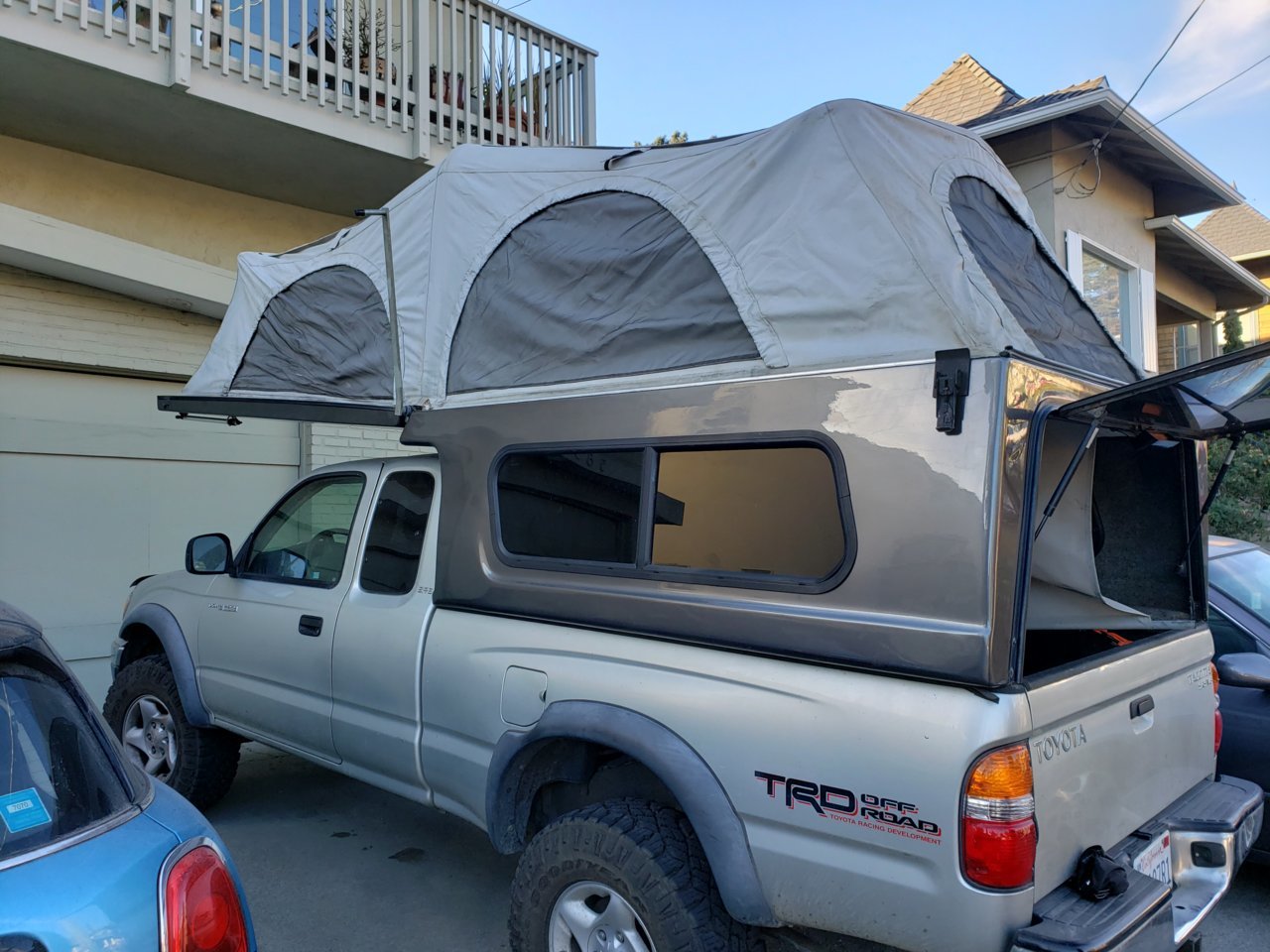

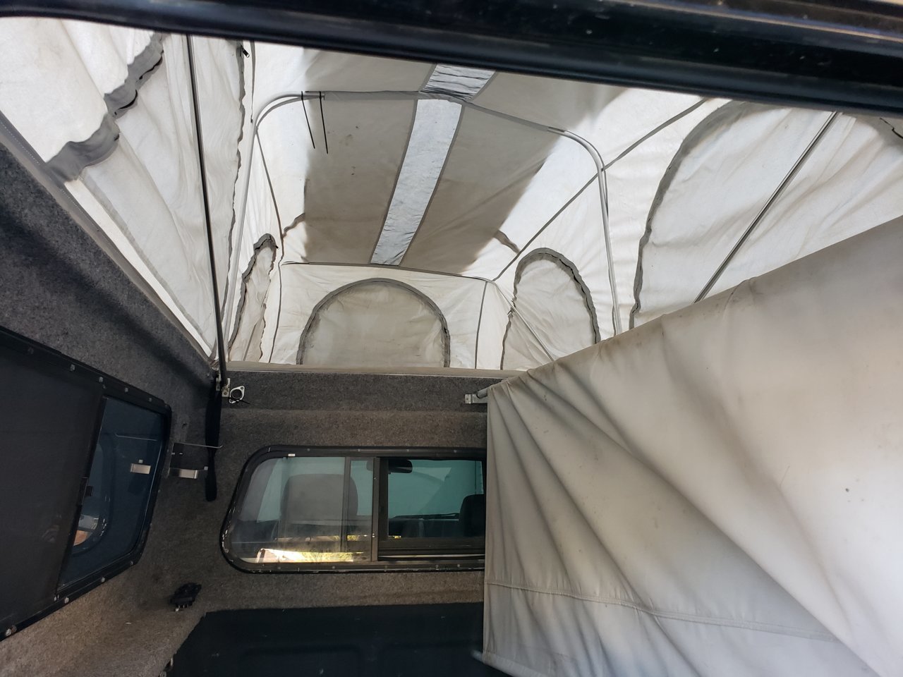

    hey everyone...i finally got a flippac. Been keeping an eye out for a while, had a few get away from me. This one popped up in Sacramento and i jumped on it. I've got it mounted on a 2004 xtra cab.
    I believe it's one of the later models from either FRP or AT, but before they started doing the alu versions...habitat.
    So it looks like the thing sags a bit as there's a bit of gap on the left back window.
    It's got the typical crack in the fiberglass in the middle of the back.
    I'm thinking of trying to ratchet it square and then mount it firmly to the bed rails. Hoping that provides the support and rigidity it needs.
    To do that, I will be:
    Reinforcing the bed rails - they're only 1.5" wide. At least it's not a composite bed like the 2nd and 3rd gens, but still, I'm thinking i'm gonna add square rail under the bed rails with uprights that bolt into the bed and ideally the frame. I'm also thinking about then using some 4 or 5 inch wide flat steel to make bed rail caps that are wider. Will probably fab up a couple of those bed stiffeners at the tail gate area.
    Then...more projects like adding racks, building out interior somewhat.
    I'd appreciate any input from guys who've had a 1st gen + flippac for how they had it bolted down and any other insights.
    Been reading through this thread a lot.
