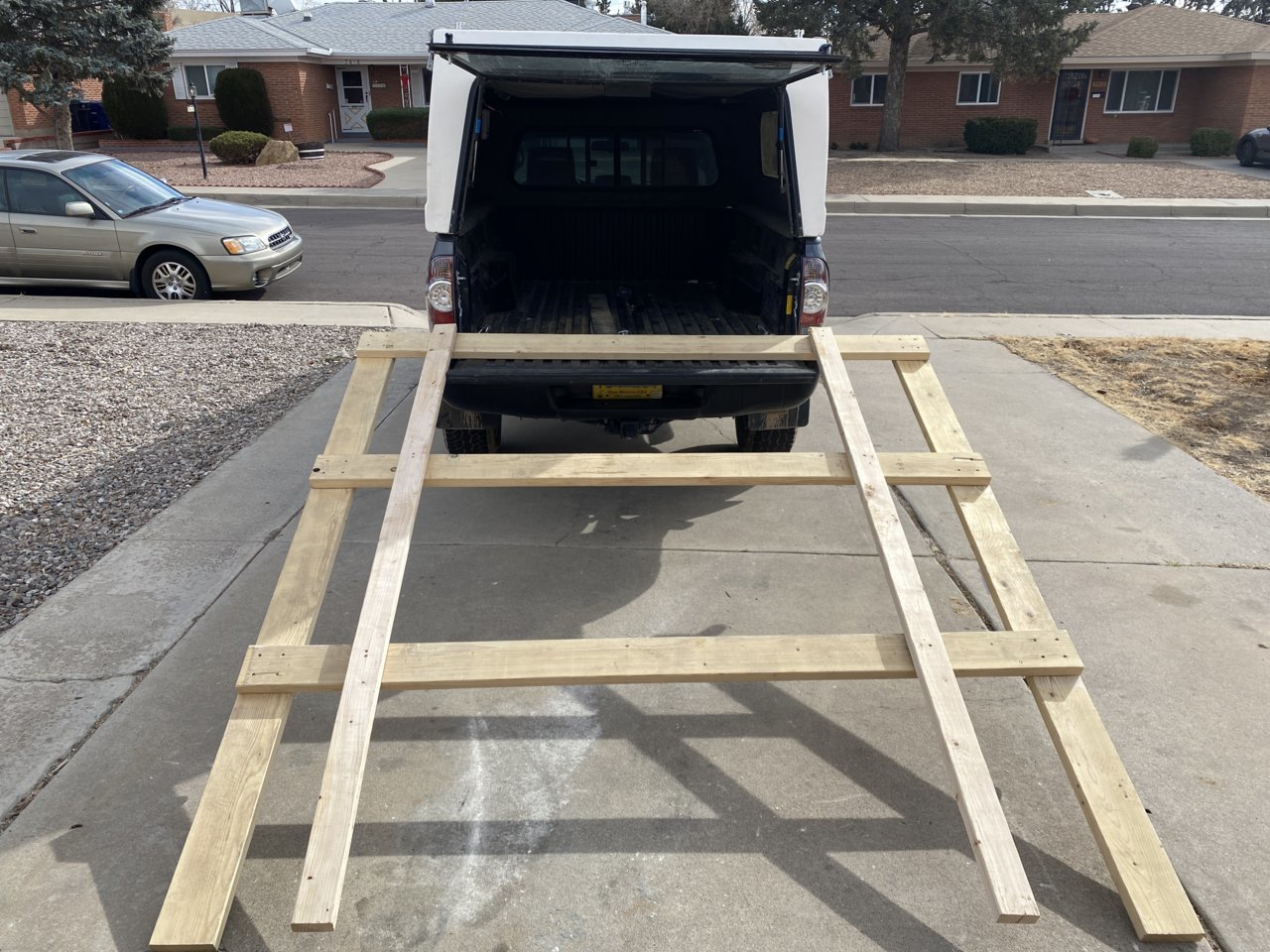

    Welp I’ve got a few friends dropping by in a while to help take the FlipPac off so we can assess the damage better. In the meantime I threw together my dolly to help with the process.
    Well sure I don’t have stiffeners but as I mentioned I wasn’t sure what else to call that part of the bed that the aftermarket stiffeners would bolt too. Anyway, thanks for the info I’ll see what I can find that extend all the up.
    That’s more or less what I’m afraid of the majority of the off pavement is fairly bumpy and when I wheel there are surely boulders/steps that I’ve got to bump a bit considering I’m open in the rear and got the 4banger haha. My railing system seems to be ok for now but I need to come up with a better solution the FlipPac slides around from time to time so I’ve gotta adjust it often after wheeling trips. I don’t tend to get it super tight because I’m afraid of cracking the fiberglass or ripping the railing out like you have.
    I’d be interested to see what you come up I’ve been meaning to do some try I get similar with the spacer. I was chatting with a buddy about more bracing so I’ll be interesting to see what you come up with.
