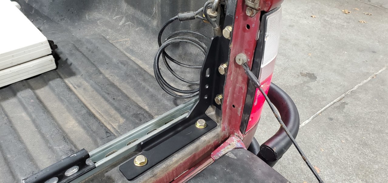

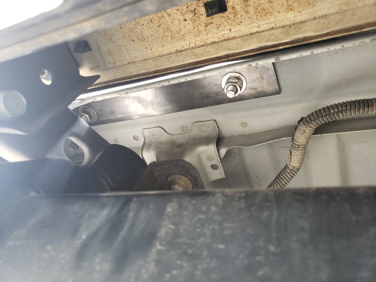

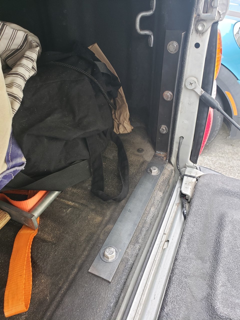

    So i finally got around to fabbing up these bed stiffeners...
    i noticed that the passenger side side of the bed was slightly moving out (~1/16th or less)...and then just before installed them, i had taken a drive up HWY 1 and hit some pretty good bumps at speed...at the corner of the bed, near the tailgate, the bed 'side' had a small tear from the bed 'flat' and had shifted downward, away from the bed. It's covered up by the bracket, but when i pull 'em off again to paint them i'll take some photos.
    so yea...now these are installed. feeling better about it. There's also a 1/8" backing plate behind the taillight for the uprights. Second photo is the 3/16" backing plate for the horizontals.
    next up is replace the 2x4 spacers between the flippac and the top of the bed with aluminum tube...

    If I were you, I'd put an additional gusset between those two uprights.
    The top of those bedsides see large moment forces when wheeling with the weight of a camper/flippac on top.
    The Rago fab ones I got have been super solid, but even still there actually is just the smallest bit of play if you really swing on the bedsides.

    i thought about that....figured i'd see how the angle iron held up at first...i also don't want to limit the width of the gate.
