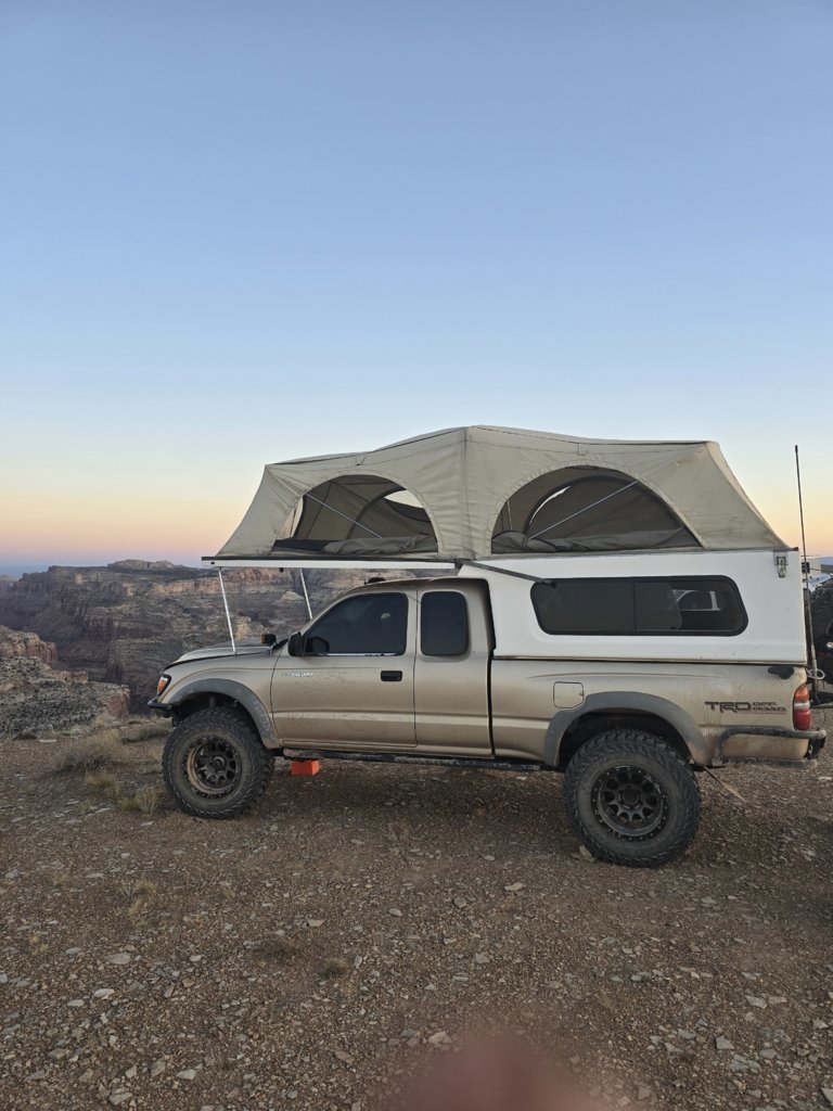

    Took my flippac though Utah, it didn't pretty good I need to mount it a little more securely as it moved around a bit. Trying to put the rain fly on was a major hassle and ended up taking 3 of us. Lol.

    The easiest way I have found to put the rain fly on is to attach it to the legs while the lid is still closed, and then open it so that the fly pulls itself over the tent. Just be mindful that the little pole that holds those vents open doesn't catch on the tailgate or handle for the back hatch or you'll get the lid halfway open and it abruptly stops.
    Next I tie the back down so that it covers all the tent material and comes over the fiberglass (just like in your photo) and the final step is to pull the front of the fly over the corners, and attach the poles to the tabs on the fender to hold the lid down. I've found that if I don't tie the back first, it can be really difficult to get it tied down if the lid is already secured to the fenders.
    Hope that all makes sense.

    I understand. That's what we tried to do but the fly kept falling off to one side. Lol. I lm gonna try a few more dry runs . I may try lossly tying it to the back to help preventing it from sliding to the side.

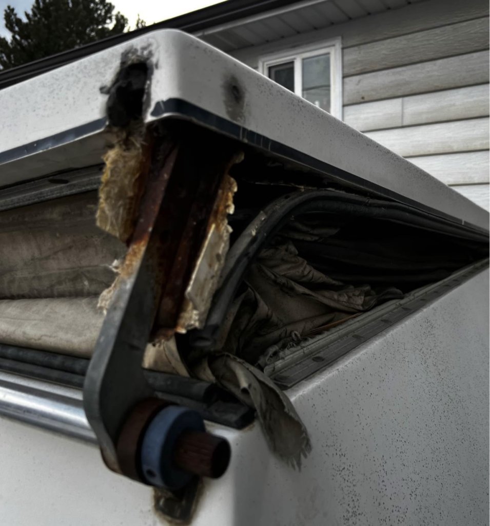

    IMG_7473.jpg Hello everyone, I hope you are doing well,
    I just came across this forum while doing research on flippacs. I am currently looking to add one to my Tacoma. On my hunt I came across one of interest but it does have a glaring issue that needs repairs- it is one of the hinges (see picture). I was wondering if someone with more experience could help me determine the difficulty of the needed repair. I do have experience with metal fab/ fiber glass repair and DIY so I am confident in my abilities- but in this flippac’s case I am unsure if the risk of repair compared to the asking price.
    Greatly appreciated, have a good day!

    That sucks. I guess it depends on how much they want for it. The inner metal pice probably needs to be replaced too.

    Appreciate the input. Right now the price is a little too high and they are firm. Should that change I’ll go take a look in person to get a better idea.
