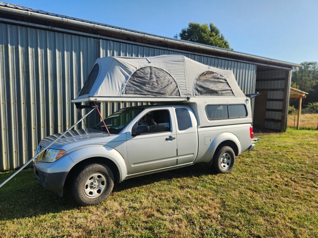

    Hey flip pac-kers,
    I am weighing a torsion bar replacement versus just selling my flip pac as is. Its currently on a low miles 2wd Nissan Frontier. Camper is in good working order other than the broken bar. I am getting older and I'm not in love with using the pole to flip it over.
    Could peeps weigh on what would be a reasonable price for the camper if I sold it. I live in Oregon. Also, I have read about the sway-a-way (now x-sway) torsion bar surgery but strangely never seen a posted video of someone actually doing it. Any references for such a thing?
    Thank you!

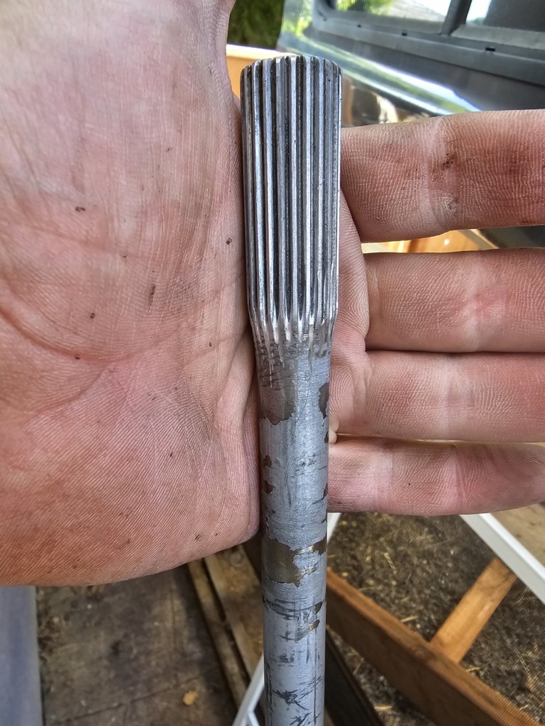

    So I finally got my bar and tried installing it. Turns out one of the splined ends is bigger than the other and therefore bigger than the accepting splines on the hinge and bushing....
    I will be reaching back out to sway a way on Mon...I am hoping they will stand by their product and services... there is a 1 year warranty...so we'll see... but pretty disappointed at the moment.
    update: shipping it back to Sway-a-way/Xsway...

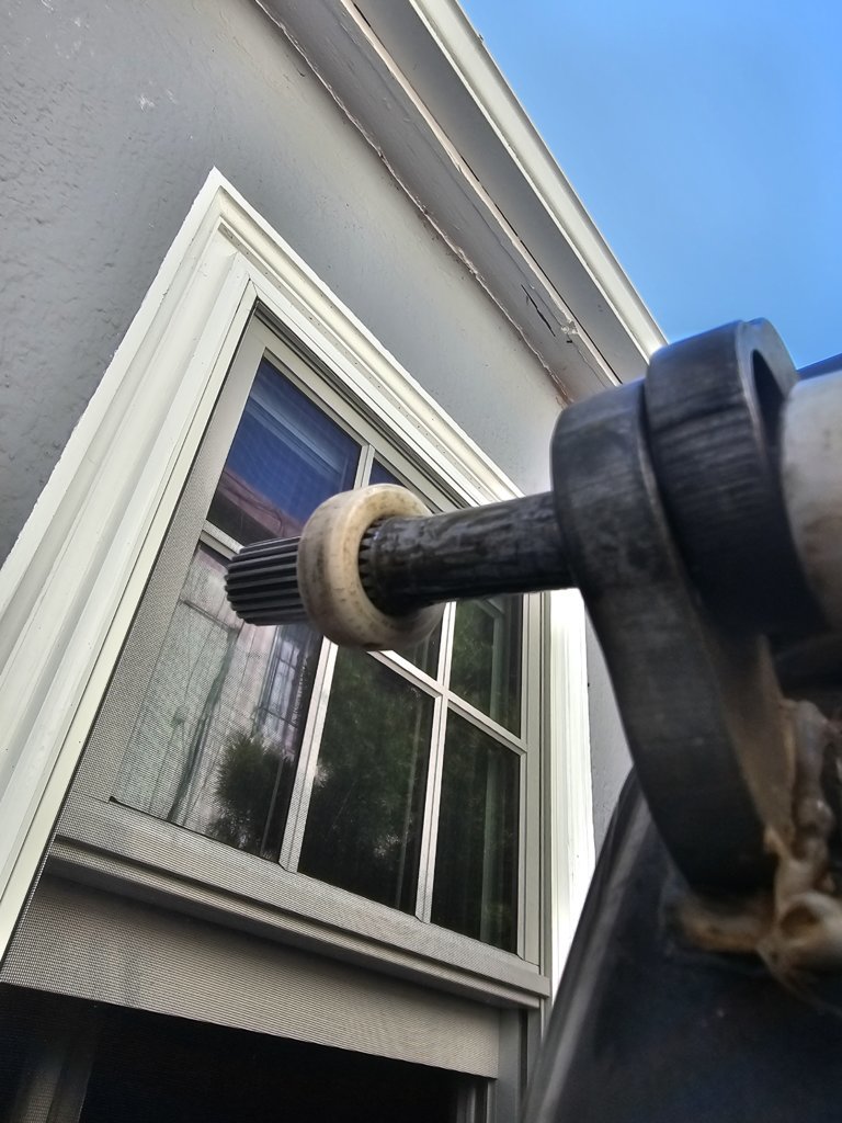

    So regarding install, I did it off the truck on a square frame I built for the flippac...Basically just slid it straight back off the truck. With the flippac off i bought a lumber rack on the side since I have some lumber hauling needs in the meantime. To keep the lid from flipping past 90, i parked my truck just in front of the flippac and lashed a couple 2x4s vertically to the lumber rack. These would catch the thing from going too far past 90.
    Bar gets inserted from the passenger side. Longer splined side goes in first and is on the driver's side. I put a clamp on the driver's side hinges to keep the plastic bushing in place during the whole exercise.
    To get the lid to vertical, I threw a rope loop around the back of the lid and tied a loop on the other end. I then had a buddy throw a pair of ratchet straps onto a line between the front bed hooks. These would be used to pull the lid the final way to 90 degrees. We used 2 so you could switch between them as they got stuffed with strap.
    I got the lid to about 60-70 degrees or so from horizontal using an 8 foot 2x4 pushing on the side "lip" of the lid.
    Once the thing is at 90 or close to it, it's pretty easy to manipulate it since it's pretty much balanced. The vertical 2x4s and the ratchet straps acted as a safety and kept the lid basically between like 80 and 110 degrees.
    I marked where the groove where the bar spline should go on the passenger side hinge as a guide to help line up the bar. Once we got it aligned, smacked the end with a hammer and it went in pretty easy. Put a new collar on the driver's side. The bar should stick out 3/4" past the collar.
    Soooo...all that being said, here's my rant about swayaway. So overall, it took 8 months or so to get the bar after I ordered it. That wouldn't be so bad, however when I ordered the thing (back in Nov), they told me it'd be 2 months. I kept checking in on a 1-2 month basis and kept being told it would be longer. As spring/summer approached i was like ok, camping season is getting close. Still not ready...mid-May they told me that the there was some issues with the part and they were working on getting it right and would ship at the end of the month...2 months later i reached out and was like what the story? They then told me it was ready and gonna get shipped that week. Great! So I received the bar. Tried the bushings (apparently only on one side). Went to install the thing and it would not hammer in. We gave up and I pulled it. We tried to caliper it but it was hard to get a good reading so I just tried to slip the bushing on and lo and behold it doesn't want to go on at all. Ok, passengers side is too fat. Reach out to sway away and they gave me a shipping label, said they would either fix it or send me a new one. Two weeks later I've got the "fixed" one in hand. Bushing slides on. Cool, send it. We try again and again the thing doesn't want to hammer in. We figured out that the chamfered end is still too fat and so the bar is getting stuck on the chamfers and not sliding into the splines. So long story short we took a dremel to each chamfered spline to cut out enough material so that the bushing would slide over without issue. And finally got the bar installed.
    I really don't want to shit talk a small business that says they want to do right, but I'm thoroughly underwhelmed by swayaway. They also told me that there was something wrong with their system and undercharged me for shipping, and said they had already covered it now multiple times with the return and wanted some more money. At that point i was, like uh, in light of how we got here, i think thats a bit much?
    If someone could figure out the torsion specs on this bar, you'd prob be better off finding a local machinist to get the splines cut. Super niche part, so there's that. And I'm glad that someone is willing to craft it and sell it. But if any one here is planning on getting one, don't expect to get it quickly. And when you do get it, verify the bushings slide completely over both ends of the bar.
    After dremel
    Here's how far the bushing would go before getting stuck on the chamfered section.
