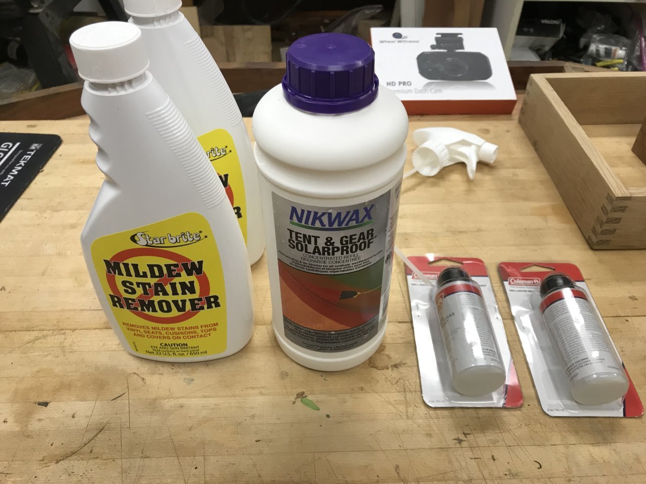

    The mildew remover is more for my back patio, nothing really on the tent. Nikwax Mainly for the rainfly, but should I put it on the tent too? Coleman Seam sealer is a roll on, how heavy should I go?

    It’s GTs FP, he’d better input.
    7 nights so far, but not in any rain. Still haven’t put the fly on in the field. Just curious what needs to be done vs what can or should be done. Thinking a CO trip in August with some other Razorbacks :thumbsup:

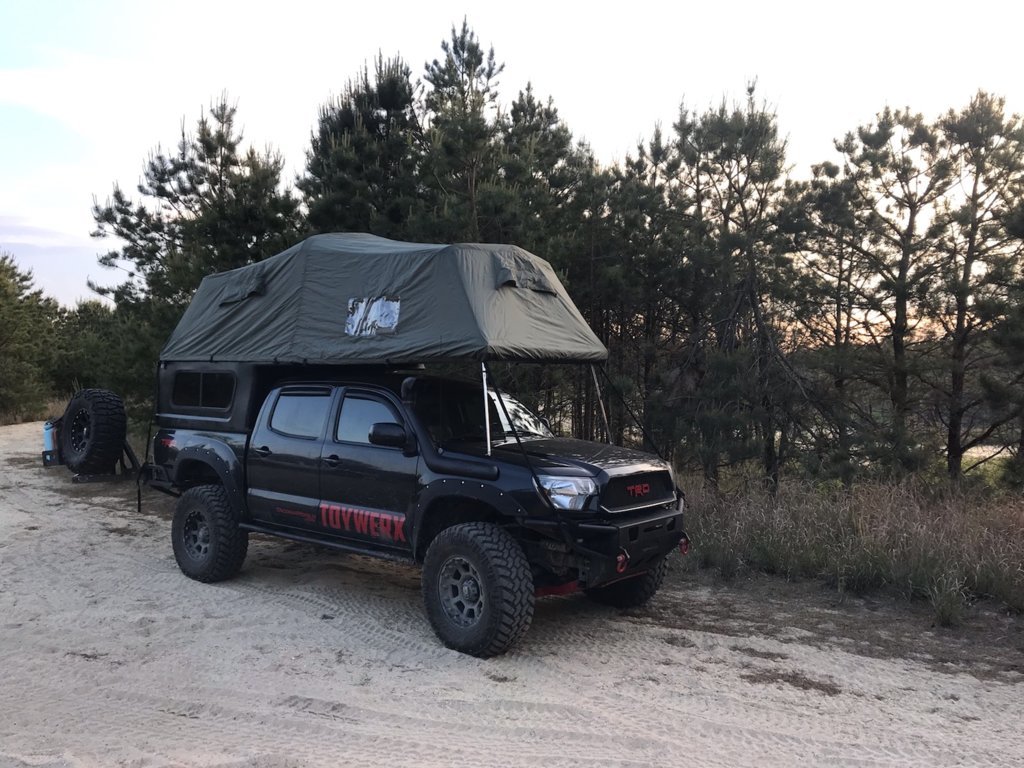

    It has rained on me the last three times I’ve been out with the Flippac.
    Each time I had of the rain fly installed and was completely dry. :D
    Most recently last Sat night in the Nj pine barrens

    I never did anything to the rainfly but I did spray the whole tent exterior with two coats of nikwax on the outside and after a weeks drying time two exterior coats of that Sawyer brand permethrin insect repellent.

    I haven’t had my FP for long (two night out so far) but the previous owner used Nikwax on all the the seams of the tent and SLO rain fly then went back and used some other weatherproof silicon spray I have no idea what brand. Anyway it rained both nights on and off and nothing was wet so I’d say it worked well.

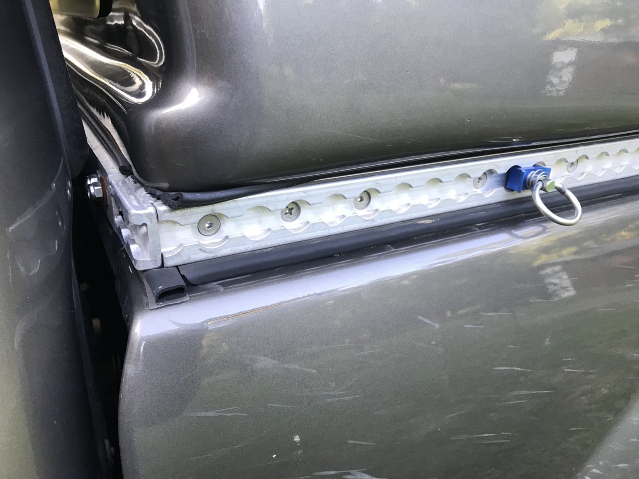

    Put a spacer in between the flippac and the bed rail. Problem solved.
    I plan on doing this to mine anyway to allow space for my prinsu rack and in-bed tiedowns.

    That’s what I did and I got my lash points inside back.

    G.T.: what material did you use as a spacer?

    Rectangle aluminum tube, and L-Track around the inside and outside.

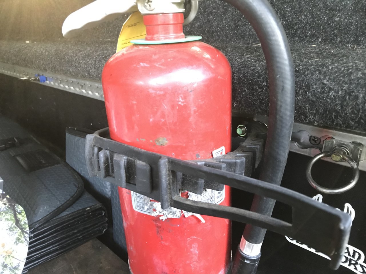

    Here’s what GT added and I’m continuing to appreciate . Besides the spacers on the outside they’re great for tarp or Hammock tie offs. Inside they’re great for anchoring all my gear and for mounting fast grips.
