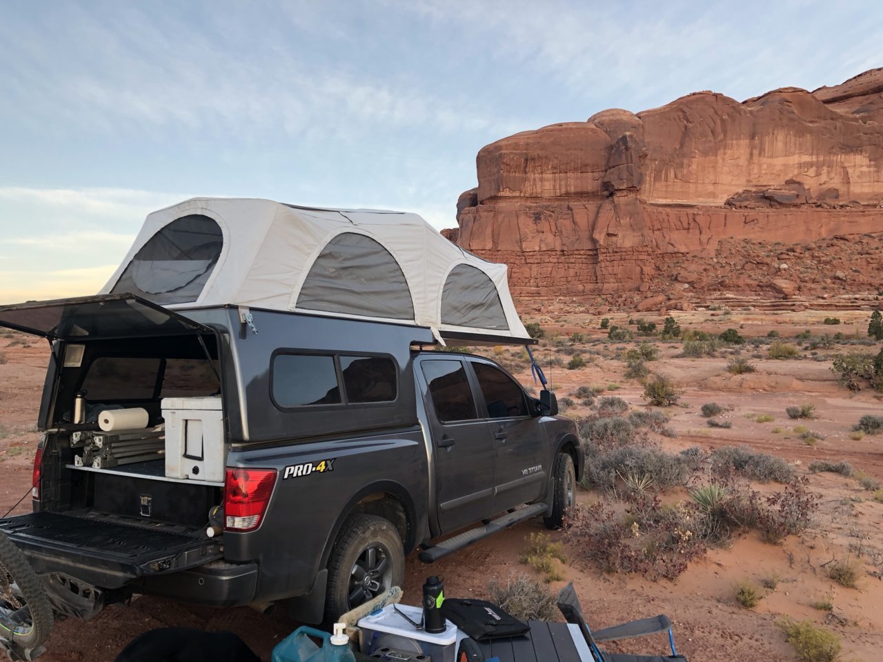

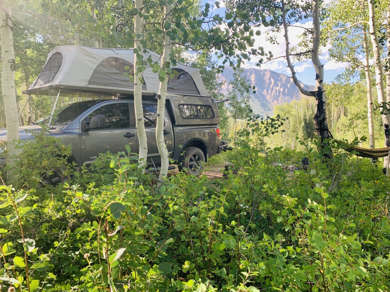

    So happy to stumble across some fellow FlipPac Brothers (Sisters)!!! And just wanted to say hi and keep up with conversations here.
    I'm here in Colorado, I've pretty much torn down are rebuilt my entire setup.
    Hope no one hates on me to much for not having a Taco...
