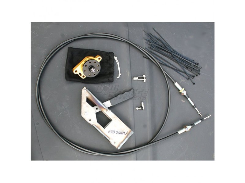

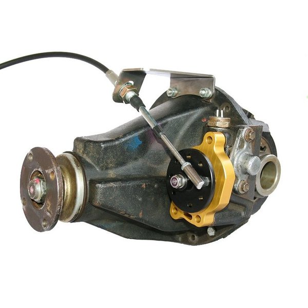

    Just be aware of lockers, and their "temperament". You need to be off the throttle as you round a corner or else they'll snap, pop and chirp your tires. Just don't expect a smooth, quiet, factory experience. ARB's give you both worlds, however with ARB's you need the compressor which adds a level of possible failure...you've heard this argument from me already.
    If I don't go 8.4 with a Detroit, I've been eye-balling this gadget from Chilkat to upgrade the e-locker.

    Ive heard of the e-locker failures. I had one in my 03 and never had an issue. Are most of the failures related to the locker not engaging or is there an issue with the actual locker as well? Either way that cable kit looks like a cool product.

    Solenoid going out, solenoid stuck, factory only allows it to engage in 4 low, 8.0 vs the larger 8.4, bash the solenoid on a rock.
    You can remove the solenoid and lock the rear by hand, but what a pain in the ass.
    If you take care of it, it's just fine, and I'm not recommending everyone get a Detroit full-time locker lol. Everyone's needs/wants are different.
