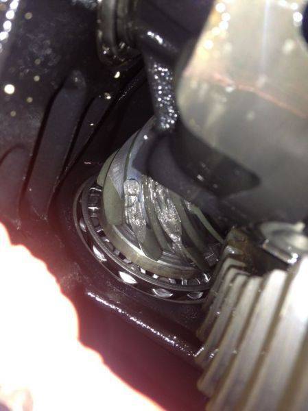

    Yep. Konsta seems pretty positive on this. I have yet to pull the rear to confirm but we ruled most everything else out at this point.

    you drain the fluid yet to see what falls out?

    Drained and strained it. Only found a couple little tiny slivers and I mean tiny. Konsta got in and listened to it when I passed through Pocatello and he is still positive that it's missing a tooth. He's been in that same boat a few times.

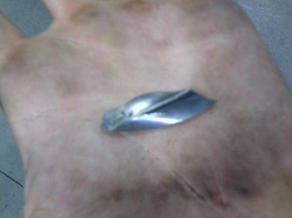

    this was found in the pumpkin when my pinion lost some teeth

    lift the rear axle up, put it in drive and listen for the noise

    Yeah... That is much bigger than what I found! I found 4 little slivers that were like the size of grains of sand. The oil was dark, but it's Redline and was pretty dark when new.

    I did. I had to engage the locker and partially set the ebrake to get it to make the noise (just like last time) and I'm pretty positive it was coming from the ring gear. The whole axle housing would rock every time it knocked, and the drive shaft looked fine the whole time.

    damn :eek: when did that happened?

    that was summer '13
