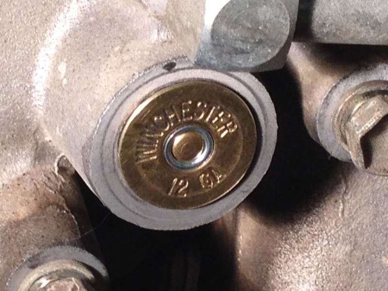

    Too big, those are .22lr size I bet. Speaking of that, the EGR plug on the white dragon is a 12 gauge round. Fits perfect.

    Nice live primer :D

    It's a blow off valve. :eek:
    Stick some in the oven, it takes a lot more heat than you would think to cook them off.
