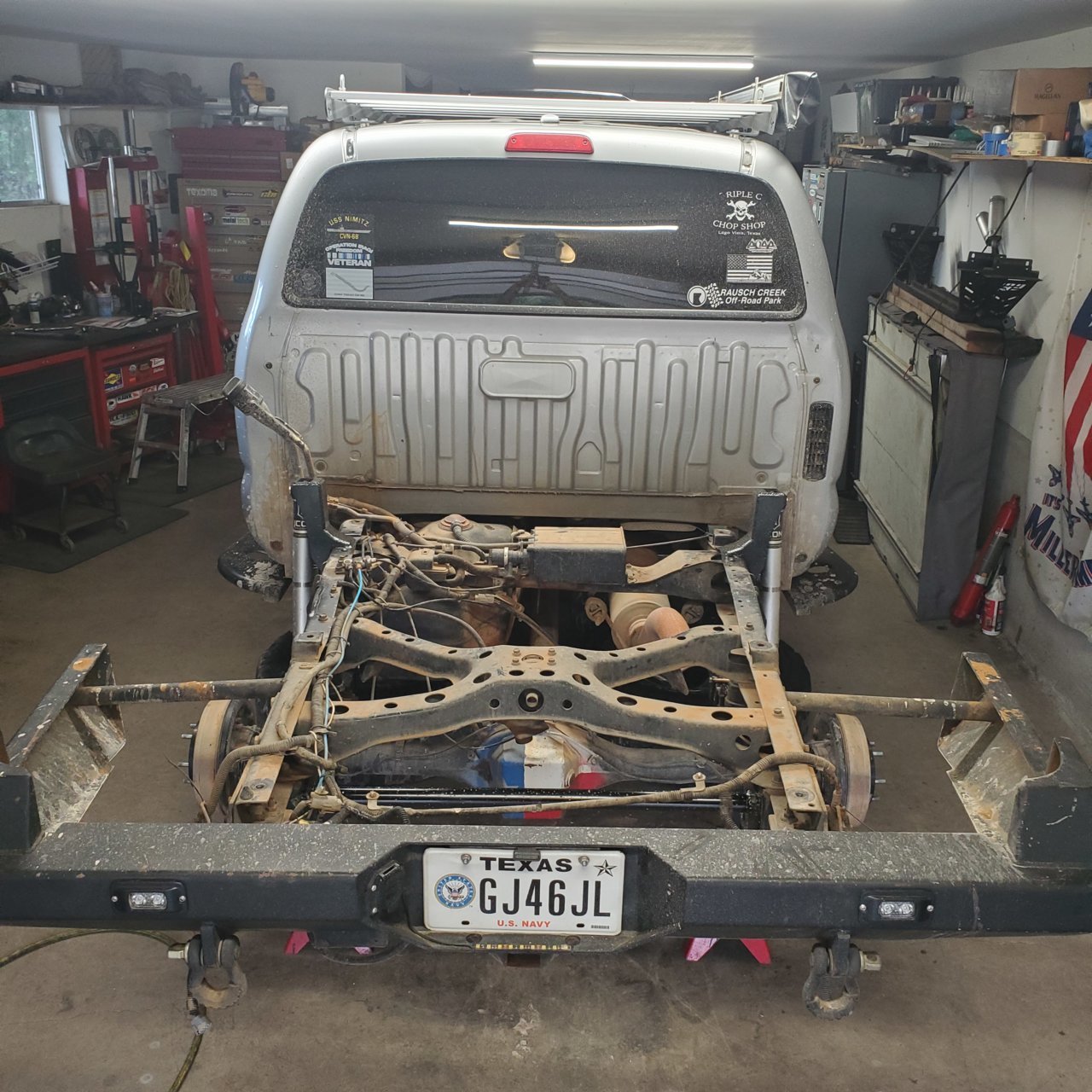

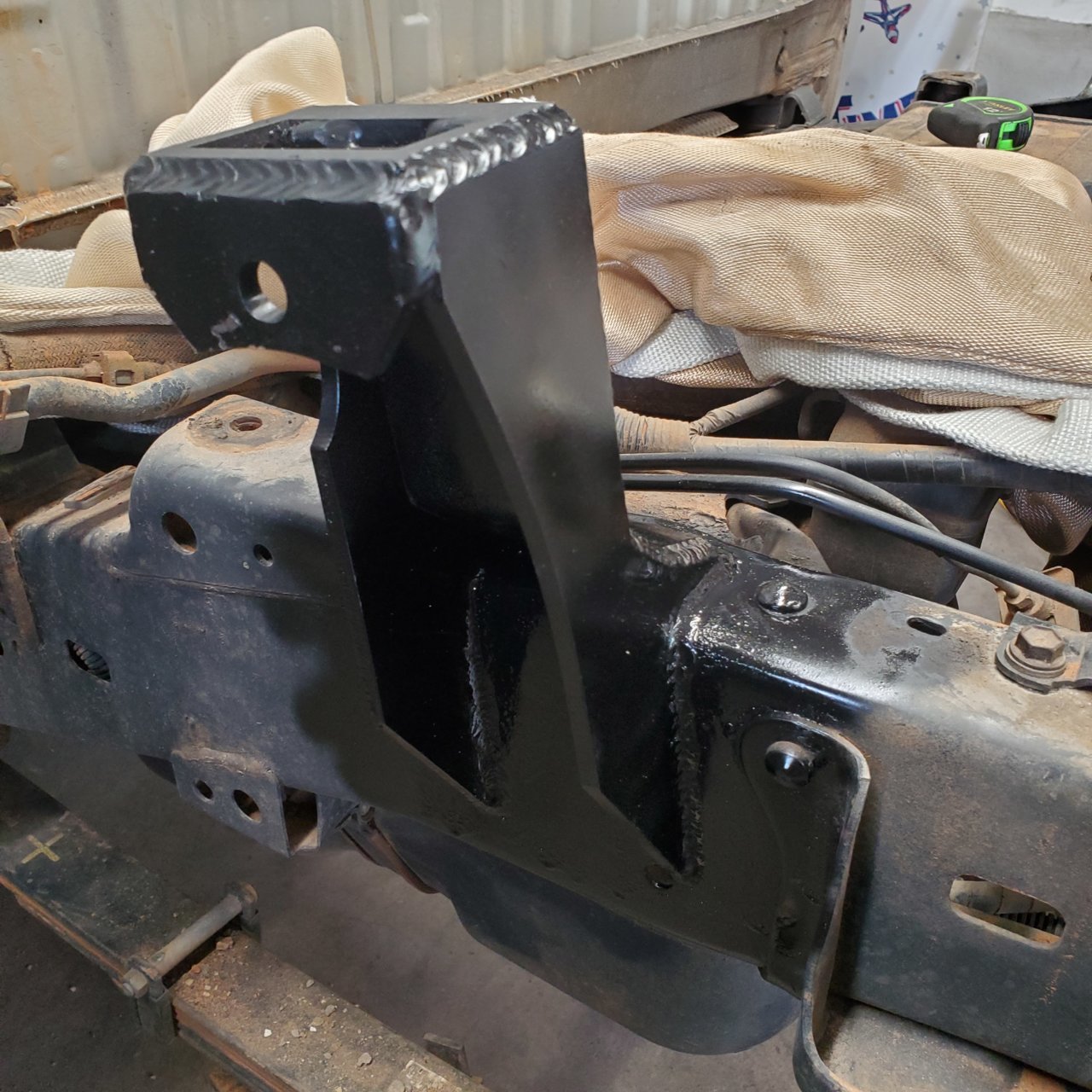

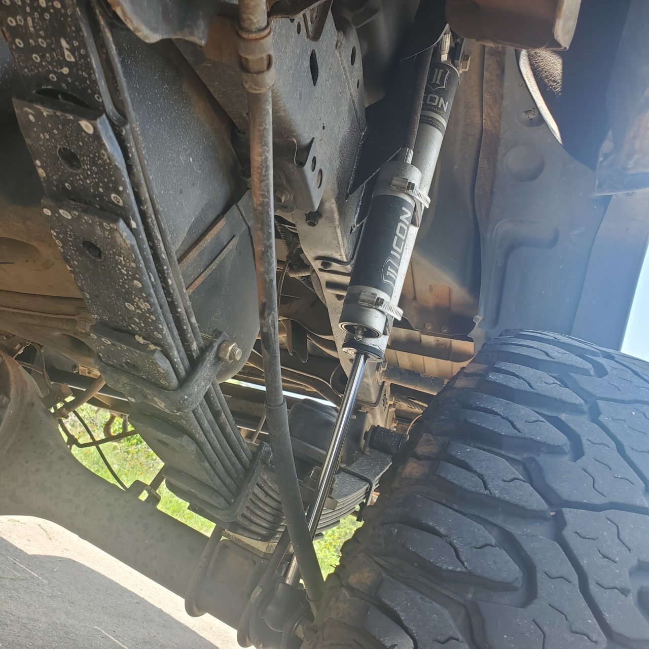

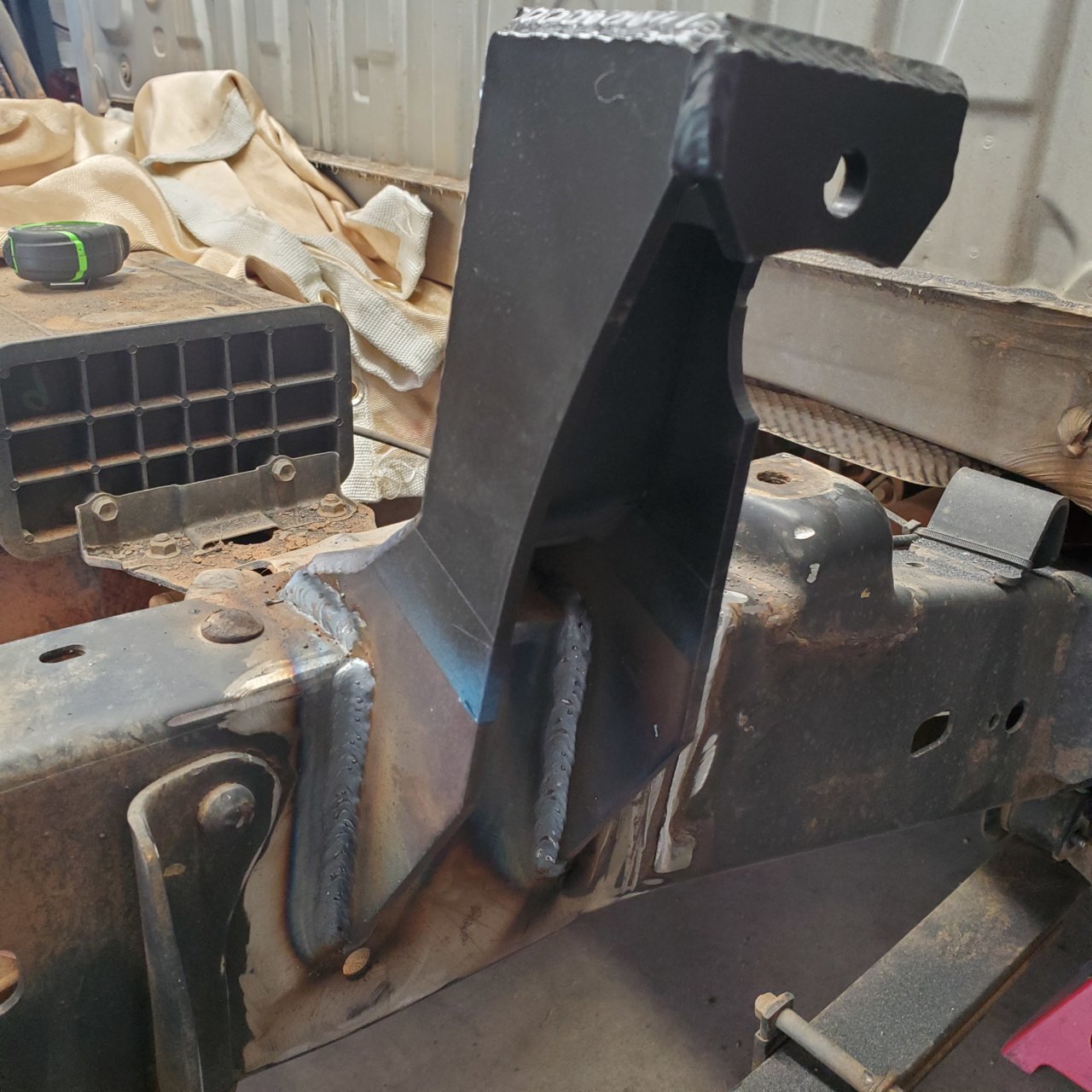

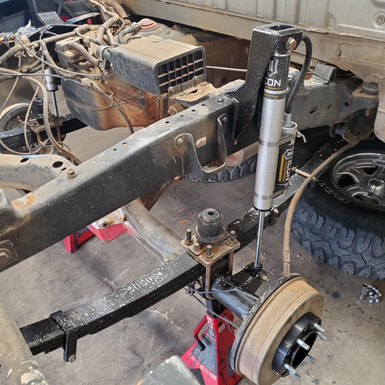

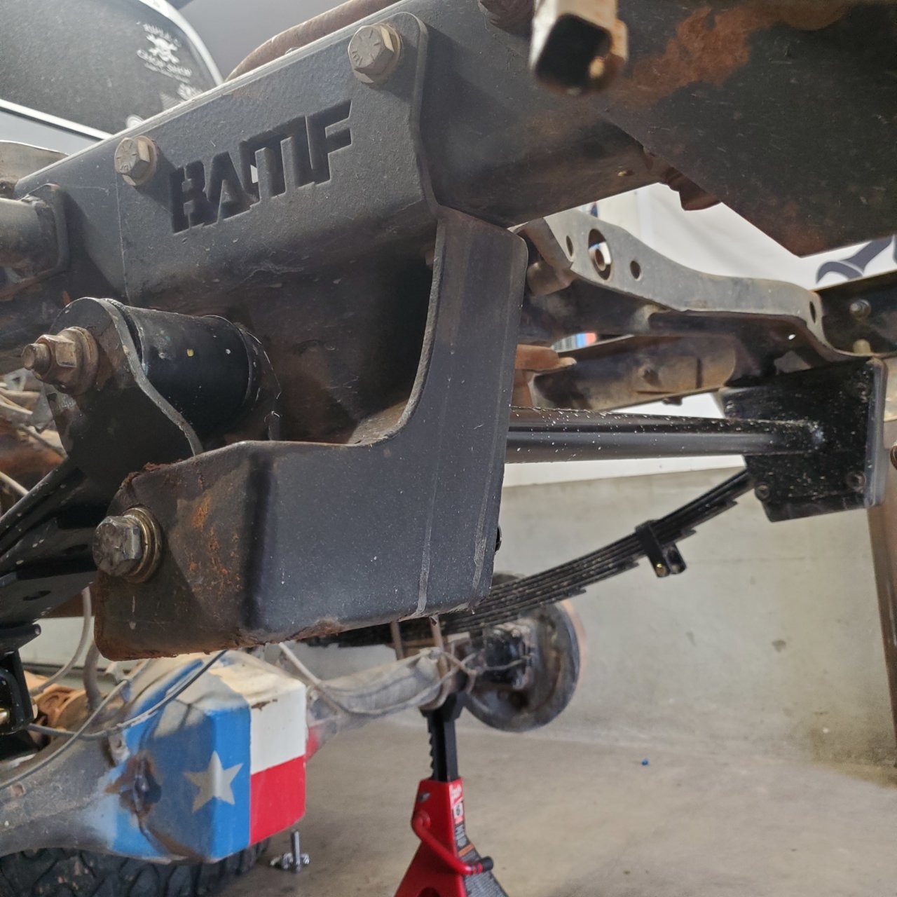

    Didn't have time to box the frame, but got the BAMF shock relocation kit w/ Icon 13" reservoir shocks and BAMF shackle hangar cross bar in. Also had to put on some Bora 1" wheel spacers to keep the tires from rubbing on the shocks at full flex. Flex pics to come later.20210522_150529.jpg 20210522_150538.jpg 20210522_150550.jpg 20210523_091129.jpg 20210523_091144.jpg 20210523_091158.jpg 20210523_091210.jpg 20210523_091225.jpg

    It rides way different now, more solid

    The hammer hangers with the crossbar made a huge difference for my truck as well

    I'm still getting used to the feel of the cross bar. I didn't realize that the frame flexed so much daily driving

    Its even more apparent when there is a huge bed rack and tent or GFC on the back. This was a great upgrade and one I think most tacomas should go for

    And from the scrapes on em, I would have bent the factory hangars by now

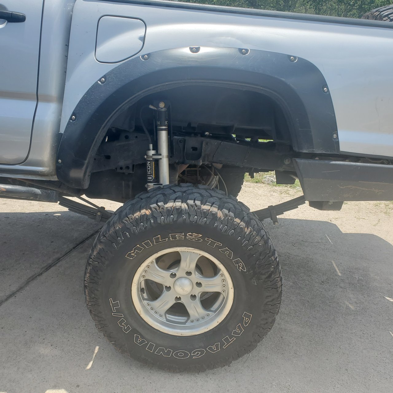

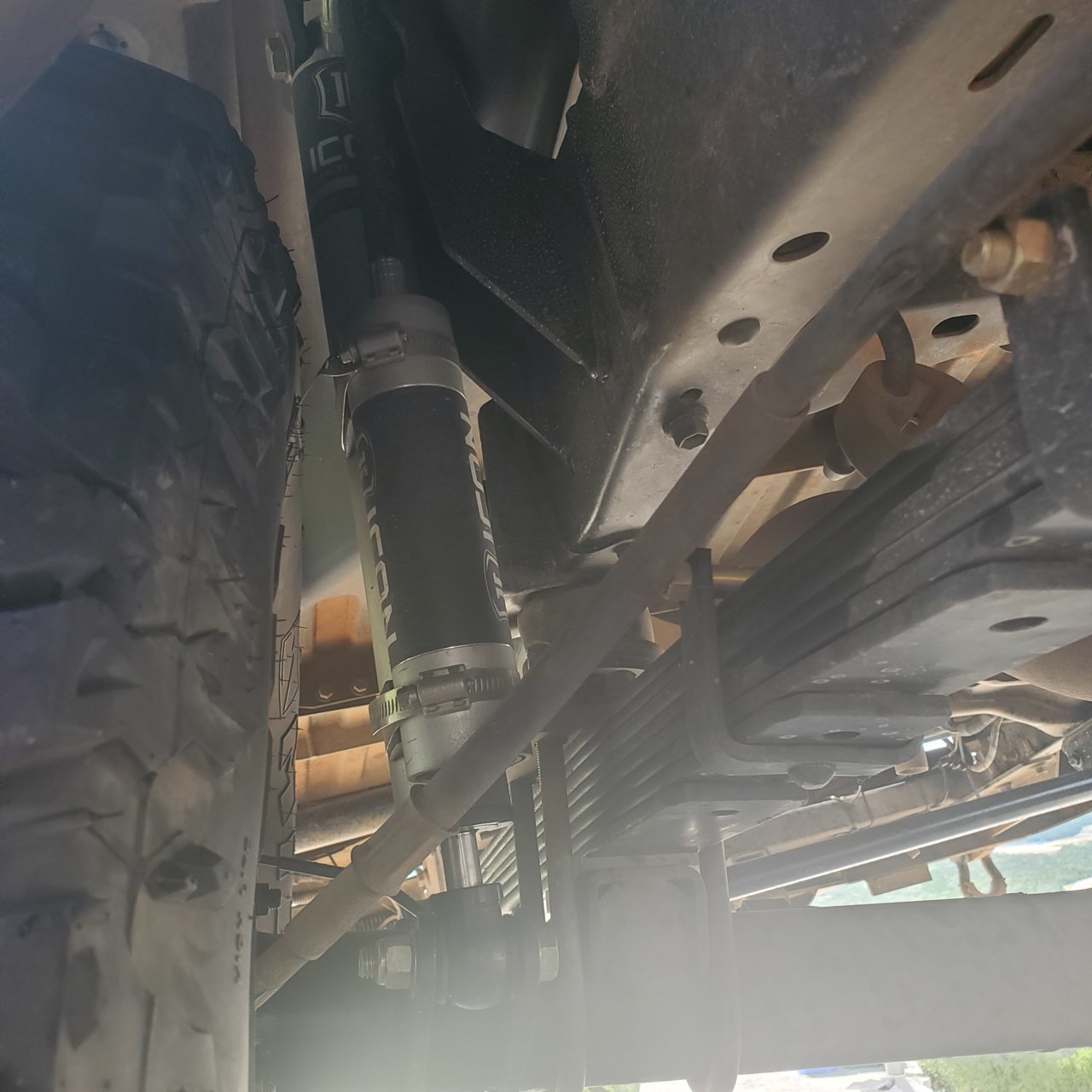

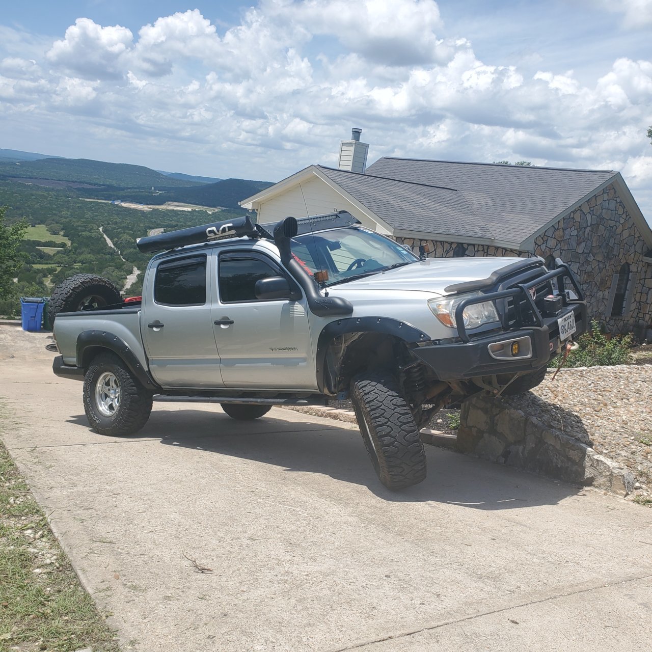

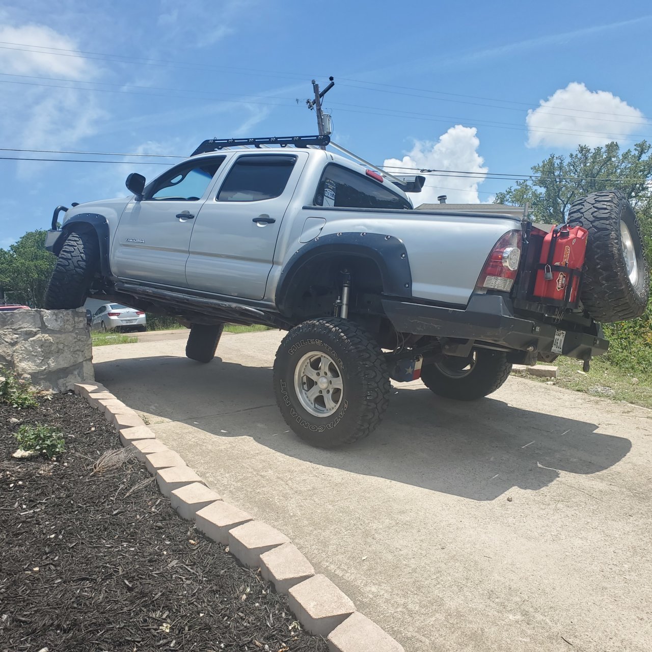

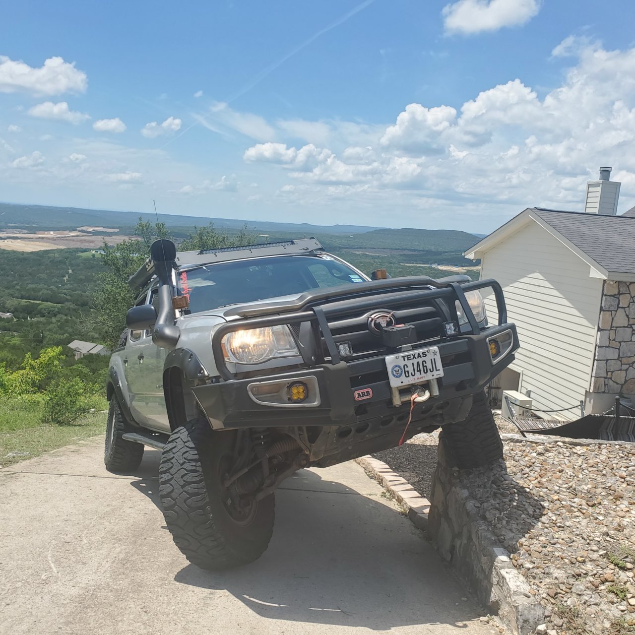

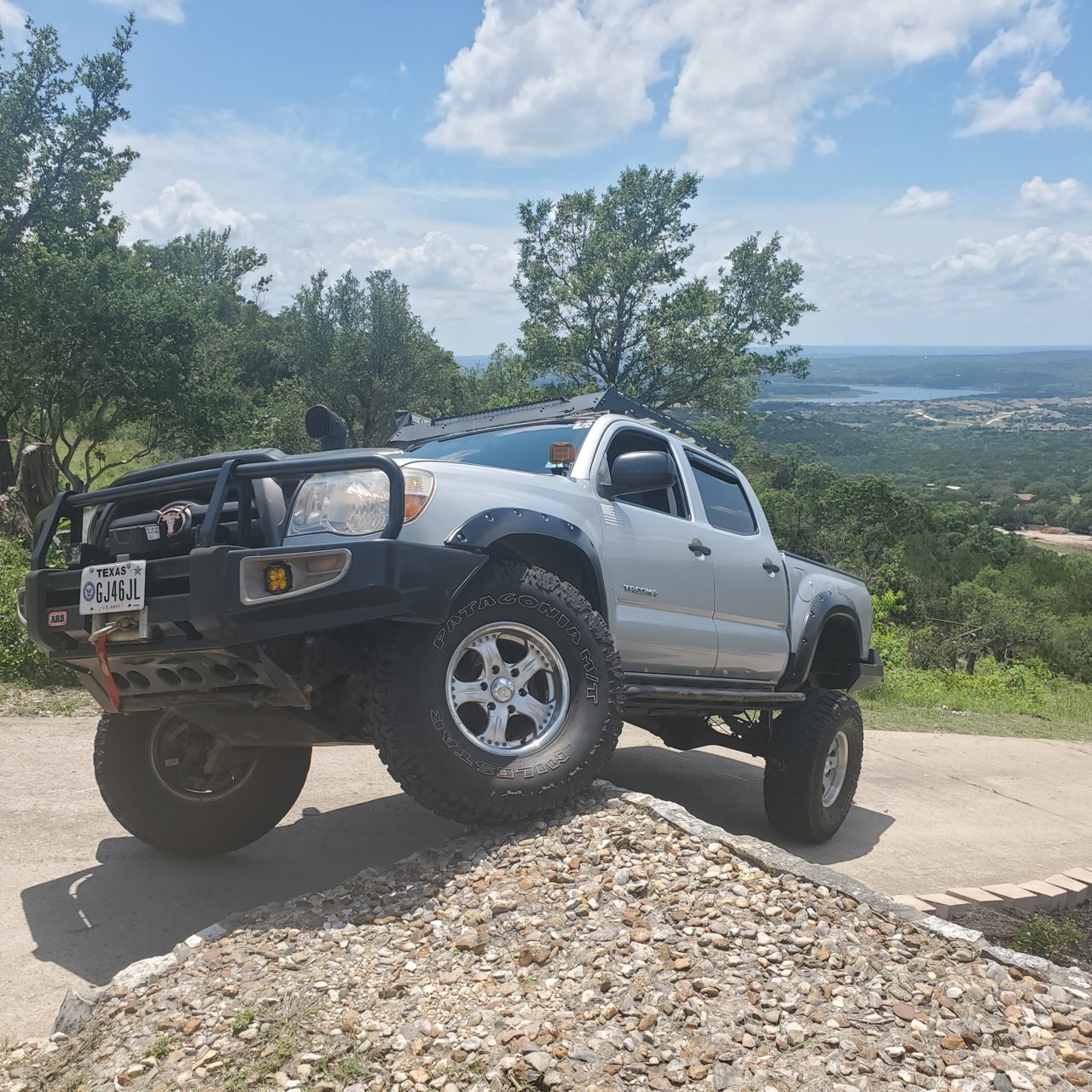

    Finally got to flex the ole brick out. Ran out of room on the ledge and had more travel to go as well. Makes those 35's looks small.
