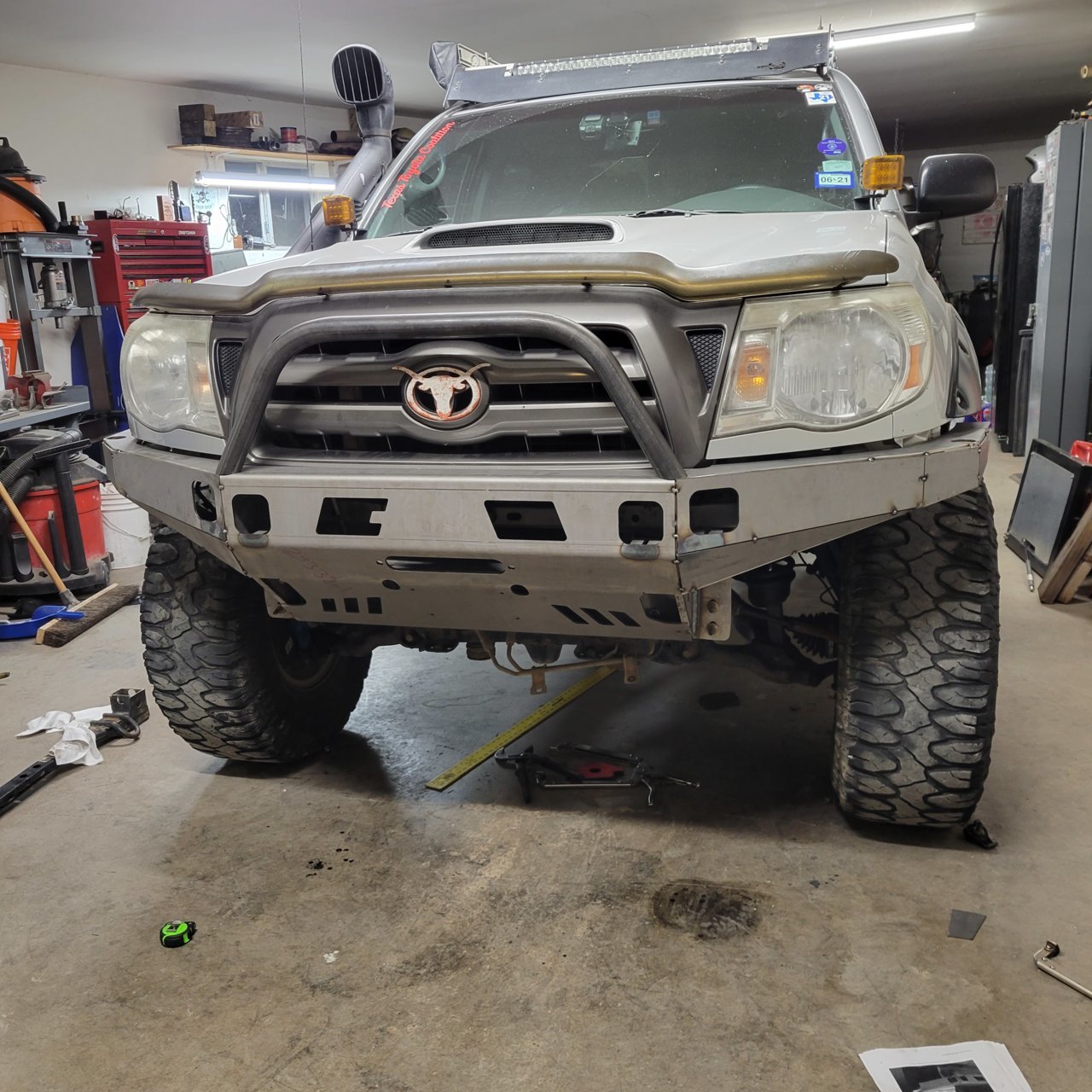

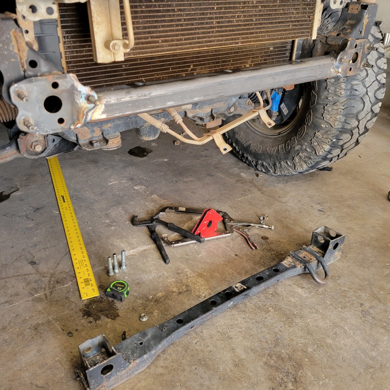

    Bottom cross member cut out. New cross member welded in. Now working on the main structure of the bumper.

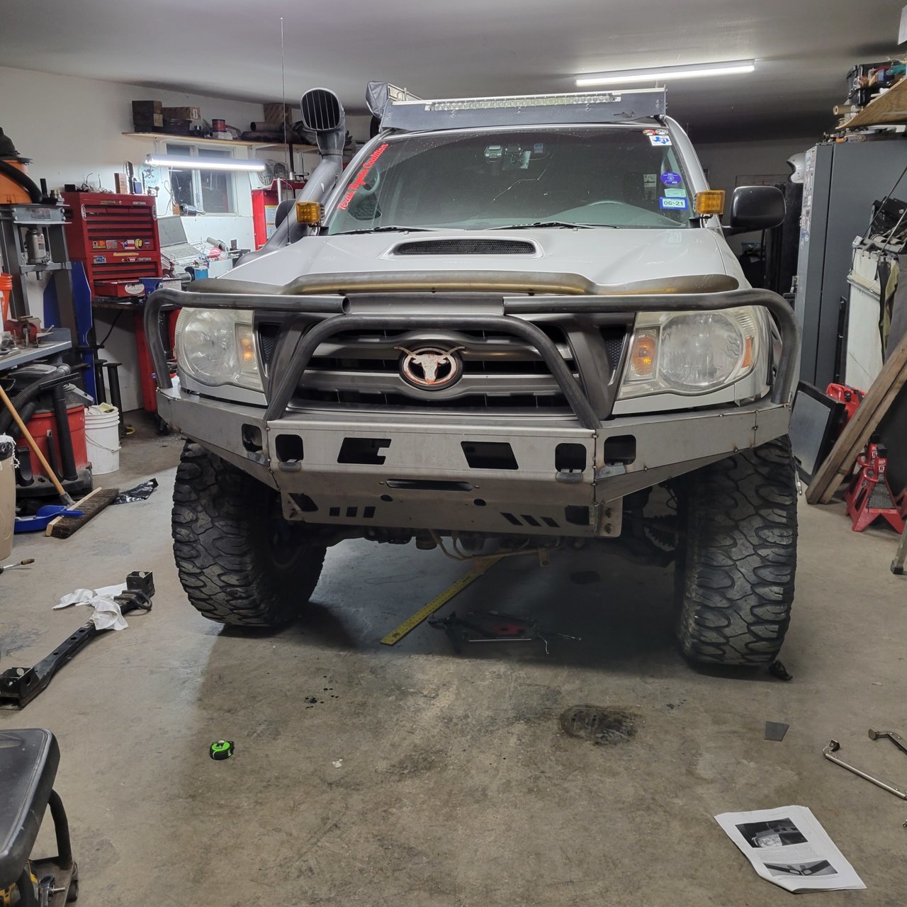

    Center structure completely welded, wings are tacked, now deciding on if I want head light hoops or only center hoop. Opinions?

    Full hoops so the bug catcher don’t look like a unibrow on the hood.

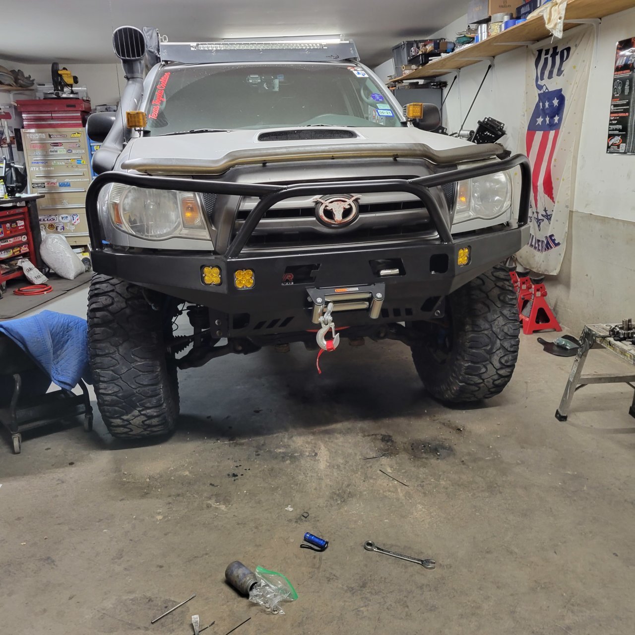

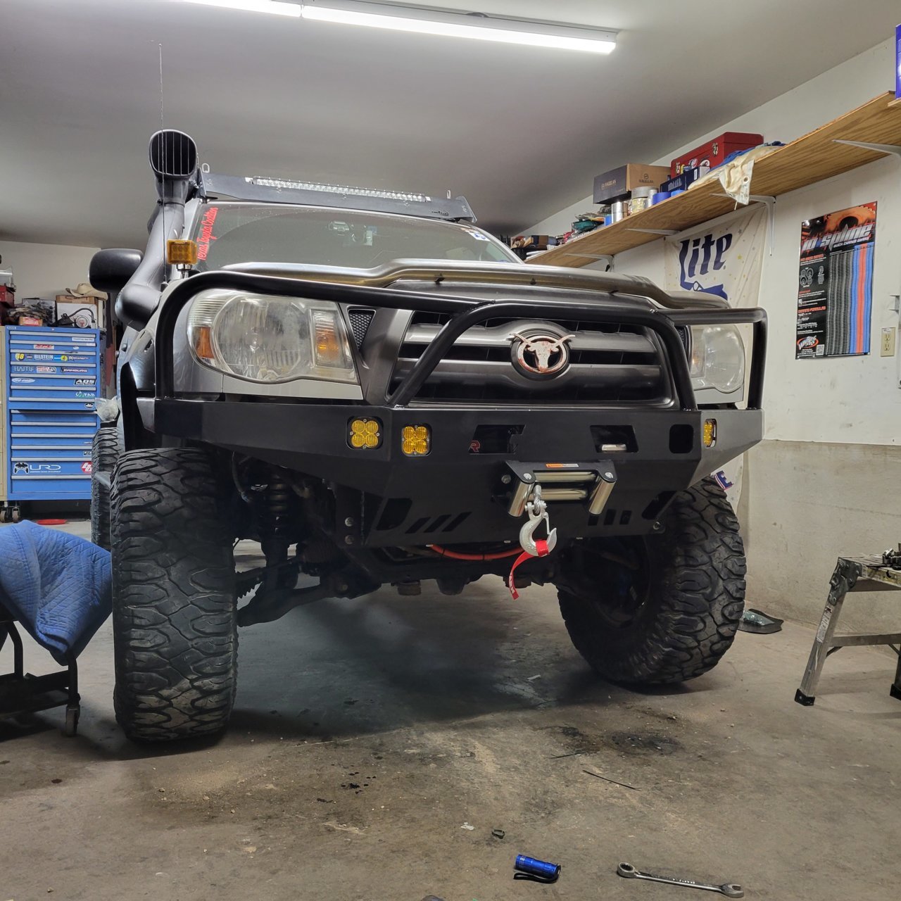

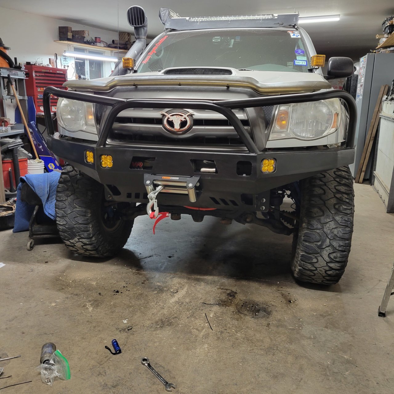

    Finally, winch was a tight fit. Had to remove the grill support bracket, bend the center bracket back, and cut the nub off the grill. Then the lights were contacting headlight brackets so have to bend them. Still gotta figure out mounting the winch controller, and finish the wiring.

    And one light didn't come with a mounting bracket for some reason. So have to wait on that.

    Made a bracket for the winch controller to fit behind the grill, it's stuffed in there good. Truck is all back together. Solid motor mounts are pretty nice, truck has the feeling of being more torquey.
