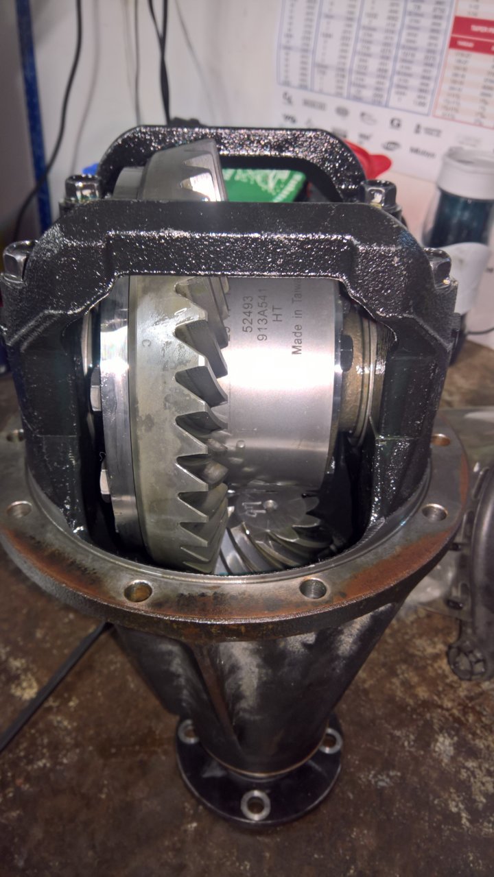

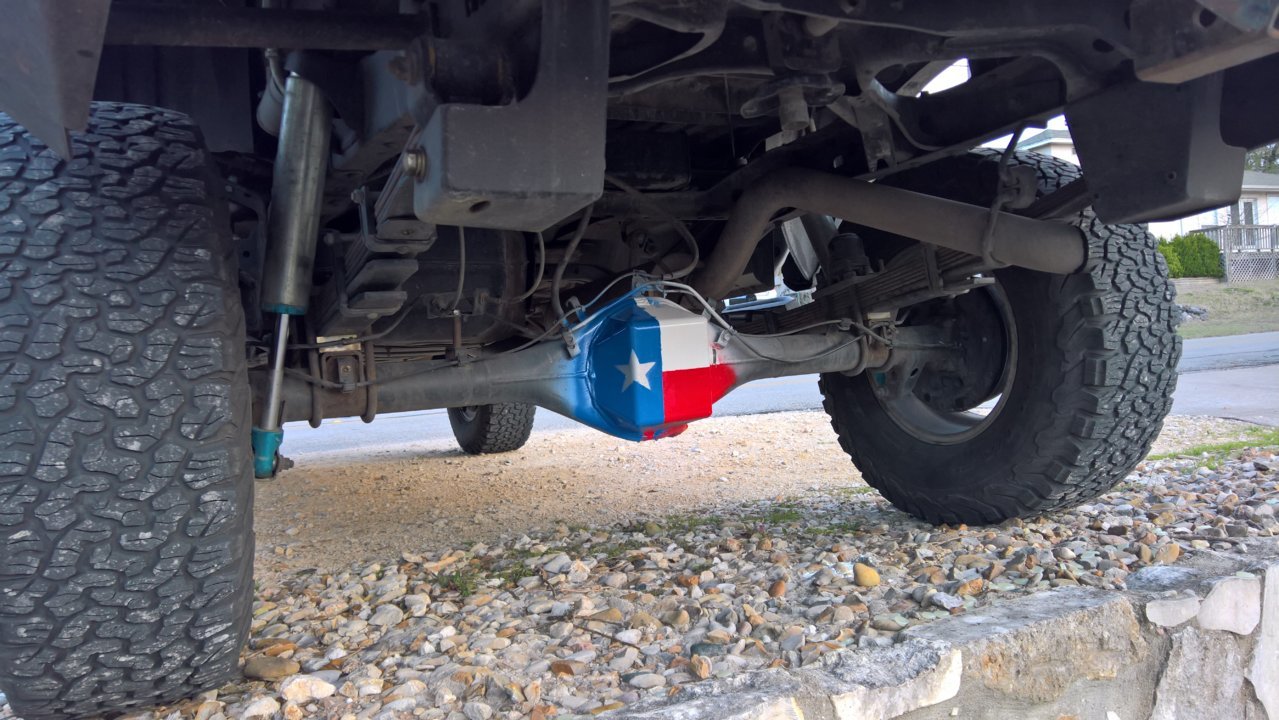

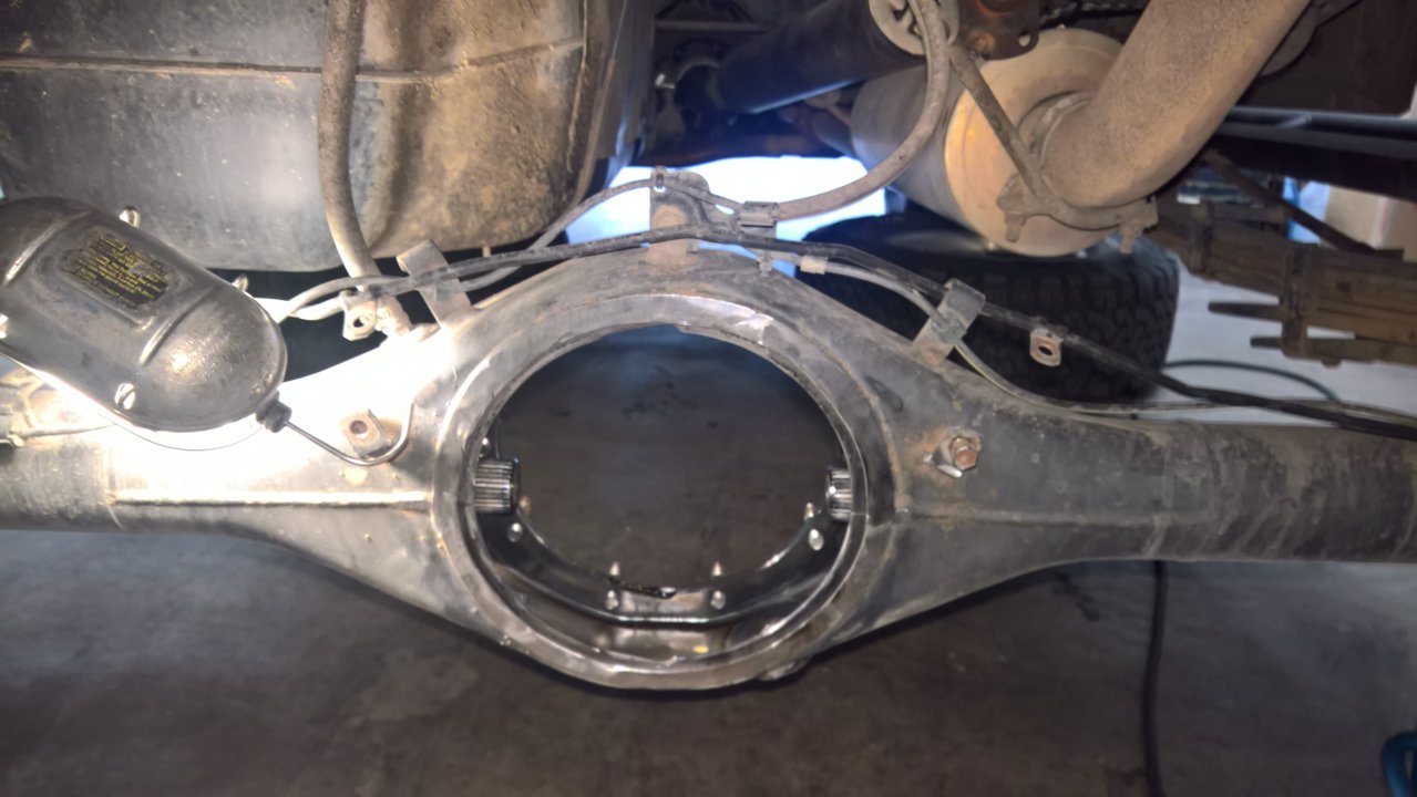

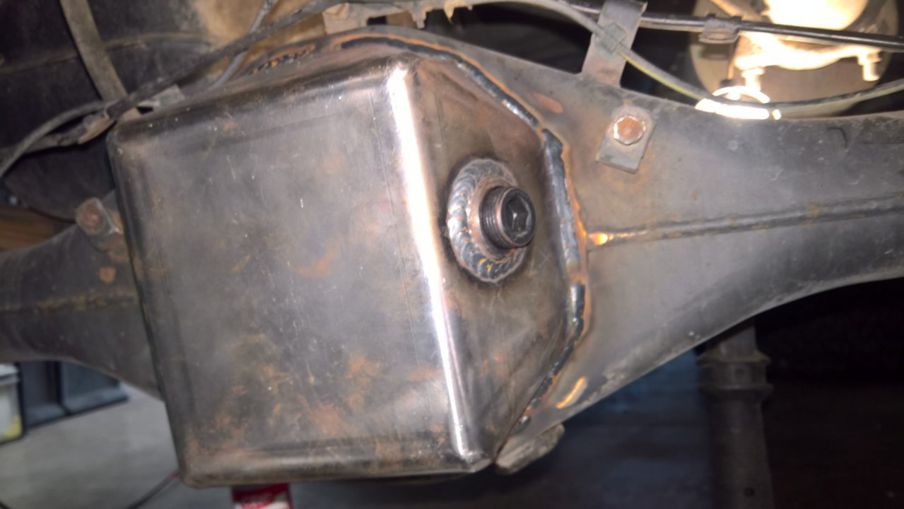

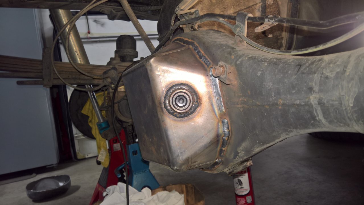

    Right before the last CnC. It's a Barnes 4wd diff plate w/ 1/4" steel. The stock back is super thin. Also went from 3qt fluid capacity to 6qt.

    Thanks brocephus. While I had the rear out I did a check up on it since it's been a year since regear. Everything looked good, I tightened up the preload a bit with the solid pinion spacer. Now I'm sure the rear is solid.
