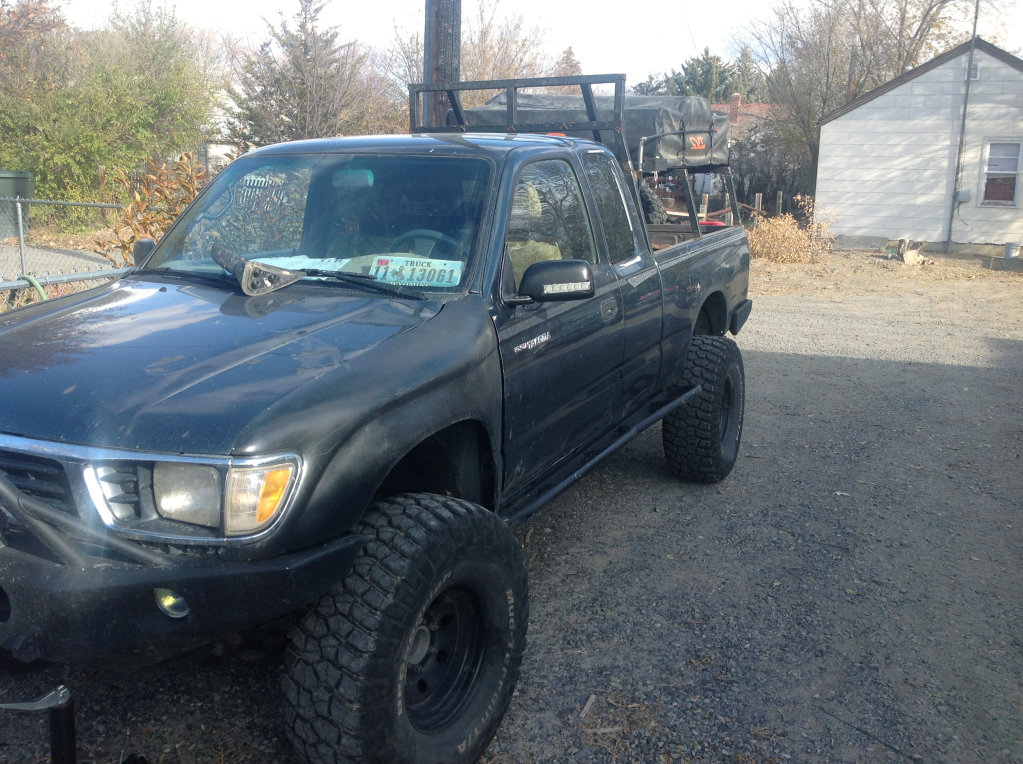

    Well the lights are only 18w..so I'd guess there was only 3-4amps. Was a 20a I think..or 25 fuse. Melted the wires tho and melted switch. Shit got real pretty quick.
    I didn't take pics of that. Was too mad haha
    I do have TONs of pics on the mirrors though and one with the light on...well the driver side on.

    Looks good!
    How many lights is that now?

    Uhhhhh...not sure haha

    -2 for crap sealed beam headlights:cool:

    :smack:
    My 8 other(soon to be 12) front facing lights make up for that!!!
    Tho yes some new head lights are on the list...
