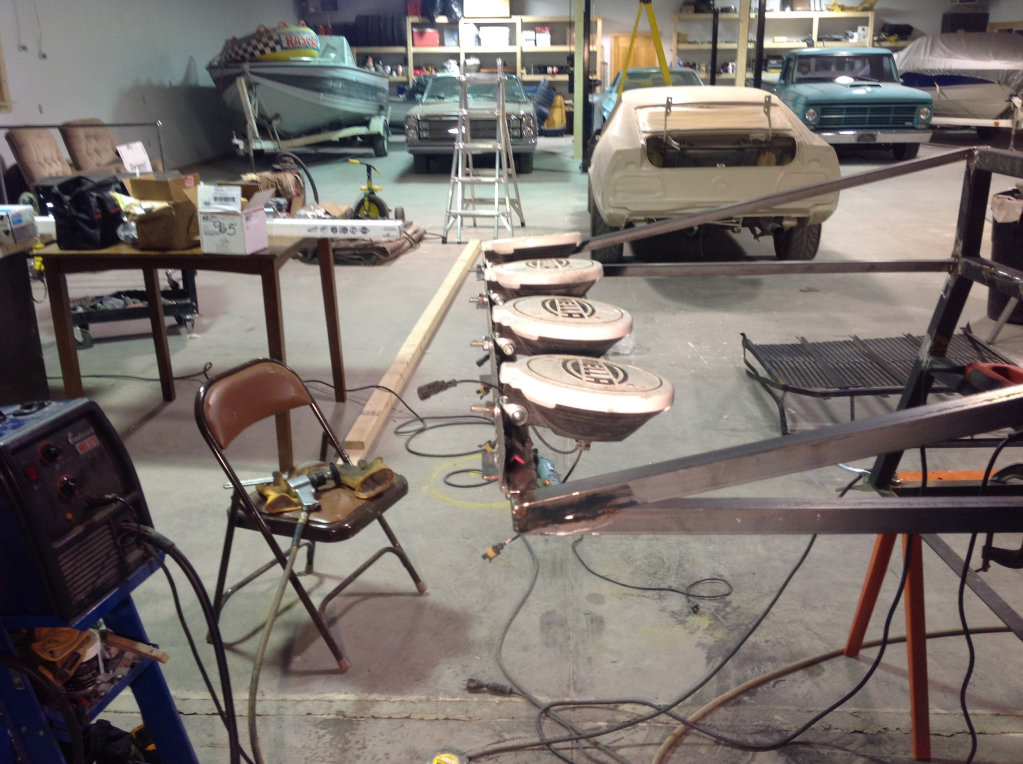

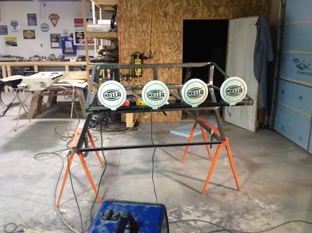

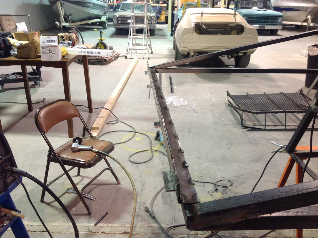

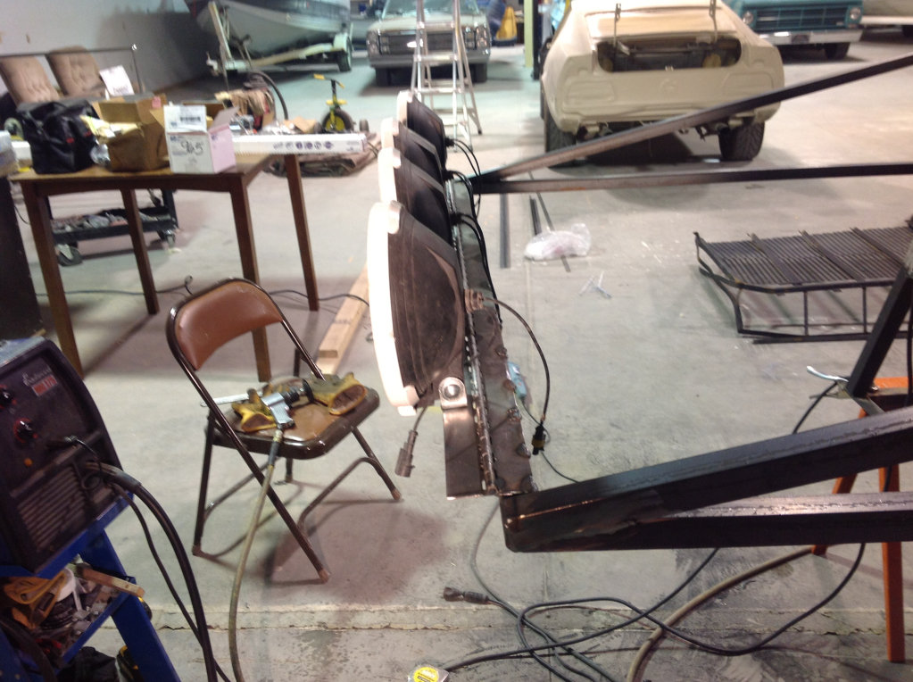

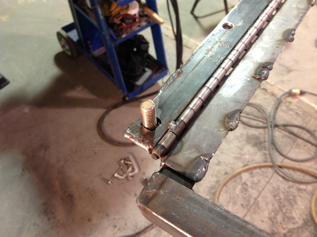

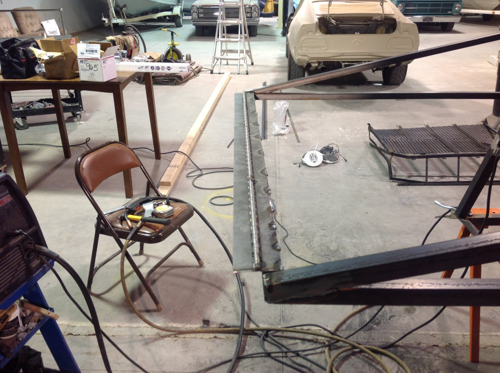

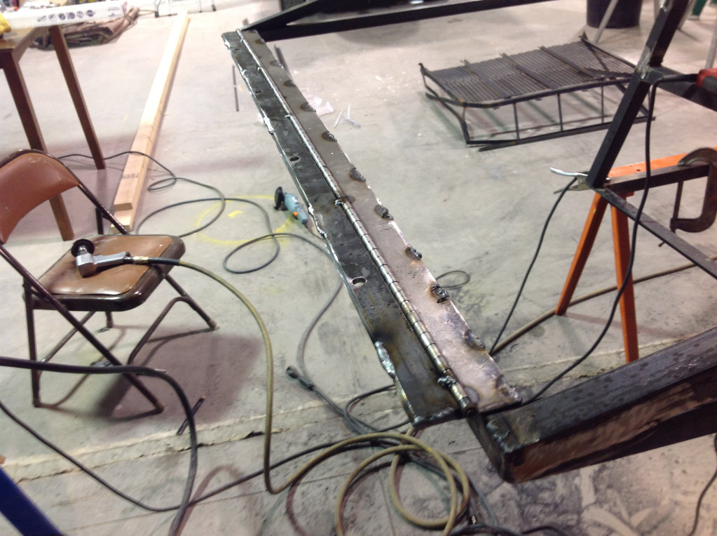

    Folding light mount..
    This is a piano hinge. 3/16ths by 2.5"(total open width) turned out perfect for sitting on 1" angle iron
    Pieces of angle iron to hold it up flat(total of 4 only 2 are on in this pic till light holes are drilled)
    Light holes drilled and lights just tossed on for filament check
    Folded down
    Works great! My 6" HID hella 500s now have a slimmer profile then any LED bar :D and are brighter :cool:

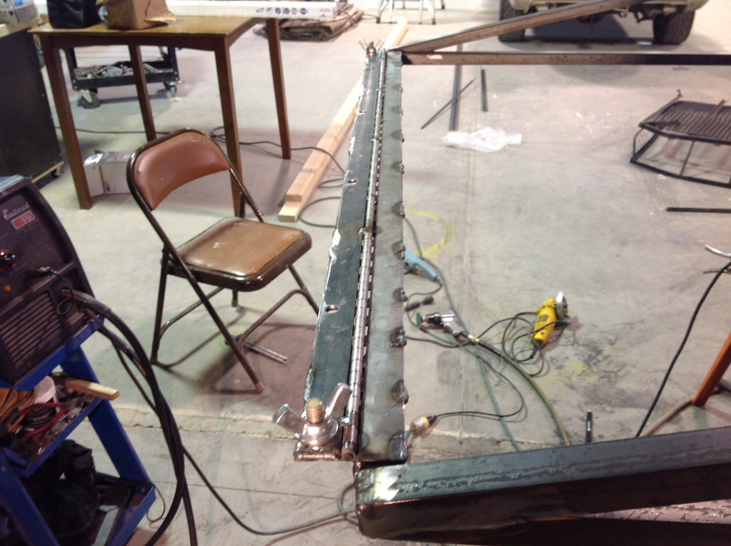

    However it was a bit flimsy for my taste. Just to much give in the hinge as it was really thin. The actual metal on the hinge was probably 1/16". No problem! I grabbed some 1/8" thick 1" strap and clamped it on, drilled the same holes then spot welded it on. MUCH better.
    And that's where I called it a night.
    Tomorrow ill put the light hoop on and the flooring of the rack in hopefully if turkey day does take it all out of me ha
    I do have a plan for securing the lights in the up and down position..but you'll just have to wait a see..

    Michael J Fox do all your welding? :brianr:
    Just giving you grief, looks good Monte! Happy Thanksgiving.

    Lol yea that thing was hard to weld on. Why I stich welded it :p no my best welds..but they will hold

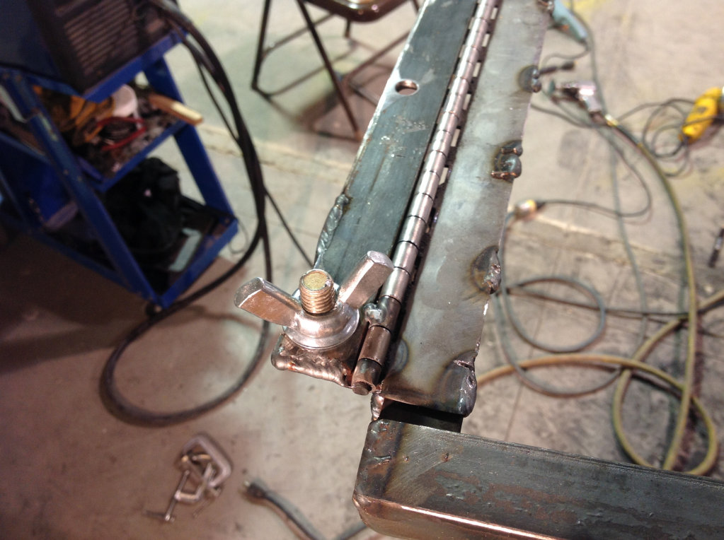

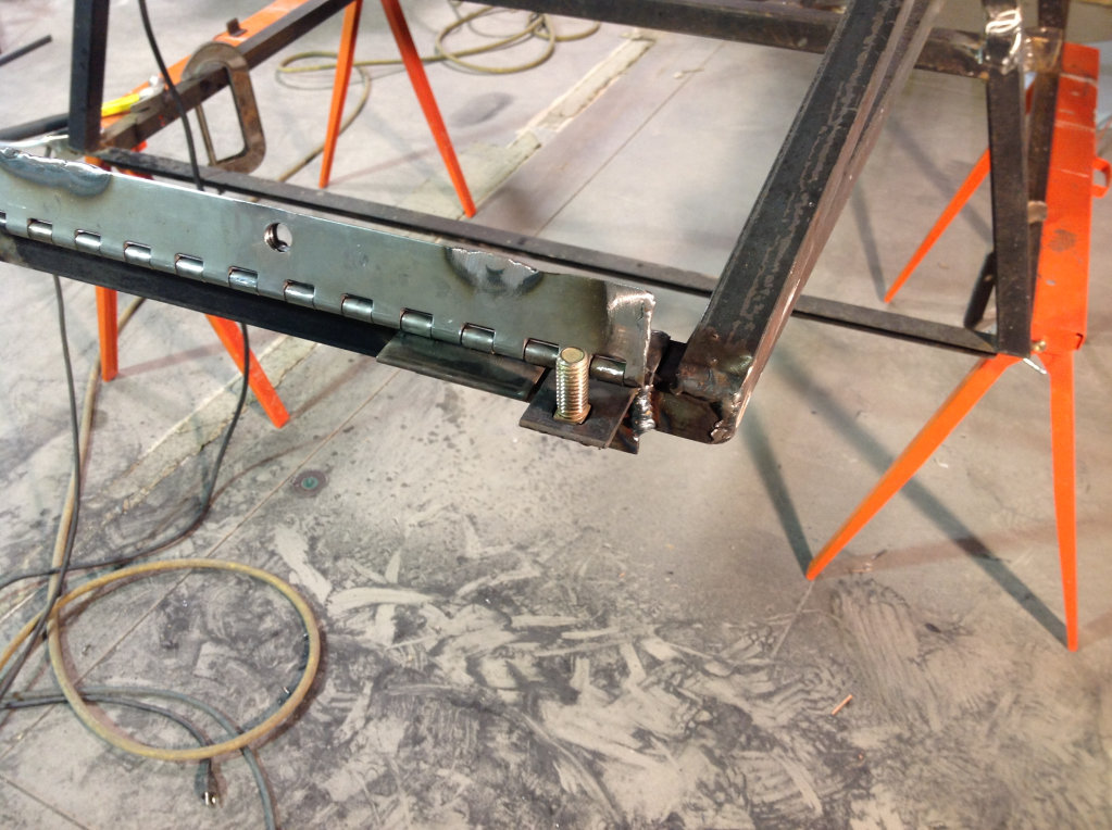

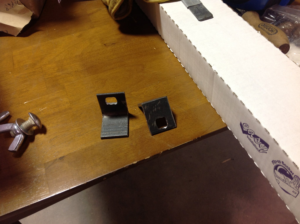

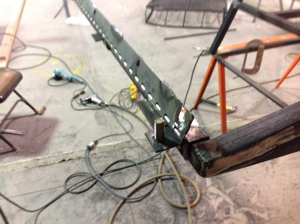

    Ahh another nice day..
    Made my hold downs for the hinge today. Not perfect but it works pretty well
    I used 1.5" angle I had left to make these
    Welded on
    Cut notches in the hinge
    Then just a wing nut and washer. Gotta go get a lock nut too..
    Works pretty well. One on each end. Yes the wing nuts are too large to go on the bolts when the lights are down. But really the only time they will be down is for hwy driving. So I'm not super worried yet. Plus hinge is pretty stiff now.

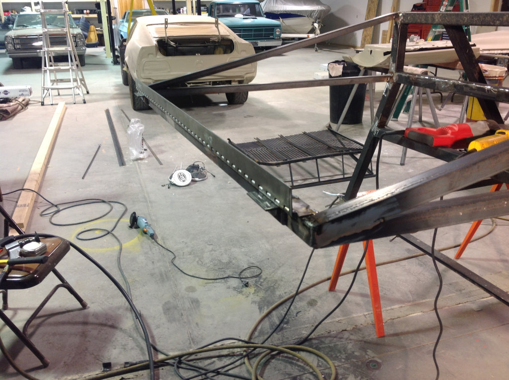

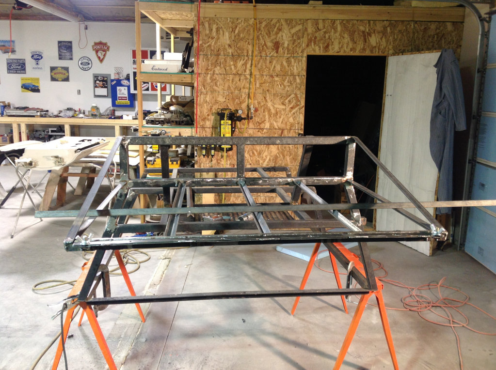

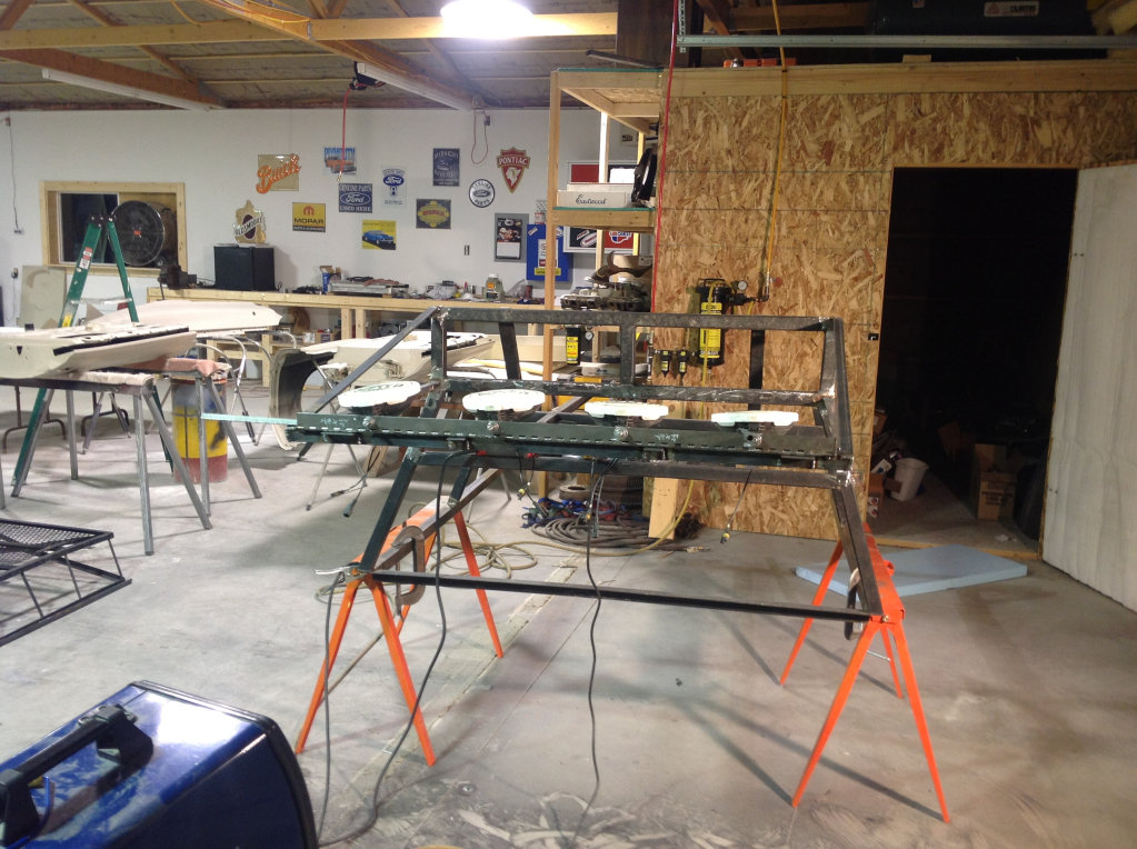

    And now to rest of the rack.
    Put the other beams in. Nice and flat :cool:
    And now I have to get the mesh off my old one to put on hopefully. And then fab up the light hoop and it'll be ready for paint then pre wiring.
