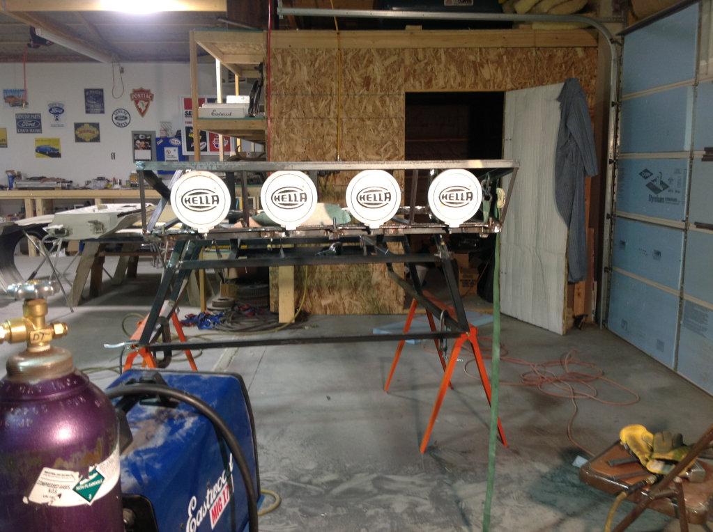

    Getting closer..
    Center bolt in
    Helped a TON. lights a rock solid now.
    Light hoop almost done. Got tire and came home. If I don't work tomorrow ill finish it for sure

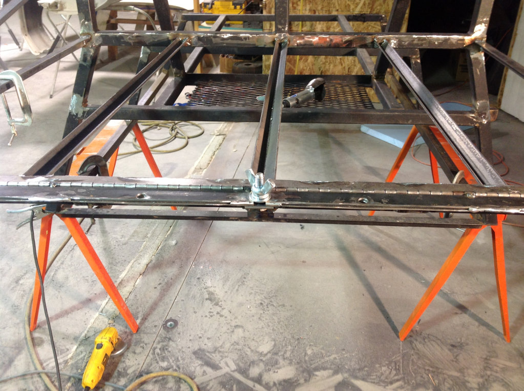

    The more I get this done the more I love the folding lights. Works awesome. Going to be very handy.

    Thats just how I was thinking with the hoop, looks awesome.

    how do the lights stay down?
    Looks awesome by the way!

    The hinge is just stiff. And the weight if them for now. However I have a roof rack tie down thing ill use when it's all done.
    But again ill have them up most the time. Only time they will be down is when I know ill be going on the high way. So they should be fine I'd think. But I'll have the tie downs anyways just in case.

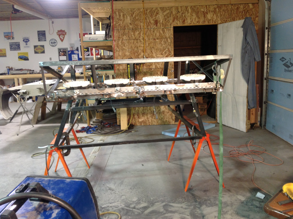

    Looking good buddy!
    But why did you run the angle iron upside down?? Its just going to collect snow and water now..

    I have been waiting for someone to ask that.
    I basically made this rack exactly upside down from my last on. Last time I had it so the point was facing up. Amd the outer rails had the flat side down. I reversed it for the simple reason of more surface for the grating to sit on, making it mor safe.
    Wage and snow are going to be avoid by a few small holes drilled in the rails :)

    ok, cool. You could have also run the angle iron on its side so you have a flat surface for the expanded metal to sit on

    Yea I thought of that. But the symmetry would be off :anonymous: that's a sad excuse but my OCD I guess..
