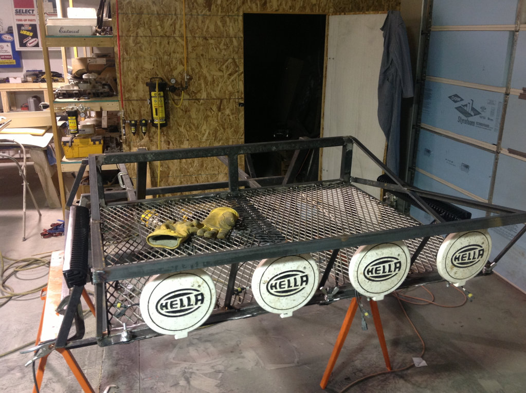

    Rack..is..DONE!! Well..welding anyways.
    Hopefully ill get it moved over tomorrow for paint. And a test fit. Should be cool
