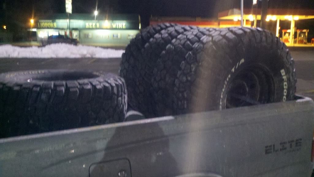

    33x12.5s here we come!! Woot!! :goingcrazy:

    Oh, right on man!! I bet you're dying to get those on!! Gonna look great!
    Can't tell in the pic if those are six luggers, but going to use those same rims assuming they fit?
    Be sure to post plenty of pics! :cool:

    Yes they are Wheelers Type B rims. Means i could get new brake calibers too lol But i need to use them as my stock rims are only 7'' wide and i need a minimum of 8'' wide rim for 12.5'' wide tires.
    But yes..i am DYING to see these on my truck! I will take TONS of photos lol
    could also be a filiment issue as i have 1.5'' spacers and the rims are 4'' of BS..so id have 2.5'' of BS lol so i might have to get smaller spacers haha but we shall see :cool:

    That's exactly what my backspace is, lol. The Pro Comp rims are 4" with the 1.5" Spidertrax spacers. I'd leave 'em on, nice stance! :cool:

    Oh really?? Sweet that gives me hope! :D did ya have to do a lot of trimming??
    Then again..you do have like 11.5'' wide tires and mine are 12.5..

    Had to do the pinchweld and lot's of trimming, yes. Depends on the way you look at it, but worth it imo.

    Nice tires! Are you getting them on today? And those are going to give you a nice wide stance too.
