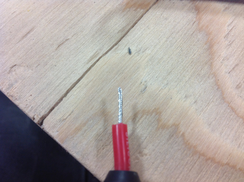

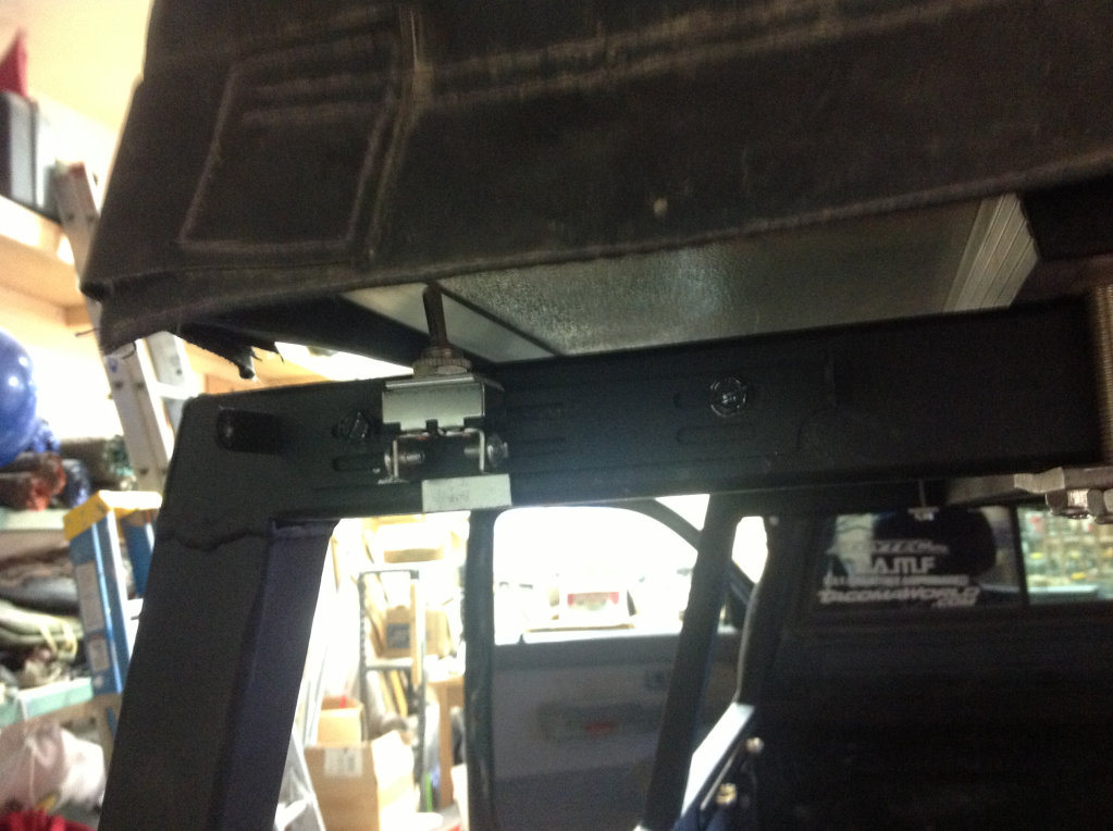

    Okay build update time..
    Made a cool switch location for my future bed lights.
    Used some left over Aluminum from the switch pannel.
    drilled a hole for the toggle switch.
    then i used a dremel to cut a small guide line for where i want to bend it.
    bent
    Switch!

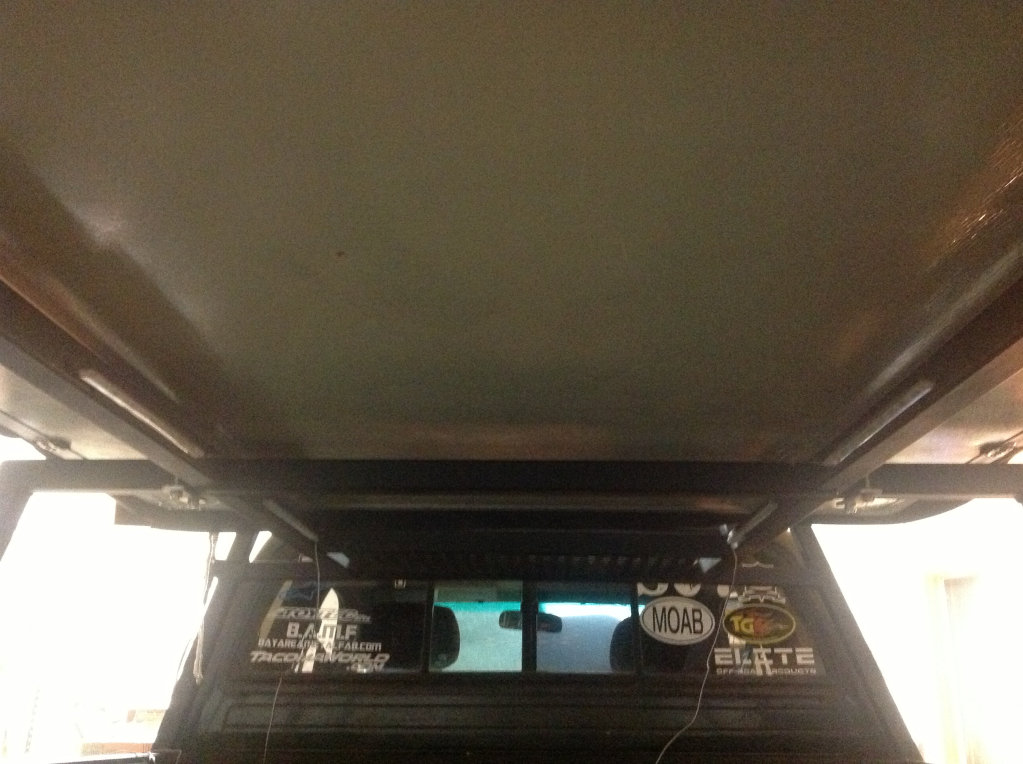

    I put this right behind the bracket that hold one of my rear facing LED bars. I just put it in between the bracket. Its nice and sung and up out of the way..

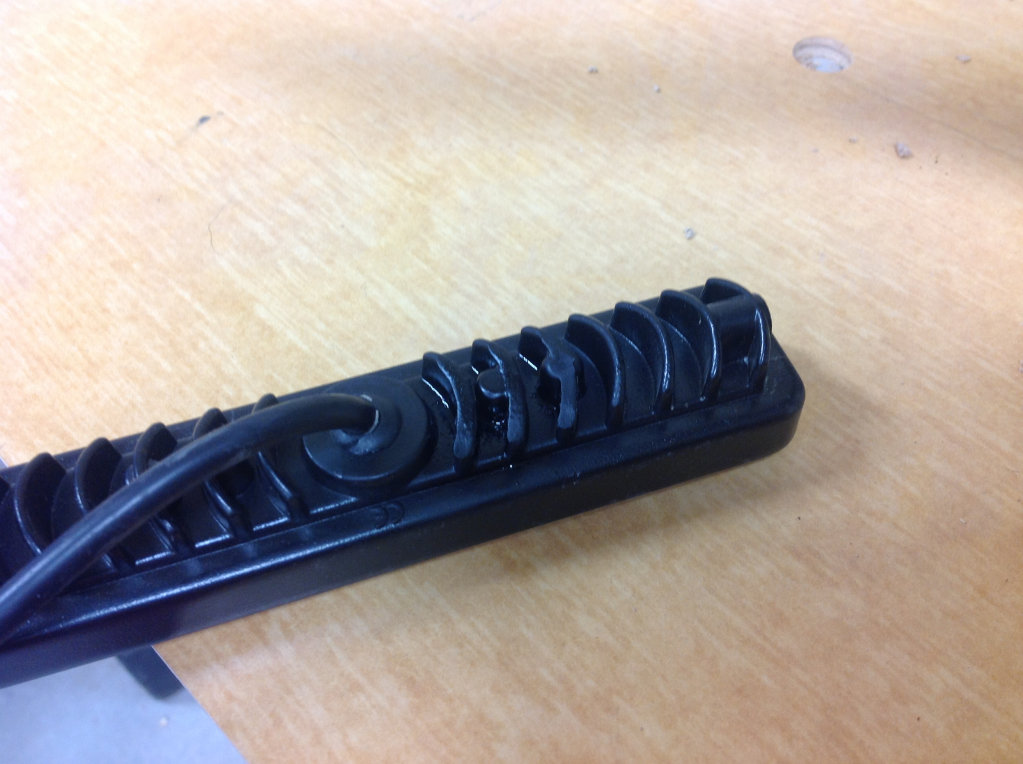

    However the switch did contact the heat fins on the light..not a problem :cool:
    just grind em off a bit :D
    slap some paint on it and good to go
    nice and hidden yet very easy to access. I just run my finger up there and can easily turn it on and off. The RTT tarp keeps it hiddenish though so it won't be super obvious. and out of the water. I like it!

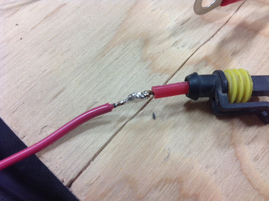

    BTW. This is how i do wiring. How it should be done.
    quick connects are for losers :D haha

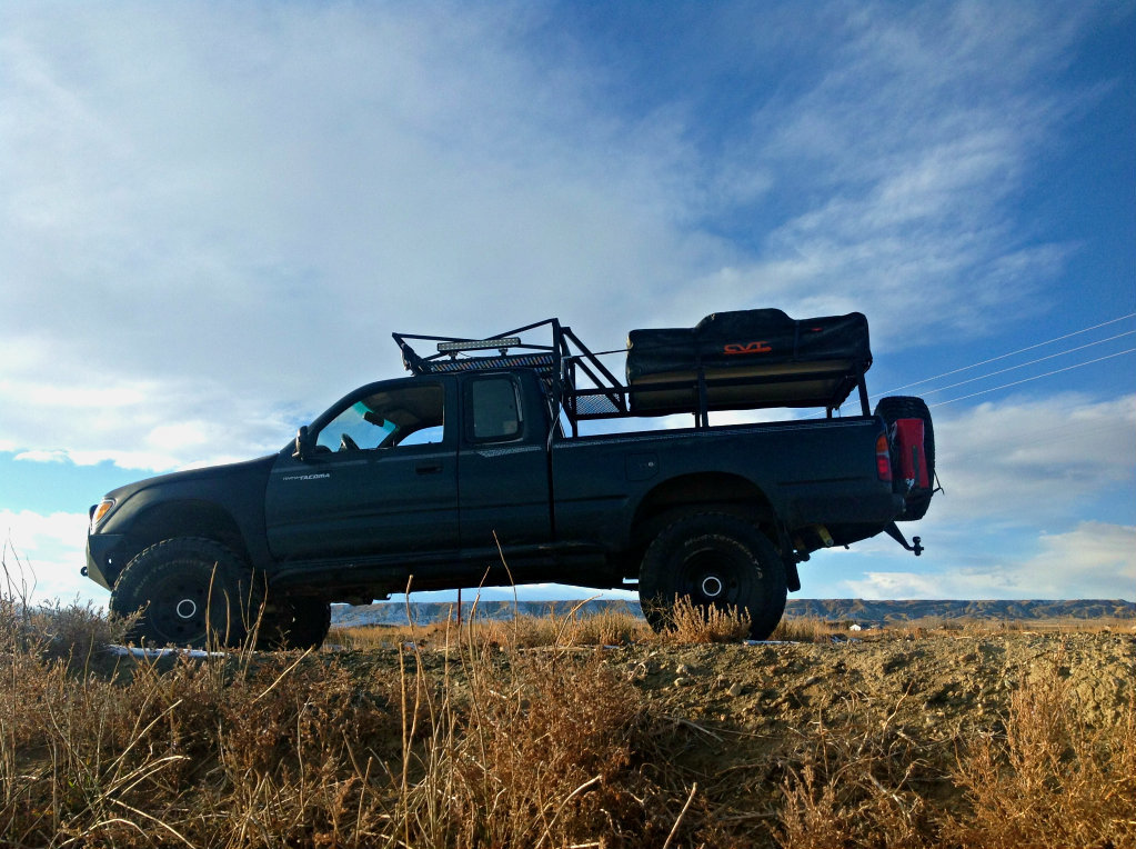

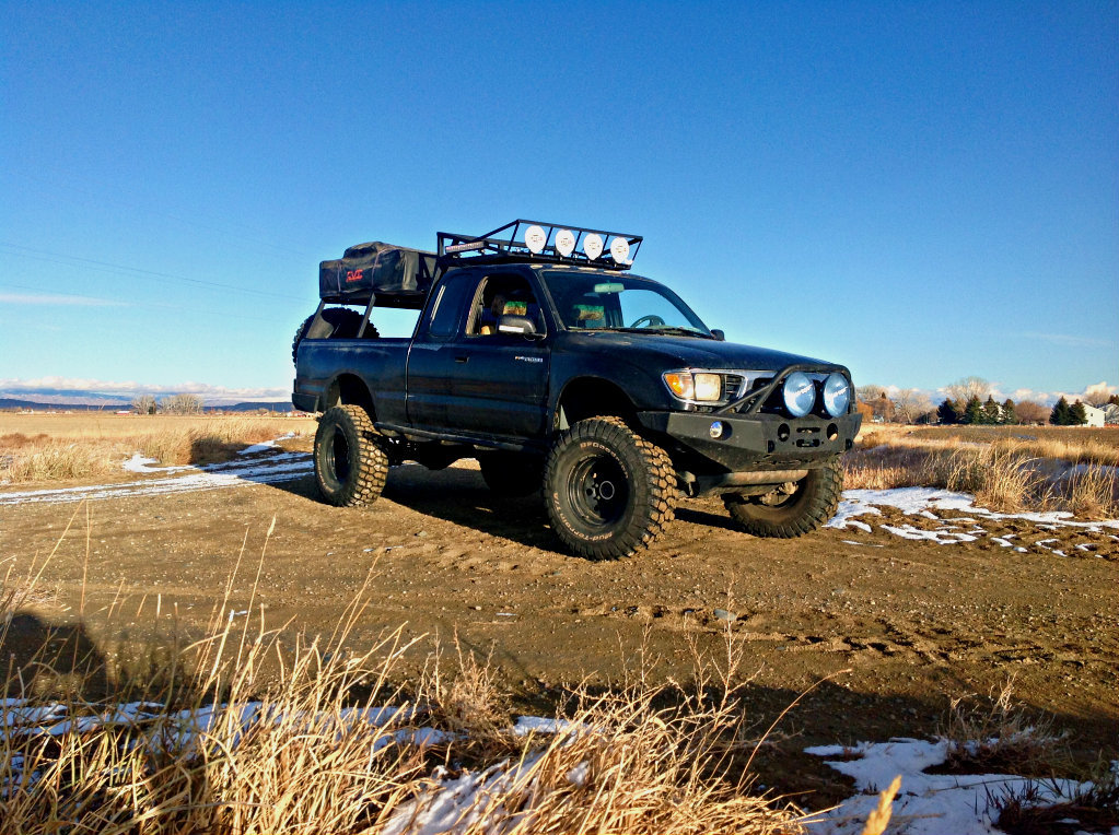

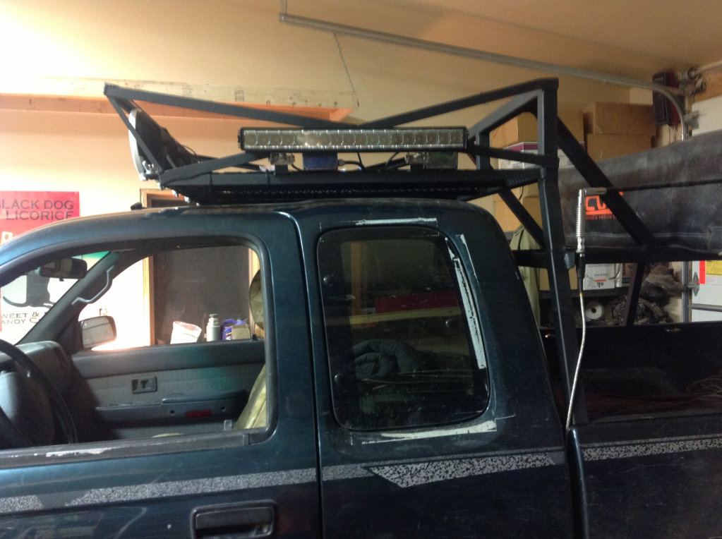

    oh..and truck porn of the rack!! I like it :) can't wait for the lights to work.

    you gonna post a picture tonight with everything lit up? That rack looks great on the truck man

    No :eek: not even half way done with wiring haha I just wanted to see it in the day light haha
    Thanks man tho!
    Gonna be a bit till night shots

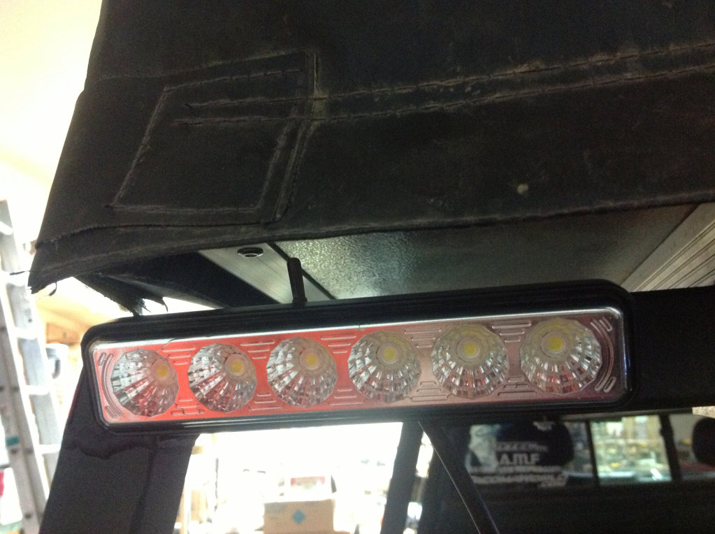

    Got my ballasts all mounts and the wires to the lights extended and attached. Everything turned out great I think. Nice a clean and tucked. My thumbs hurt tho from twisting all the stupid wire ha
    Anyways this is where I put the ballasts.
    Then go the bed light ready. Holy crap I should have installed these sooner. They are awesome and will be a HUGE help when setting up camp at dust or night.
    Got some silicon. As I was told to do in DrunknSloths write up to seal e bars and the ends.
    Then just stuck em up there on my pre welded 1/4" angle iron
    These are the "warm" light bars that DrunknSloth sells. But honestly I don't find then warm. Yes they aren't pure white like everyone love their lights. I'd call them more natural light. Not super yellow or super white. Just nice even natural looking light. Floods the full bed lovely. Can't wait to get them hard wired into my switch.

    Those would've been nice when we were searching for tools that night we were working on my truck in lander haha.
    Any concern those LED bars on the roof rack can take hits from tree branches?
  20. Dec 8, 2012 at 9:07 PM
    #2440
    Blackdawg
    Blackdawg [OP] Dr. Frankenstein
    Dec 31, 2010
    #48500
    81,649
    Monte
    Wyoming/St. Louis
    The Trifecta of Taco's
    Ha! No kidding and the rear facing ones haha
    No I'm not concerned. They seem plenty stout.
