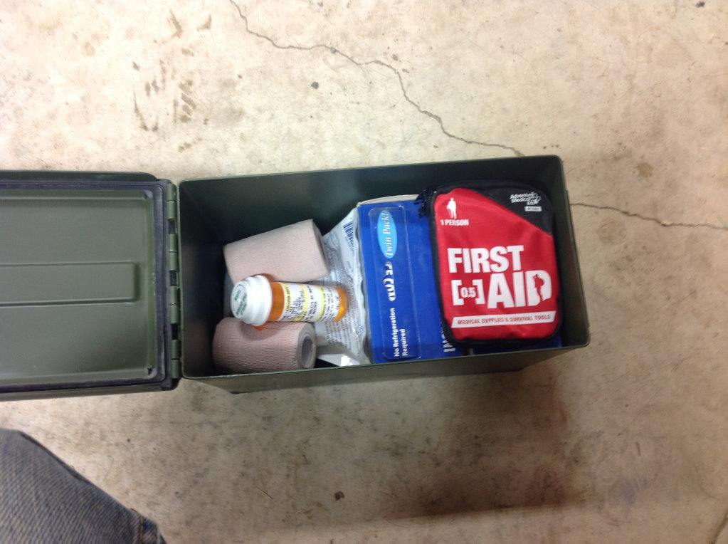

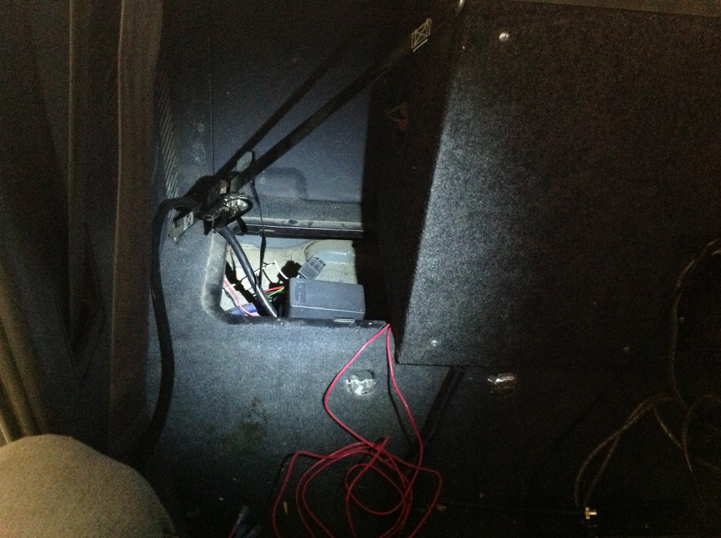

    Ok so more build less BS.

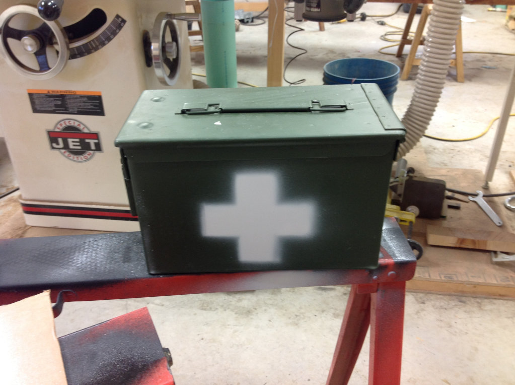

    Started putting together a first aid kit

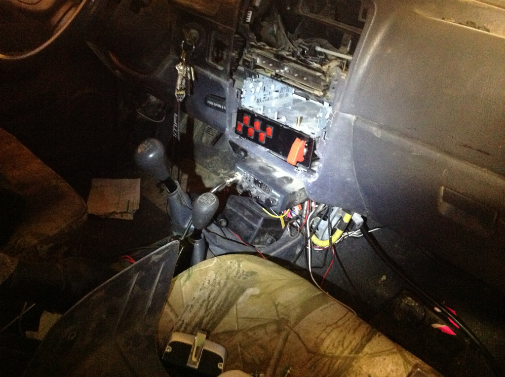

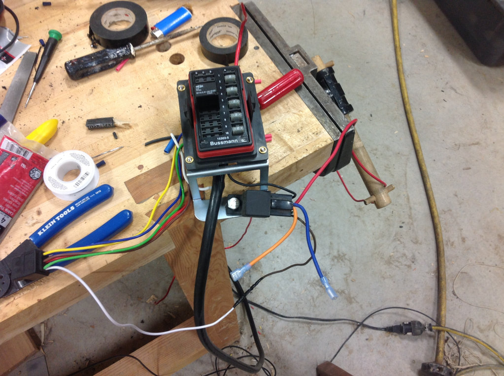

    Got holes drilled for bolts and the bussman box mounted.

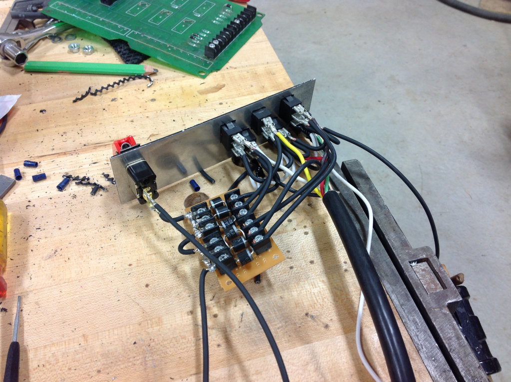

    And switch panel is done with wires. Going to test fit it later and cut the main wire to size. Then just have to solder on the disconnect. From there it's just getting power wires run to lights!

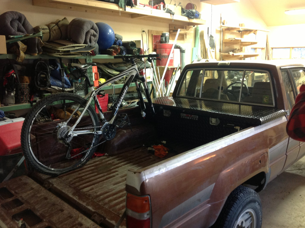

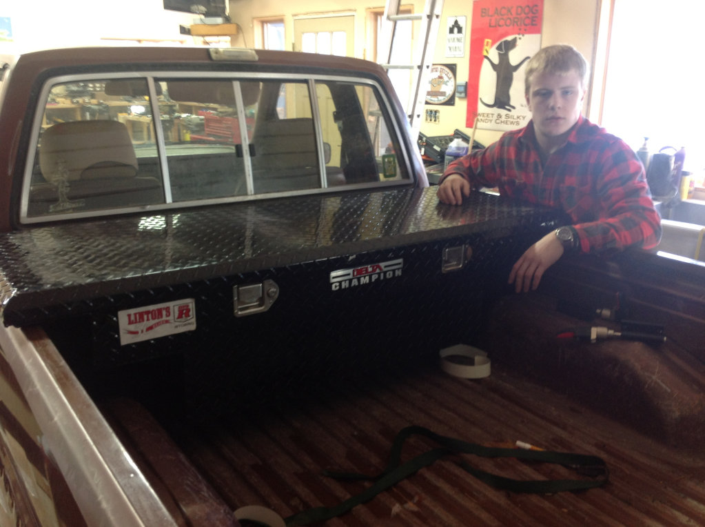

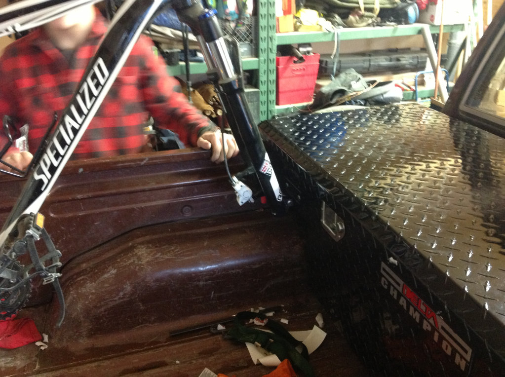

    Also this is more for my dad..got my little bros new tool box and bike mounts installed on his 87 Toyota

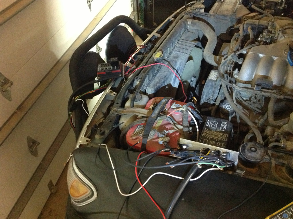

    Holy crap long night.
    Wired stuff up loosely to see how it worked..didn't at first. Spent a long long time going over and over stuff...turns out I had 3 diodes backwards :facepalm: fixed now tho and works great!! I have two bad switches tho I think. One stays on unless you single the back terminals and one won't come on unless you wiggle the terminals..so that sucks. Ill get new ones tomorrow...well..maybe if the store is open.
    Then it's just spicing in the switch power..and then running power wires...whew..

    6th and final relay wired up. This will be for the hella 500s. Why? Cause then I can run 2 separate 12ga wire for each side as they will pull more power then anything

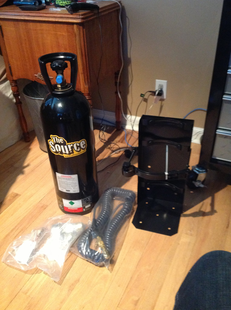

    Co2 baby!!!!! BEST XMAS GIFT EVER!!!
    Thank you Dad! Love you tons pops :cool:
    not as big i thought it was going to be since it syas its supposed to be 36'' tall..seems more like 30..but ill take it :D

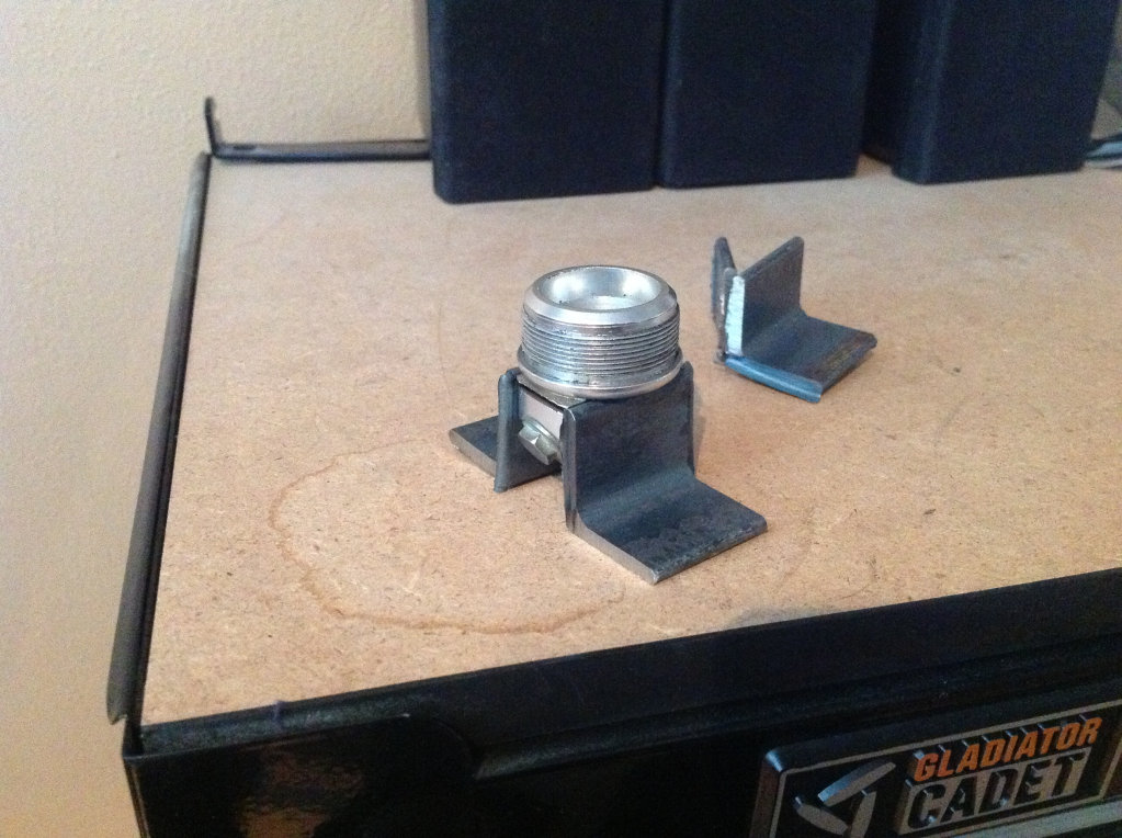

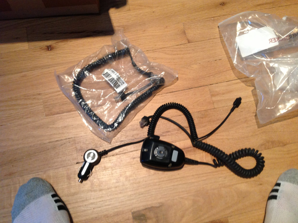

    also ran around to all the thrift stores today and electronics stores to get my cable for camp lights.
    and here is my new idea for the lights.
    im going to weld these brackes and runa bolt to hold the alum piece. Granted it won't move at all due to it being only like 1/32 from the rail.
    this will allow me to just screw them onto the bed rail when i need them :D and the will be solid mounted :cool:

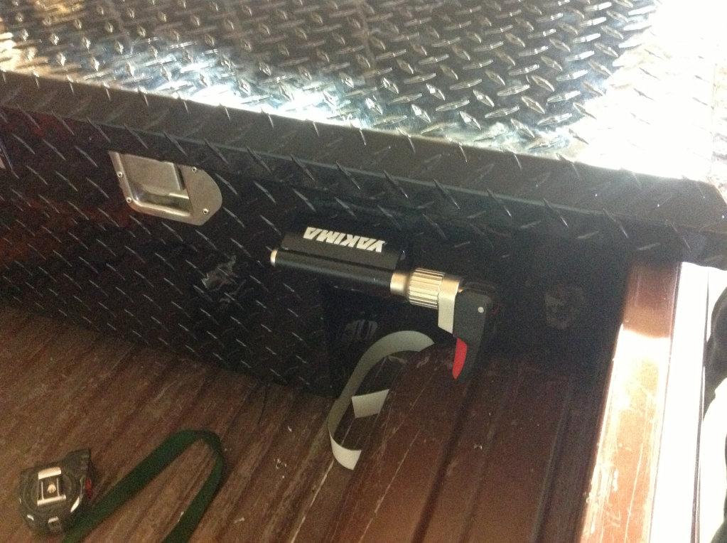

    where will they go for storage? the bed rack of course :cool: the lights will be right behind the cab angled out so i can use them as rear side fills :p i bout 4 mini quick fist mounts that work PERFECT for holding them on the bed rack up out of the way. On top of that..i can use them as kind of portable lights to stick under the truck or someone elses if i ever i am on a trail and helping fix aonther rig(JON!) so..kinda turned into super mulitpurpose lights :p
