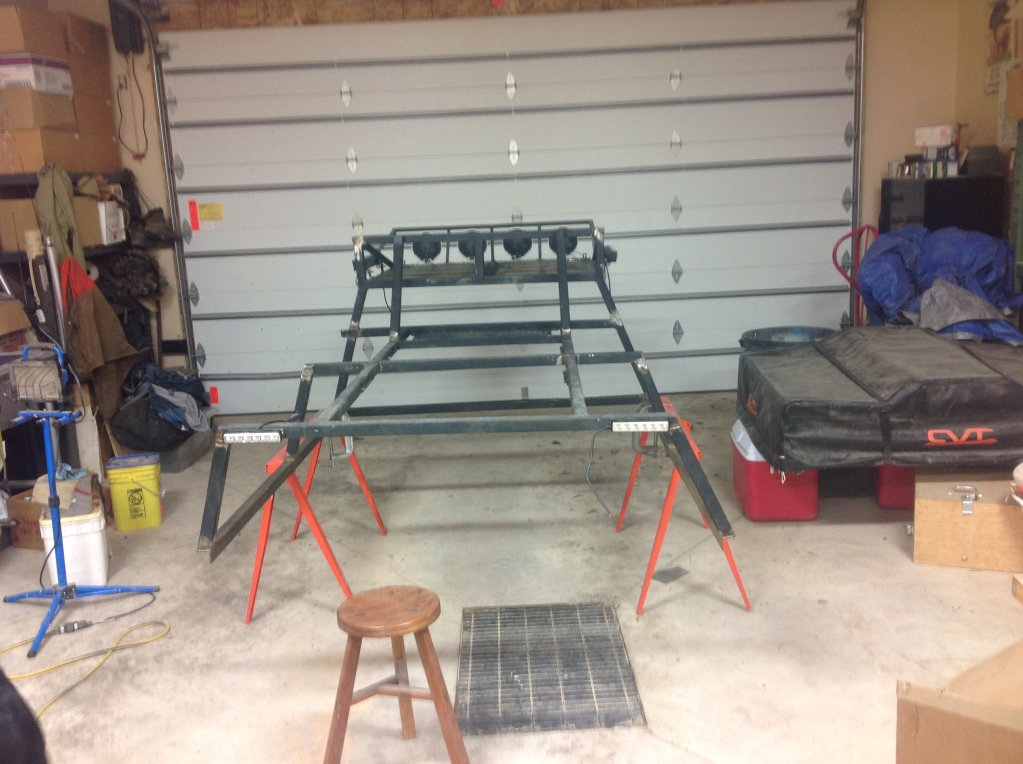

    Hey Monte I had some questions and hope you can help me out!
    How much room do you have between your bed and the bottom of your rack? Is it adequate space to pack supplies? What is the longest trip you were able to make with supplies packed?

    Haven't had a trip where I didn't have enough. Longest trip I've been on strait is a week. Should have a 1.5 week trip this summer. But I have lots of room.
    The bottom of my rack bars are 14" from the bed rail. S I have lots of room to stack stuff which I haven't had to do yet. All my trips have been well below the bed rail for supplies and gear.

    yes, but my concern was that I wouldn't be able to stack if necessary and fitting equipment under the rails.
    I really want to take a trip to yellowstone with a CVT but I want to make sure we can pack sufficient supplies without trouble.

    Well his is tad taller then mine I think. You should be fine.
    Only thing about his is the rack rails that run parallel to the bed rail is on the out side of the rack where as mine are in board a bit allowing for better access. And his roof rack is way smaller then mine
    But I'd think you would be fun to stack up plenty if stuff. It's a nice rack. But if you don't love it and have your own idea for something then pay for your own.

    Lost me. And ya I kinda think I want a roof rack with some light options, I also really like your inbetween rack.

    See how my rails that run up and down in this pic are more towards the center?
    This helps get into the bed. Other then where the RTT sits cause it's as wide as the top of the rack haha
    As fr lights an LED bar would fit up there nicely..not my first choice of roof mounted light..
    But yea if you have your own idea. I'd say build it yourself..or have someone build it for you.
    And CVT FTW man. Love mine.

    yours is just a bunch of straight square welded and cut at angles right?
    I really need a welder and place to weld so I could practice, I wouldn't mind making my own.

    Yea just square tubing man 1.5". It takes more welding and grinding then tubing and bending. But I kinda dig the look.

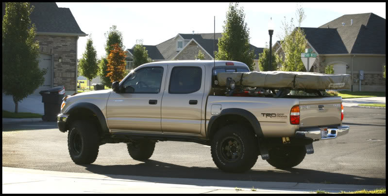

    I think you'll still have plenty of room for gear for that kind of trip. My bedrack is lower than Monty's and I had plenty of room for gear for myself and a buddy for a week long trip under the rack and tent. Even had 5 fuel cans in the bed and my bed is a foot shorter than yours.
