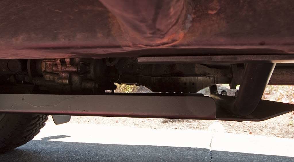

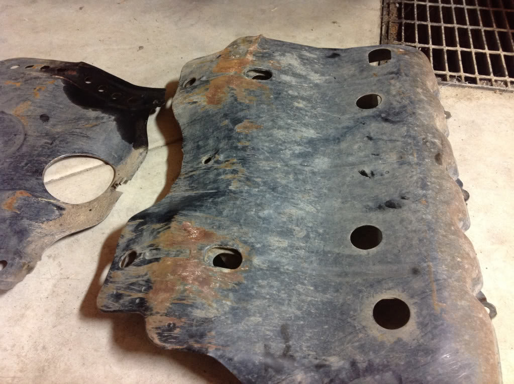

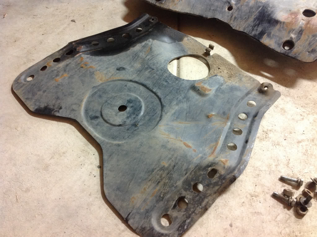

    How longs is the front skid going to be. Will it cover the steering rack?

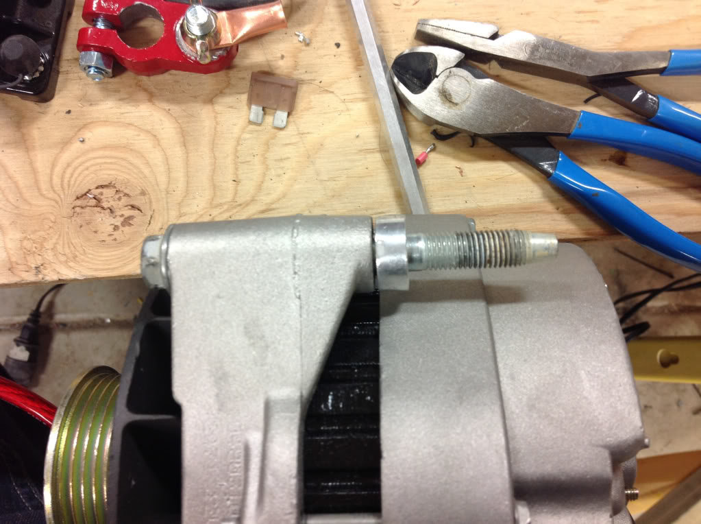

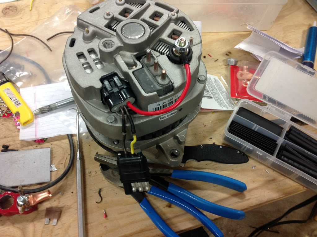

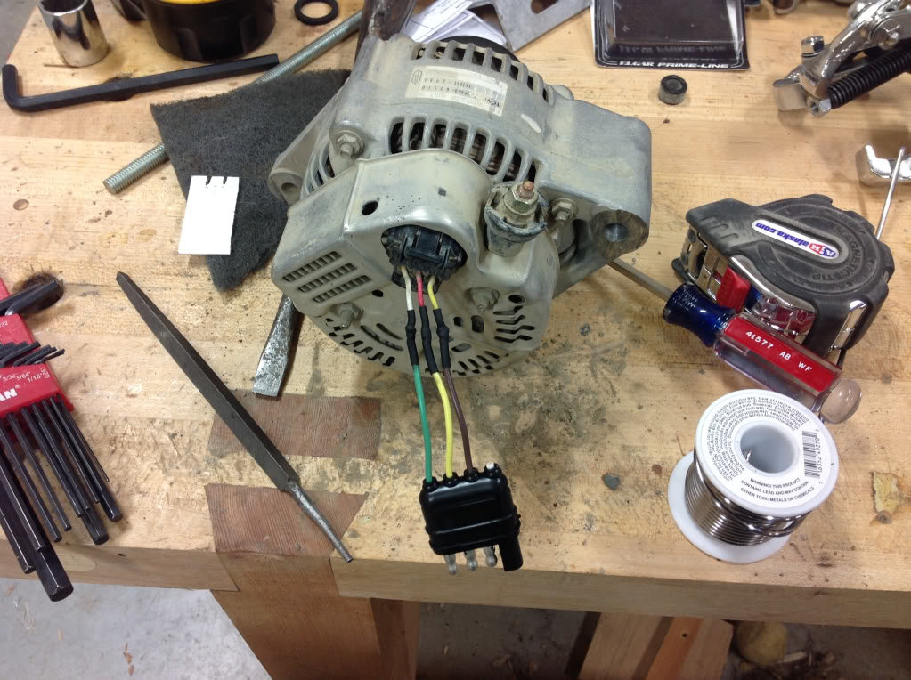

    So started the alternator swap. Need new belts and a few other things. Plus I couldn't seem to make anything work at all tonight. So called it quits early.

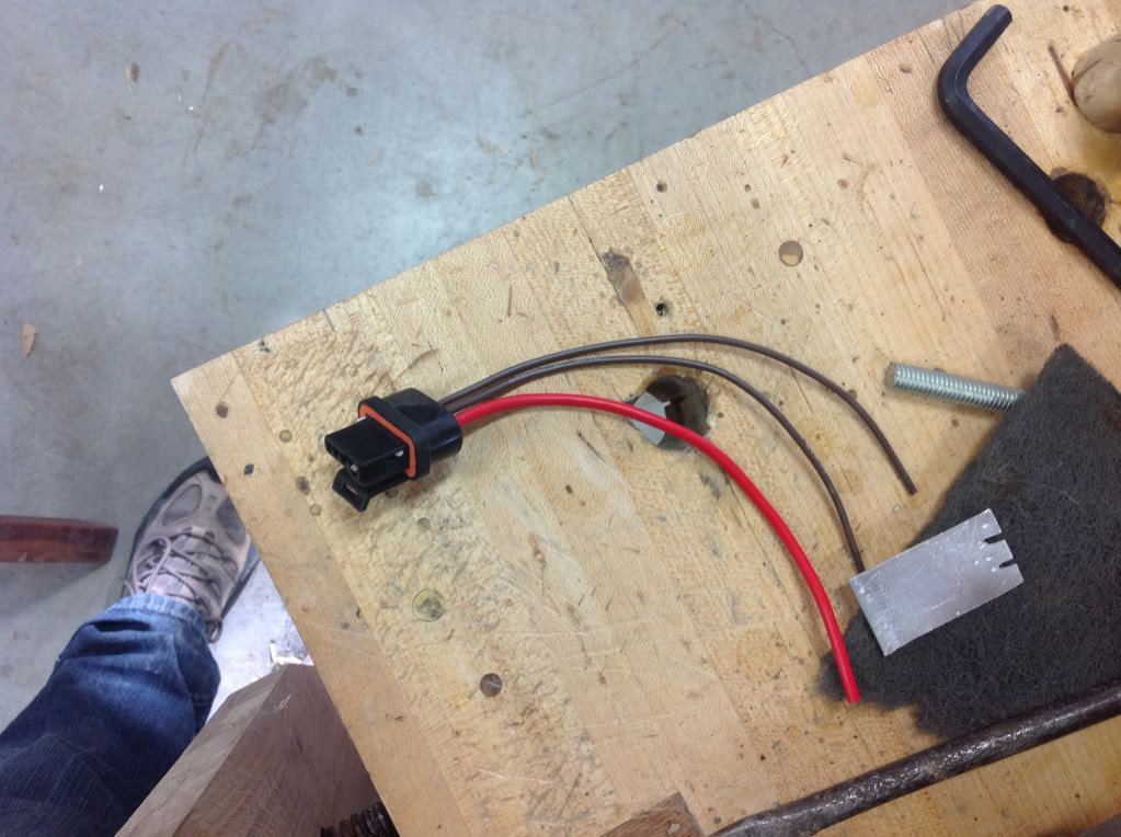

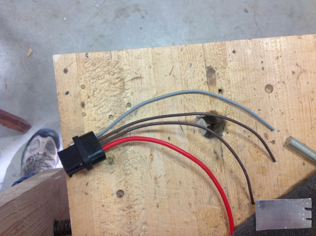

    Here is the GM harnness.
    352f08e2369a582f6cbdc5f723b5c34e_zps765c_3f3549bdcd503c31a75c5ee1f25db0b64a501e42.jpg
    Since how the wiring works. I don't need the furthest wire
    8b674a42e639531f75697bfe1fb2d1a7_zps461d_3cdb662ae732752a84e7fb25fe1a6d1e6ad3cd6d.jpg
    bdc29f747778e2f03f63a05f67b3cfd4_zps5050_1ba6ab249142c97d7117a5f3eb1fa578abc7f0fa.jpg

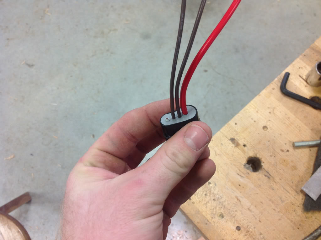

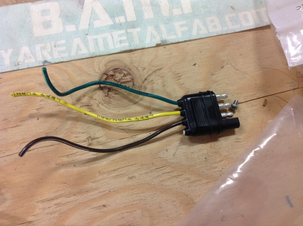

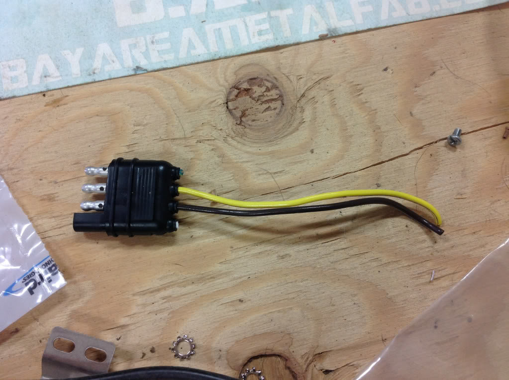

    Since I am planning on keeping my spare in the truck with the OSK. I am wiring up a plug to the stock harness. I'm using trailer plugs. They are 4 wire but only need 3
    209b2aec3a40659465fb02dd57587e17_zps1a33_3d628e97e0a69c618298cf8c55c8cf60b7b311c4.jpg
    This one is for the new GM since I'm just ting the sense wire strait to the alternator

    GM CS144 good to go
    438adb203938e123266826b39d4e7f35_zps67b7_27415ff44973b8302673a26e7e84313d9c32fbea.jpg
    Stock good to go
    cf9d3f54d411ca1750dbf381e74c3e13_zps1d65_b4334257b7c0f7a1dc5338bedaad1adcc96b2e8c.jpg
    then my dad found some aluminum that fit perfect after some filing.
    45458587b52d252f2483caf4f8b016d3_zps0015_9b7a04020b655913d0abf3ee442c2395cd658561.jpg
    Also removed my skids to get to bolts to take off the belts. Can't wait to have new ones!
    39030d37d217b8bb95f3a6bb7561603f_zps47b2_0a09f0ab9d3a1fb581080f5ca8da17cbd82cbb17.jpg
    2584378989fba24279b6eb5f0272f326_zpsdf85_26e19cfead309fa1c613c25b0258368cae44cbda.jpg
    ad7b73978fc0bab83f18eeeb3963ac48_zps1e5c_54002ecca761d0f2f214268b6ab7a0c285c4da34.jpg

    Front skid will go all the way to the tcas crossmember.

    whats the output of the gm alt???

    That is a little further that mine. The is a bracket that mounts to where the steering rack mounts and the rear of the front skill mounts to it. The end of the piece goes another 4"

    140-50 peak.
    110 at idle

    Right. Then you have another that covers the tranny right?

    Yeah, the belly pan runs from just past the steering rack to about 6-8" past the tcase.

    Does the stock harness just plug into this?

    Yes. I had to solder in the other half of the trailer plug to it though.

    Ha, goes farther than I thought. Well past the tcasr

    Yea it's 38" or so. I measure for plastic. 24" or so wide.

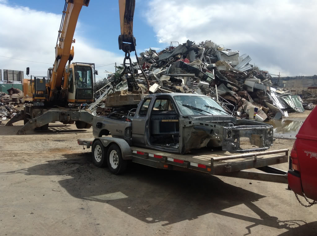

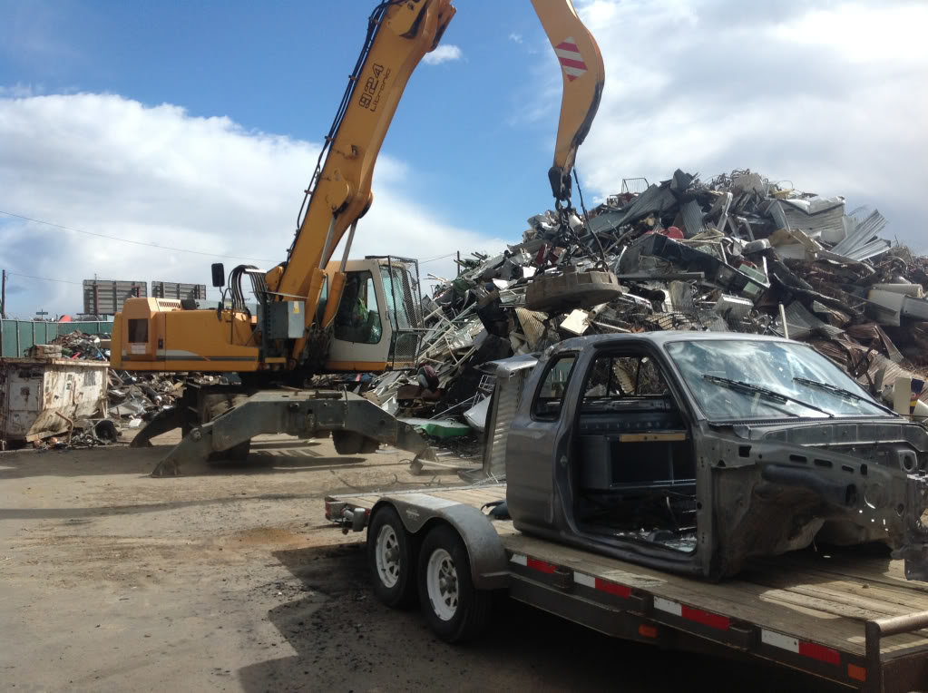

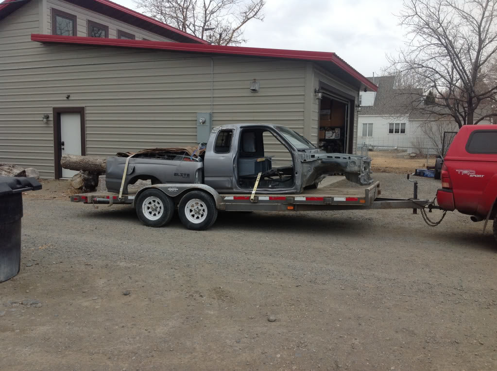

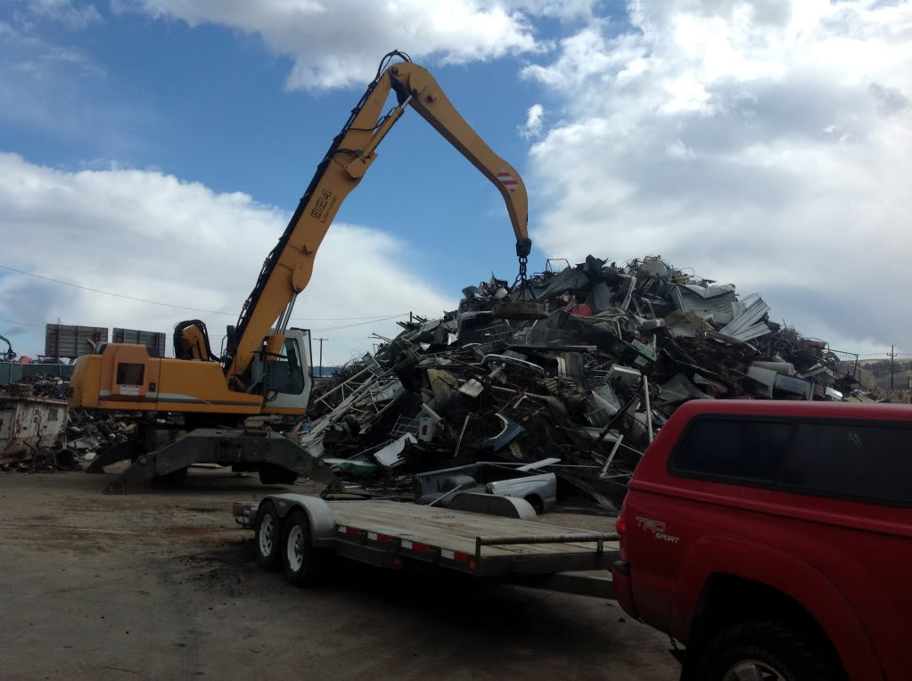

    On another note today...old truck..is officially dead..haul the old body to a recycling center :eek:
    2f5f12dcc5f339811fd25a1f0f73e956_zps3070_0d4b501bd61735d1fe60e36f984817f3973aaf89.jpg
    FRV doing work
    114004d6b54a3a3c776b17d020bad45b_zps98a9_4fbbfaab1cc7fe7bfdad44dd2763fbe3ddffccc6.jpg
    Not so elite any more..
    4f647e0621ec2558924bf5429e002488_zps61ba_d0560802efe7e8204ba8f72770d3bd40859bbb57.jpg
    All loaded up. It's last haul
    081185e6f69cabb257ab3235acb2cf79_zpsbeb2_db313bfcf0b8678464ad3eafe0294d7a85ffb613.jpg
    Frankenstein peeking out..
    50ba10f6ea46e5d86e61fe5f4cf559f5_zps4ae7_fe17abe415193e6756c78aa6aa95e4f10a7577cf.jpg
    Getting in unloaded
    306c98481b6824956a31ceab4c1fa184_zps224f_e6d4b31e0b5a1fd6035bc37ae9e3db921d5d49b3.jpg
    0e3148d841bbf34f0647190ca59af18d_zps4be3_37c431468059ccc1050d0fb9b76ec706ecd07a4b.jpg
    Death to the truck..
    http://www.youtube.com/watch?v=SBk6VEZcJxM
    :wave::pout:

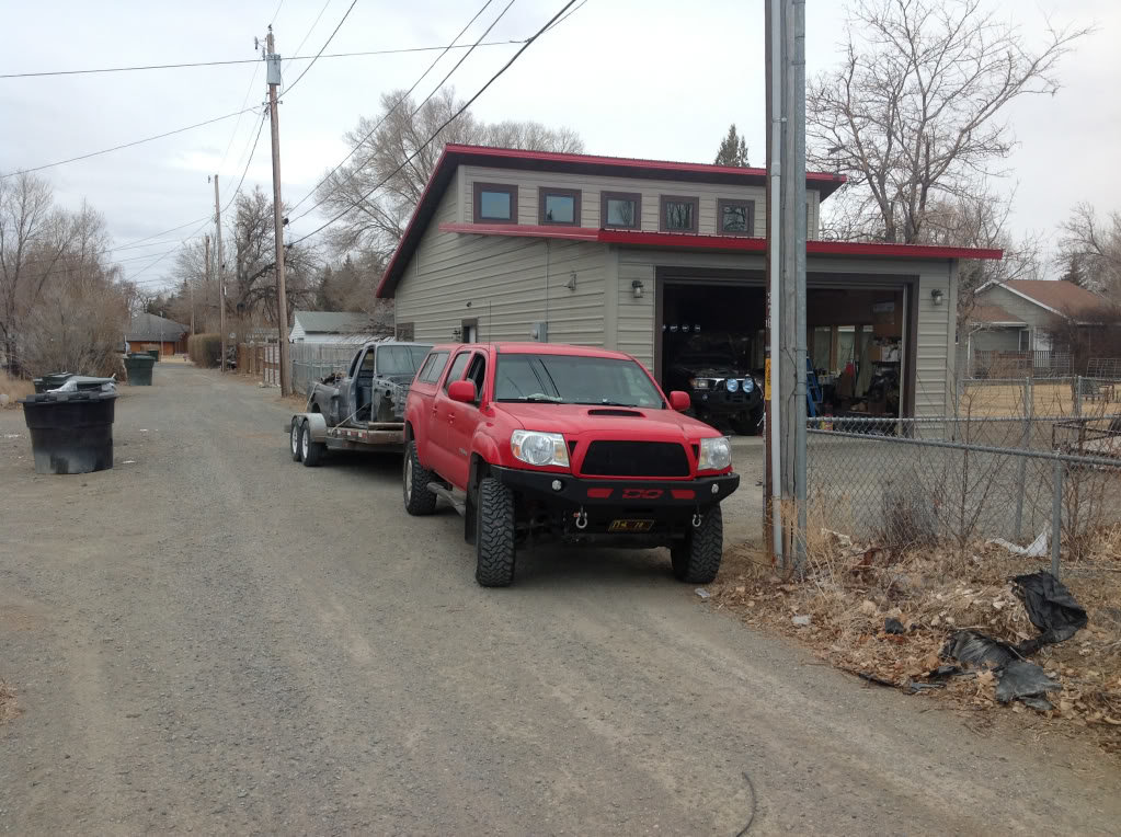

    71361a466bb3996fb174895dcdd4b3eb_zps6ad0_838ec6cfc2e6cd9acad2d141c01eb061bb80c482.jpg
    On a lighter note. FRV towed it like a beast haha

    Wasn't that sad..haha cause I still have a nice truck. Was a bit..but over it fast. Watching the magnetic cranes was fun haha
