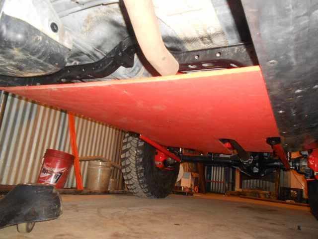

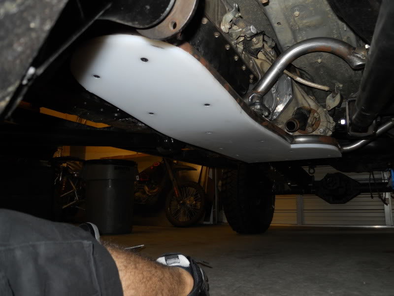

    I believe they did use 3/4". I really like the idea of the stuff being slick on rock instead of grabby like steal more than anything! But I think it would be damn near impossible to do these skids right other than a flat belly setup like this guy did. Not sure how well the stuff would mold and my skids are pretty odd shaped. I mean to some degree it would be doable, but it either wouldn't be quite as protective as steel due to gaps or it would require lots of random crossmembers and such, unless you truly could melt and mold/form this stuff.
    Also Monte, your weight is getting up there like mine. I recommend going 1/4" if you do steel. From what I have read, I was worried I would mangle up 3/16"...

    The belly tho I was gonna do 1/4 steel. But now I think ill just use 1" UHMW. it won't be flat belly(not till tcase is clocked and crawl box is in) but it'll be from the front of the tranny to past the tcase.
    I'm gonna make a cool crossmember setup that ties into the old sway bar hook ups for a front crossmember.

    I believe SilverSeven's old rig used that stuff...

    Yep. I remember seeing that pic before. I wonder how he bent it like that. I don't know much about the stuff but I would think it would involve heat and I would think heat would weaken it.

    That stuff looks thinner so it probably just did that after being bolted down
    And yes using heat and heated properly won't make it weaker. Works well actually. Just gonna know how to do it right.

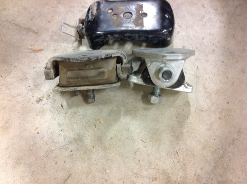

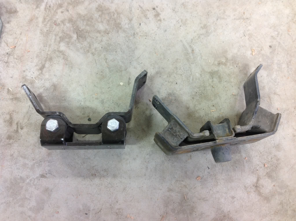

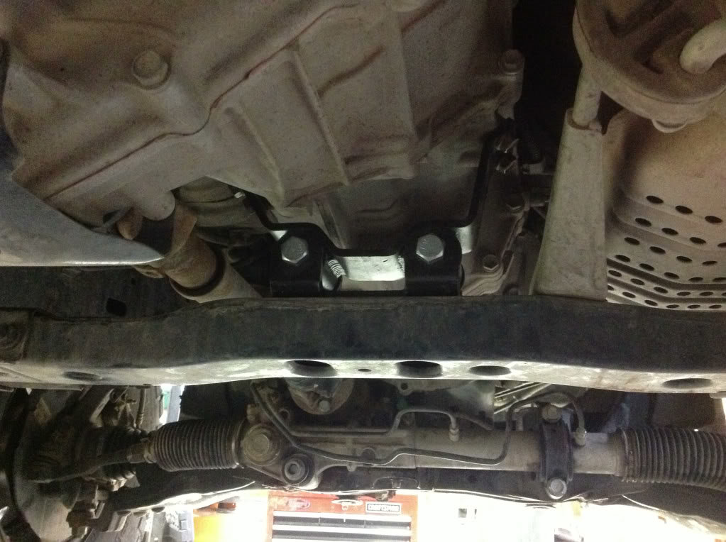

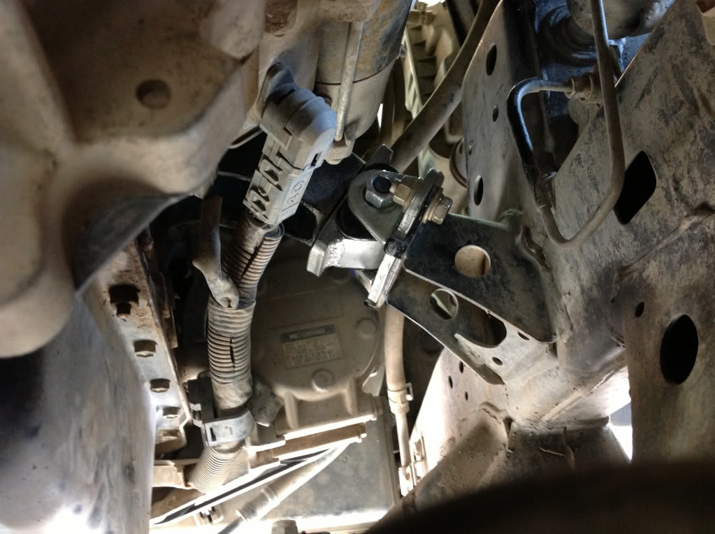

    Thank god!!!! Just got my solid motor and tranny mounts done!! Holy fuck what a PITA. Spent way way too much time on these. Idk why I just could not get the motor mounts off..then couldn't get then news on...Jesus.
    Anyways..
    Tranny mounts.
    f0e7adb9527853c1d463072556467e17_zps957e_88d0c5d60fa55d3db7004badf936c1b0cd653459.jpg
    Super easy to put it
    72caf59b8d424b2ab980e65a8d5abc80_zps059b_861790dc578cd9e7d8f598b30ab2c1210b23b273.jpg
    Motor mounts...NOT easy to put in. Holy piss.
    e4215e3e7683201e78fcf5837df75970_zps6740_f96291deceaae7c1857dd2fea6165a08a173e4c3.jpg
    Installed finally
    1dbb16c1422fe3d728deac2b7e5605ce_zpsa762_5b152a20771ce81bfdb4c39469f236bdbf9ddb0c.jpg
    There are more vibes during idle..but..hardly. Not that bad I think.
    One thing is for sure I'm not putting the stock ones back in just cause it sucked so much.
    So they are gonna stay.
    Haven't driven it yet so no comment on at as I am finishing my steering rack bushings.
    So should be a whole different truck soon. Probably do the steering shaft bushing weld mod too this year.

    What exactly is the point of solid mounts monte? And are those the trail gear mounts?
  18. Apr 12, 2013 at 7:48 PM
    #3418
    Digiratus
    Digiratus Adventurer
    Mar 26, 2010
    #34006
    23,831
    Roaming the PNW
    The RedHead
    2002 XtraCab TRD 4x4 SCv6 AutoTrans With Lots of Mods ADS COs w/Compression Adjusters Camburg Uniball UCAs Whiteline Lower Control Arm Bushings Kartek 7" Limit Straps Plastics Guy Front Bumpstops Total Chaos Sprindle Gussets Custom Alcan Springs +800 lbs +3" ADS 10" Stroke Triple Bypass w/Resi Rear Shocks Custom Rear Shock Relocate All-Pro U-bolt Flip w/Timbren Bumpstops 4.88 Nitro Gears ARB Front Locker ARB Twin Compressor Black 17x8 Konig Countersteer Type X 285/70r17 Falken A/T3w Gunmetal 16x8 SCS Ray10s 255/85r16 Maxxis Bighorns Limited Edition (Relentless) Elite Front Bumper Smittybilt X2O 10K Winch Diode Dynamics SS3 Sport Selective Yellow Fog Lights in the Bumper Diode Dynamics SS3 Pro 4,000 Kelvin SAE Driving Lights with Clear Lenses on the Bumper Morimoto D2S Projectors XB35 Ballasts + 4300K Bulbs Badland Sliders FrankenFab Tire Carrier Swingout bumper w/kitchen BudBuilt Front & Bellypan Skids BAMF Rear Diff Skid Dometic CFX 55im Fridge/Freezer Alpha II Hardshell RTT Badland Custom Bed Rack Denso 210-0461 105 amp alternator Dual Northstar 24F AGM batteries BlueSea 7622 ML-ACR Battery controller Peak DBI Dual Battery Voltage Monitor Haltech IC-7 Display with Mako Dash Insert Haltech Elite 2500 Standalone ECU Magnuson MP62 Supercharger w/URD 2.2" Pulley Doug Thorley Headers Denso 650cc Fuel Injectors Aeromotive Stealth 340 Fuel Pump TransGo A340F Reprogramming Shift Kit OEM ECU Delete Full A340F Trans Control with the Haltech 2500 ECU 2.5" Magnaflow Hi-Flow CAT Magnaflow 18" Muffler w/Vibrant Resonator 13WL Brake Calipers with OEM Rotors & Pads Braided Steel Brake Lines Kenwood TM-71A Dual Band Ham Radio STI-CO Flex Whip VFH/UHF 1/4 Wave Antenna Midland MTX275 GMRS Radio w/Roof Mount Antenna Pioneer DEH-P9400BH HU Alpine Amps & Type R components (F) and coaxials (R) Wet Okole Seat Covers Weathertech Digital Liners Deck Plate Mod 1" Diff Drop Carrier Bearing Drop
    Should get a little better application of engine torque. They don't allow the motor/trans to twist independent of the frame.

    This
    Instant torque. Not twisting. And yes they are the TG BOMBPROOF ones.
