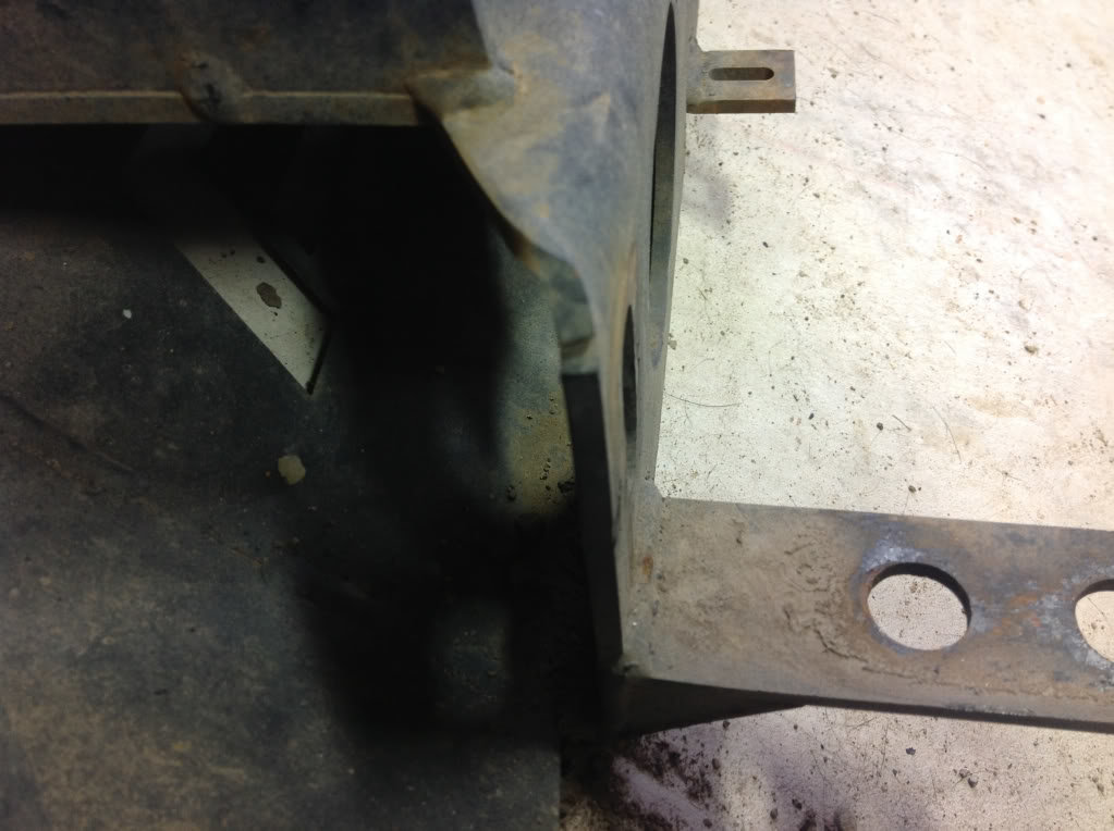

    Okay so update time.

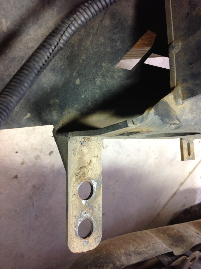

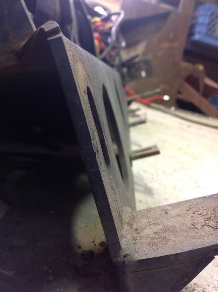

    So my last trip I did some winch ping and tugging with my bumper. It bent forward pretty badly or so it seemed it had bent at the frame mounts. Turns out it did but only a small part of the mounts. Took a few whacks with a hammer and it was flat again! Cut out some 1/4" plate we had lying around and drill a hole just like the bumper. Going to weld them into the bumper later tonight or tomorrow. Should make it quite stout! Tim at Elite was very helpful and almost mad it had bent :laugh: he offered to make me a whole new center section if needed or anything for me. Was very helpful and stood by his product. Love Elite! Thanks Tim!
    Here are pics of the bumper on the truck
    27e6072234922671e958733f86df08a7_zps2f5e_fc3ccf09e9a14990b2a415b92a94467d710ee028.jpg
    c451f9ae5c738ac4e6f0e82bd625ce1d_zps4a78_6a45f276efb5dacb17854991899e9bb6d6b75ada.jpg

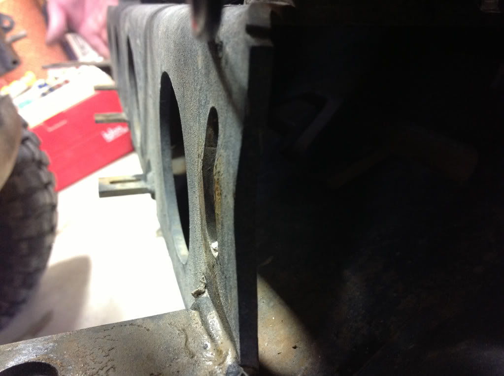

    Here it is off the truck. Nothing else bent at all other then the outside part by the mounts
    58980bfbff2d80e747f278fdfb6a650d_zpsd758_b6e8975a17c3fa9b1fd604229cc8937c40705e0c.jpg
    cc61276fd9fbc917238d68a95763b28f_zps0d1e_856679895ead4ab6c977c4b83944d5e0db0160a1.jpg
    ca1f5e2c4092d264c9dd28910fbf3181_zps0361_fbbc4241e70f4ae8bf1dc7b9e638eaefc71fcdfb.jpg
    Couple hits with a hammer and bam!

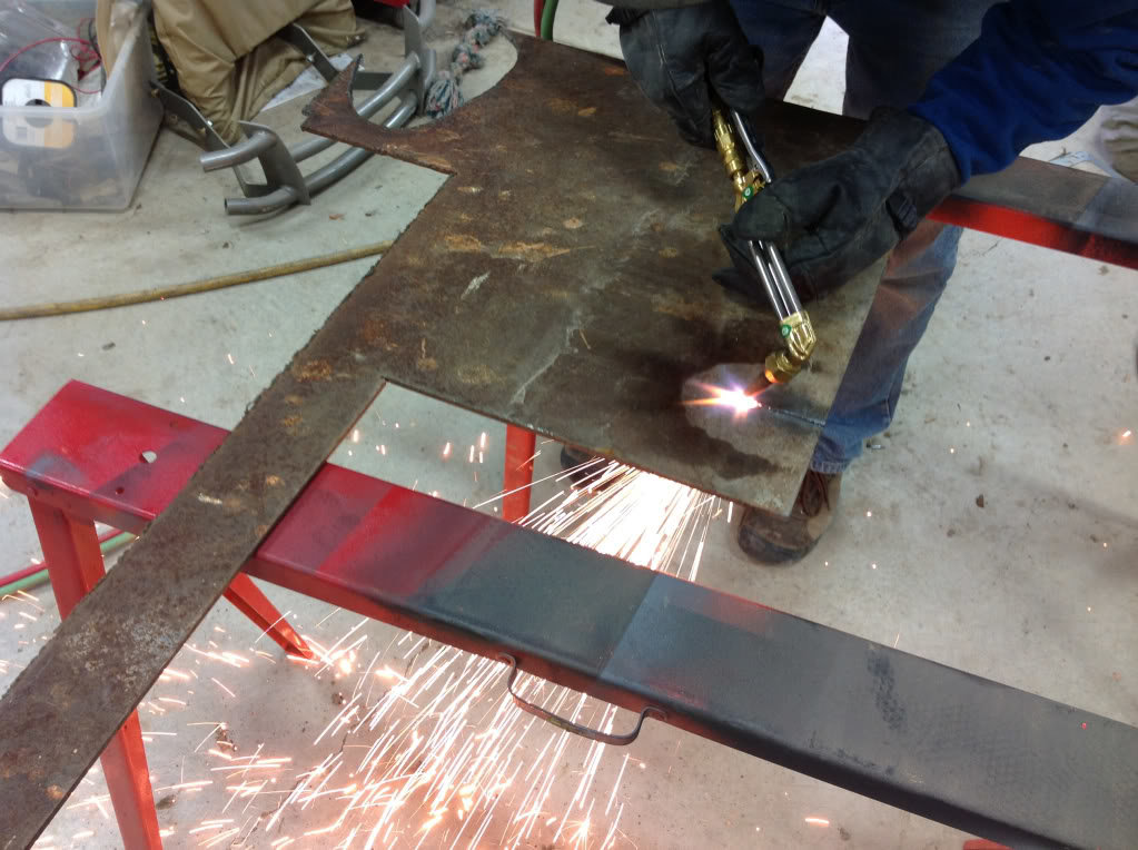

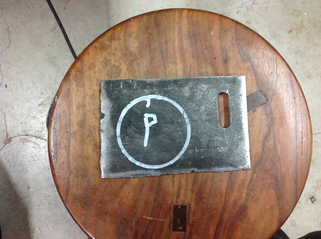

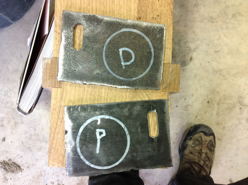

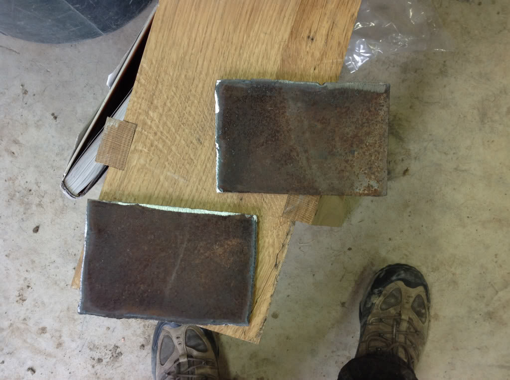

    So my dad whipped out the oxy/setilin torch and a slab of 1/4" plate we had lying around and cut out 2 squares 4x6" to mount right behind the mount.
    f900c22d250acbc9167cafdcb9efb0da_zpsfb35_ba468bef8f75ed872dca1fb05260bbef4a2c81d4.jpg
    3b112cec4467ff5f296db50f342ebb2d_zps728a_cb2f887cbc6e7e08b8cd1e934b3e9517e7983674.jpg

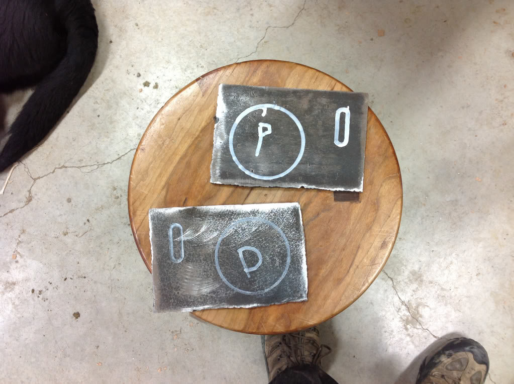

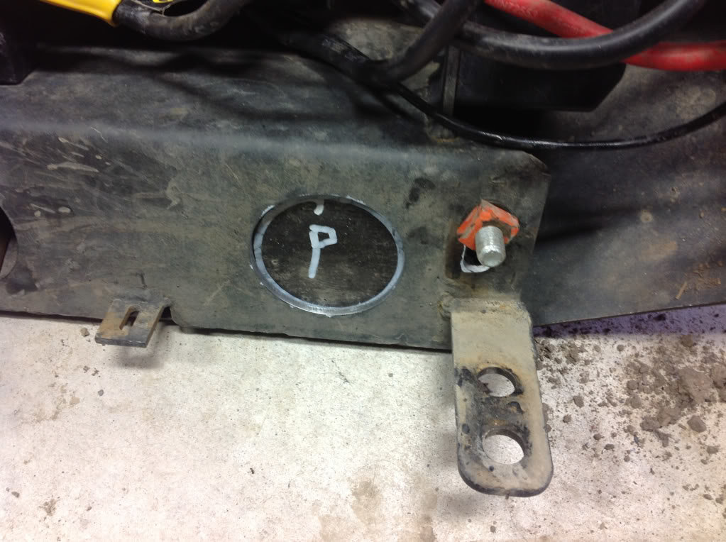

    Cleaned off the rust and lined up where to drill holes
    a511d81b44bb5992170bad4bc87bc619_zps4e5f_b6020a325f5e8b56dfe36e82ef1e1d582b2eab66.jpg
    Drilled. What a bitch. This stuff is HARD.
    eae304623b2968999020109bdb2a4d3e_zps039f_07c7dbbc87f2125d097ac8902a38192a7b852316.jpg
    cdfdd110aa1a294b2c031d4ce24afa14_zpsb633_edcf5390cfed37e588336ab56a0808d1d7bd41fa.jpg

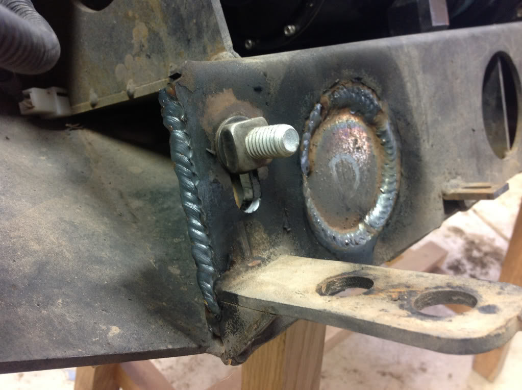

    Put a bolt in to hold it in place for welding
    030c725a0950b281931093fea941a7aa_zpsfd4e_8dbbf8d5f057dd150b588122e4bc1d9f447644ca.jpg

    The part that is bent is the part the bolts to the front of my frame for the bumper. It bent when I did some big winching since the side bolts slipped under the pressure.

    It looks to me like the whole center section really should be made out of 1/4". You were not doing anything out of order. It should not have bent like that. WOW.

    Yea it might not be a bad idea for him to make that piece out if 1/4" now..but hey. Not my call. If there weren't gussets to the front skid I'd put 1/4" all behind it. But it's impossible.
    But I'm actually amazed that that is the only part that is bent. Literally everything else is straight. Other then one spot on the sorta bottom of it from when I hit the rock and a another when I hit the ledge on TOTW.
    This should fix it though I think.

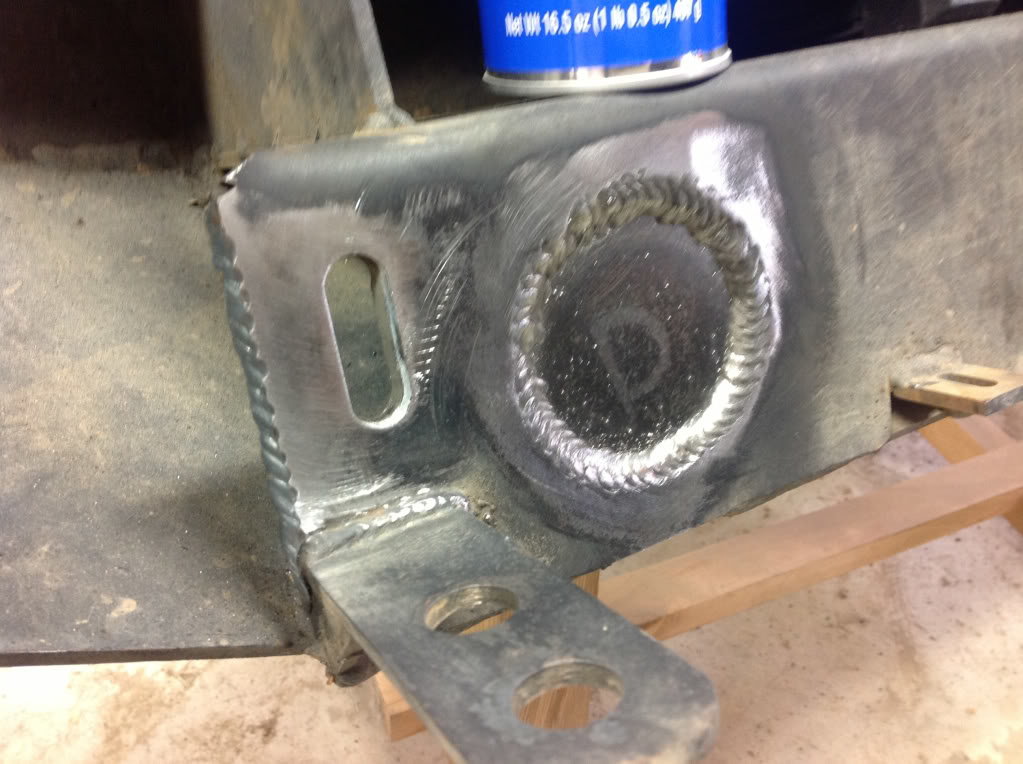

    Blackdawg [OP] Dr. Frankenstein
    Dec 31, 2010
    #48500
    81,607
    Monte
    Wyoming/St. Louis
    The Trifecta of Taco's
    Welded up my bumper today. I'm getting better. Feeling more confident for when I have to weld in my cantilever kit from Engage or frame plates.

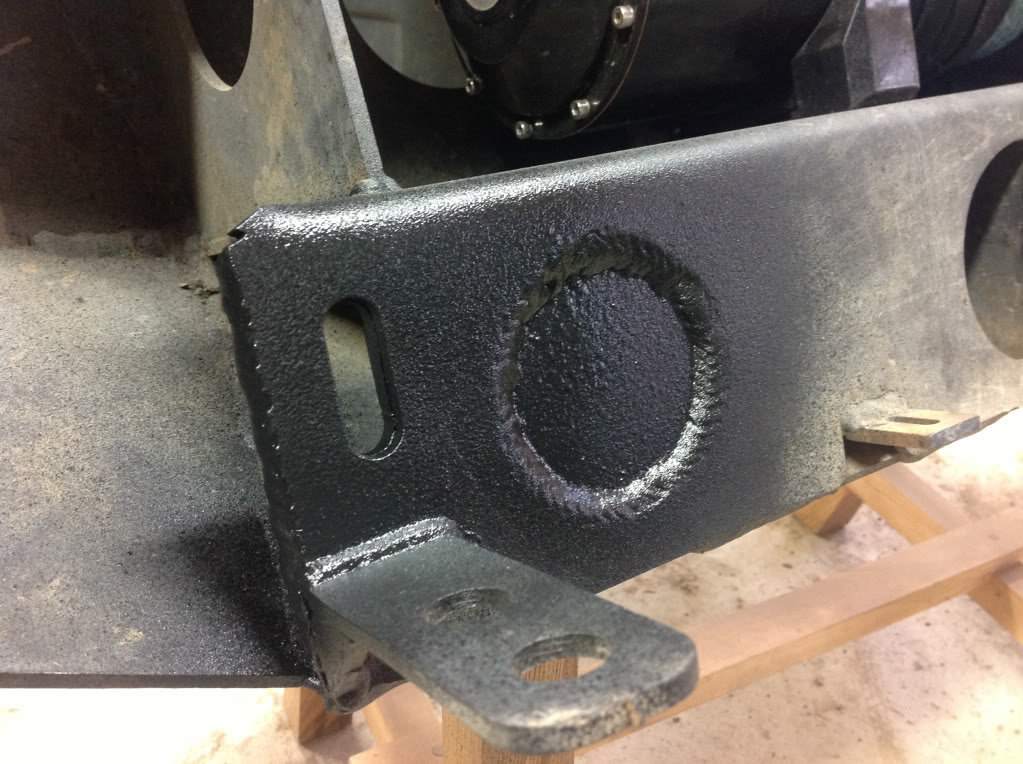

    Cleaned for paint
    77833f4b313ef3a2e08c96c22d80ea5b_zpsa254_3f8cd9a97f2335ed9dd9a7b96aebe8cb745933a2.jpg
    a8a6f412acf83087b956984f5ef1853e_zps4acf_1a3b38a757fe8fba9053c6f7beac1c59bacd6a00.jpg
    Painted! Now just gotta wait
    64255a9fb44e25194f584a30ac3b18ab_zpsb537_1ea3f233fb24af2326d4722f9dc759fbdeb33f0f.jpg

    What did you use to paint it?

    Dupilcolor bed liner. Used it on bed rack and both bumpers.
