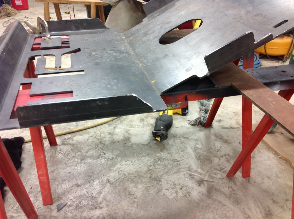

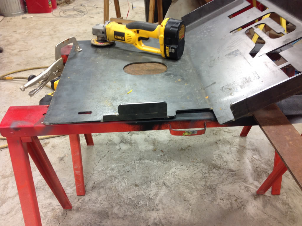

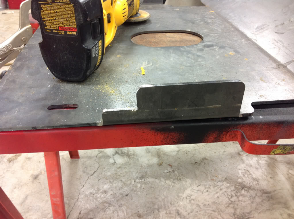

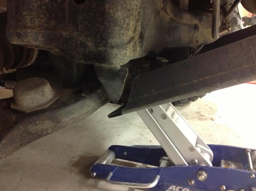

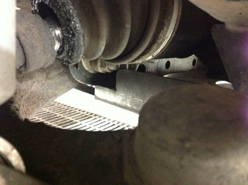

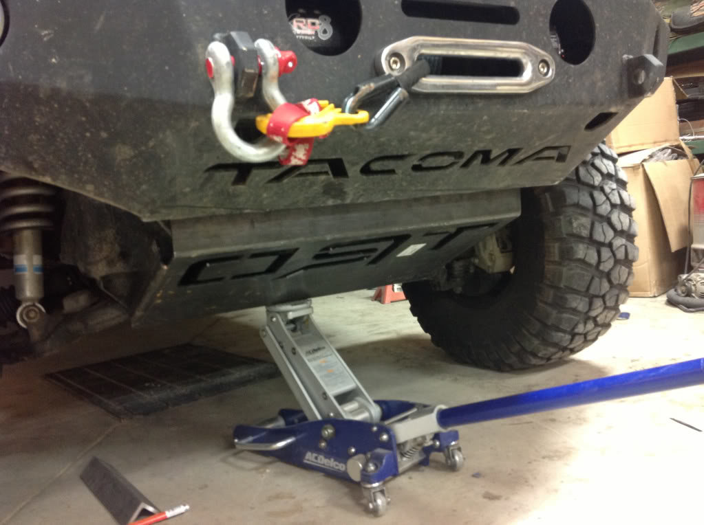

    Worked on my front skid tonight.
    Had to trim some of the upright tabs..
    This one goes inbetween the LCAs.
    e4c69a929c8c5549c648ed96679d445c_zpsb648_cdd19f2fccaa61a39af7b45b8a07012a84994560.jpg
    6af19b93af8124eaf88a3461f7f58a2e_zps7966_d1d7299bdf9848c9af1d7ec2b0c4e66d1e03ede8.jpg
    No more hitting the bolt
    915118f1d85f965931d91b93645e42be_zps5c02_a90cbcb2a01611eb2bbfbe3d6f7b4010f72e400f.jpg
    Lol ass backwards
    f78a8fe85ac5ff39fde9aa506646c247_zpsbb6a_d6415038d8789585184bf1154953262d8247b859.jpg
    Also trimmed the front tabs.
    6237ed460f1e20a7e719fa6d1d6c69e3_zpsdec4_0ead1a0082048d0254d67b10dcf8b042b99ea661.jpg
    010edad869d41b022ad5c755ba6b7c1a_zpsc6b9_ae299c6f3c450d8808cc7f6b3b45eb301f9c3955.jpg
    Now drilled out the bottom stock tabs to hold 3/8th carriage bolts.
    Also going to add 3" out back and bend it up with another 3" piece since it stops right at the rack.

    Also skid now hangs by itself!! Real armor :cool:
    That's what you need for lander haha
