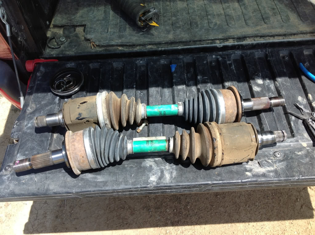

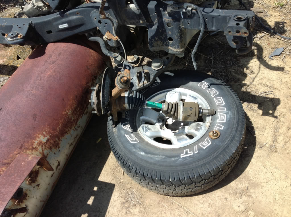

    Two new cvs for 70 bucks :cool:
    Donor truck..
    30205811139a6586205b37dbf9a5bbda_zps82a9_d7592eea382a81d49251877d260a0574cf5eae5e.jpg
    First one was already half out haha
    79a1e9bce023adffa09c1fad5089dcd9_zpsdc6d_78621582ef8c864ab5829b7214fda2e4aa7e47d2.jpg
    Hell ya :cool:

    I hate you! haha Cost me $90 just for 1 OEM CV at a junkyard...

    35 bucks each man! Haha freaking awesome!!
    Now I want to put different boots on them tho..

    Meh! Run them tell they blow then swap them, unless they look shot already.

    Nah they still work. Would be smarter to swap on better boots on the ones out then put them in the truck then swap on boots on the ones at are torn.

    I would just throw them on and swap the boots on your torn ones so the will be safe trail spares and then just wait until the old ones go. Up to you though. Not sure what those Porsche boots costs, but my boots kits were like $35/CV.

    FWIW, I agree with Brady. Swap in your "new" axles now, as is. Then rebuild your stockers, go with the high angle boots because you are going to need them.
    I predict the "new" axles boots will succumb to the same fate as your stockers if you still have high axle angles. When they do, you can swap in your freshly rebuilt stockers with their spiffy orange colored boots. :rolleyes:

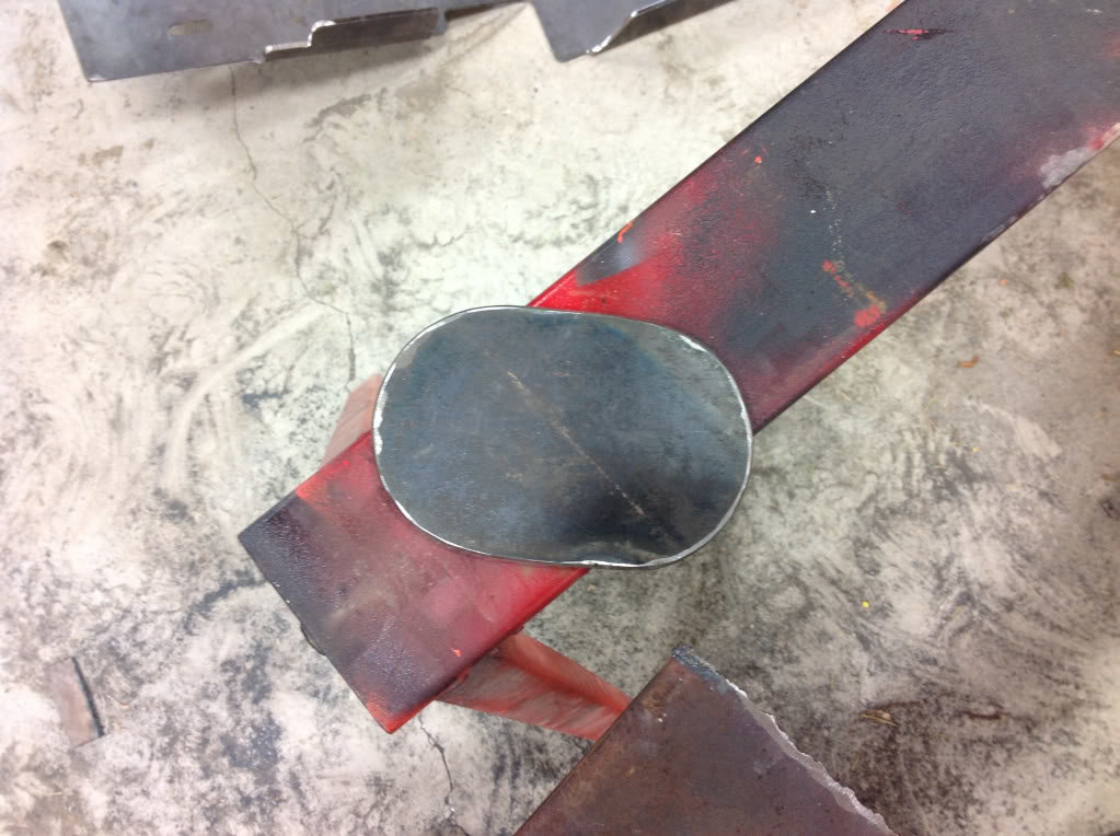

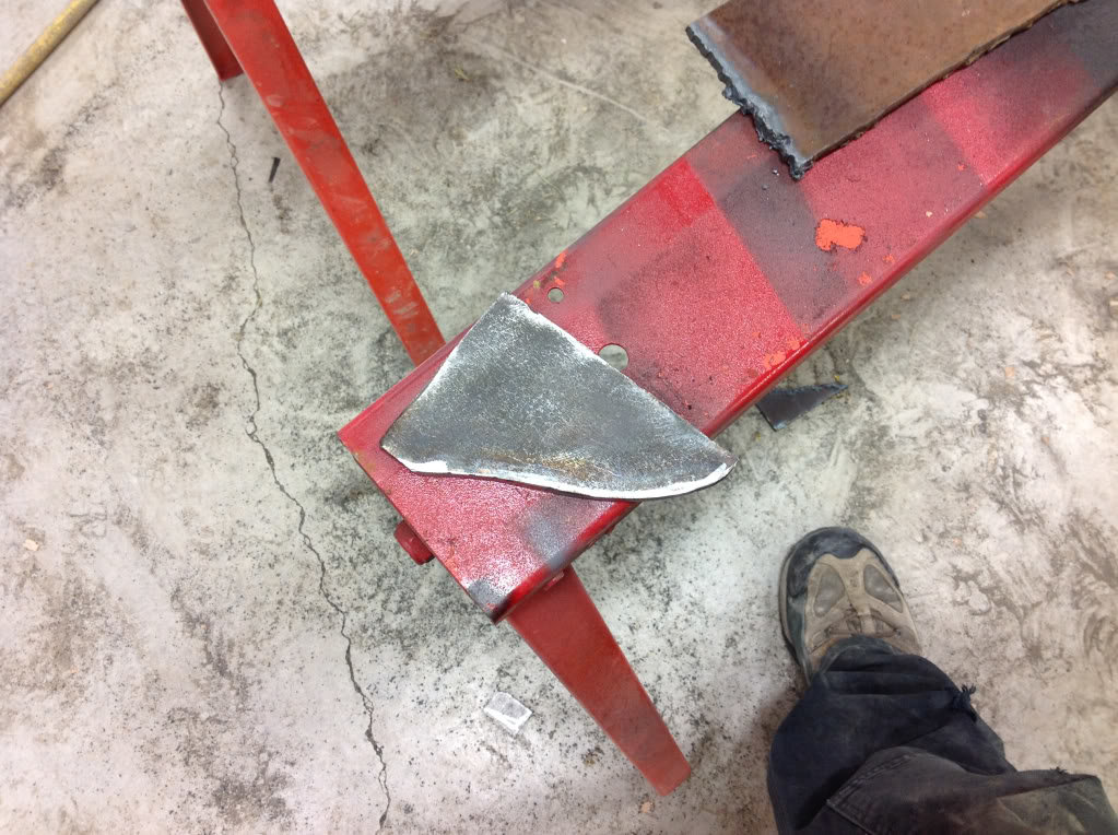

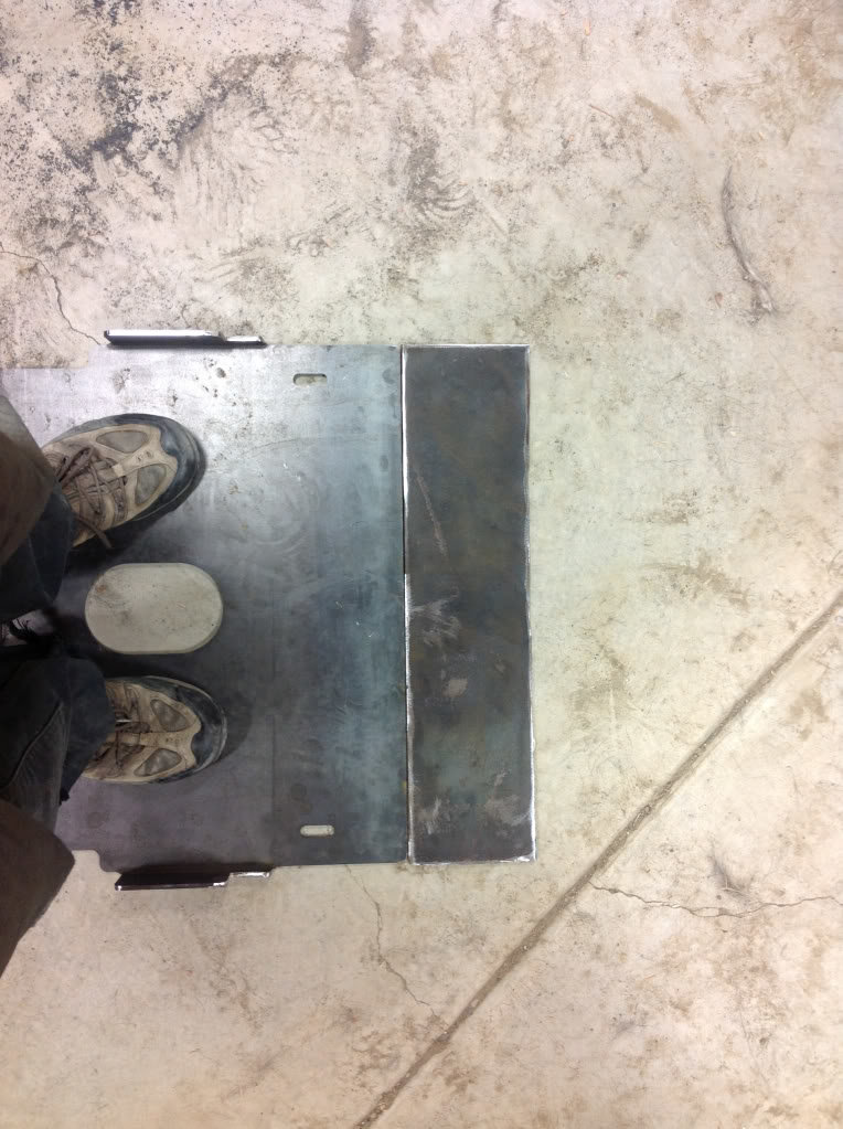

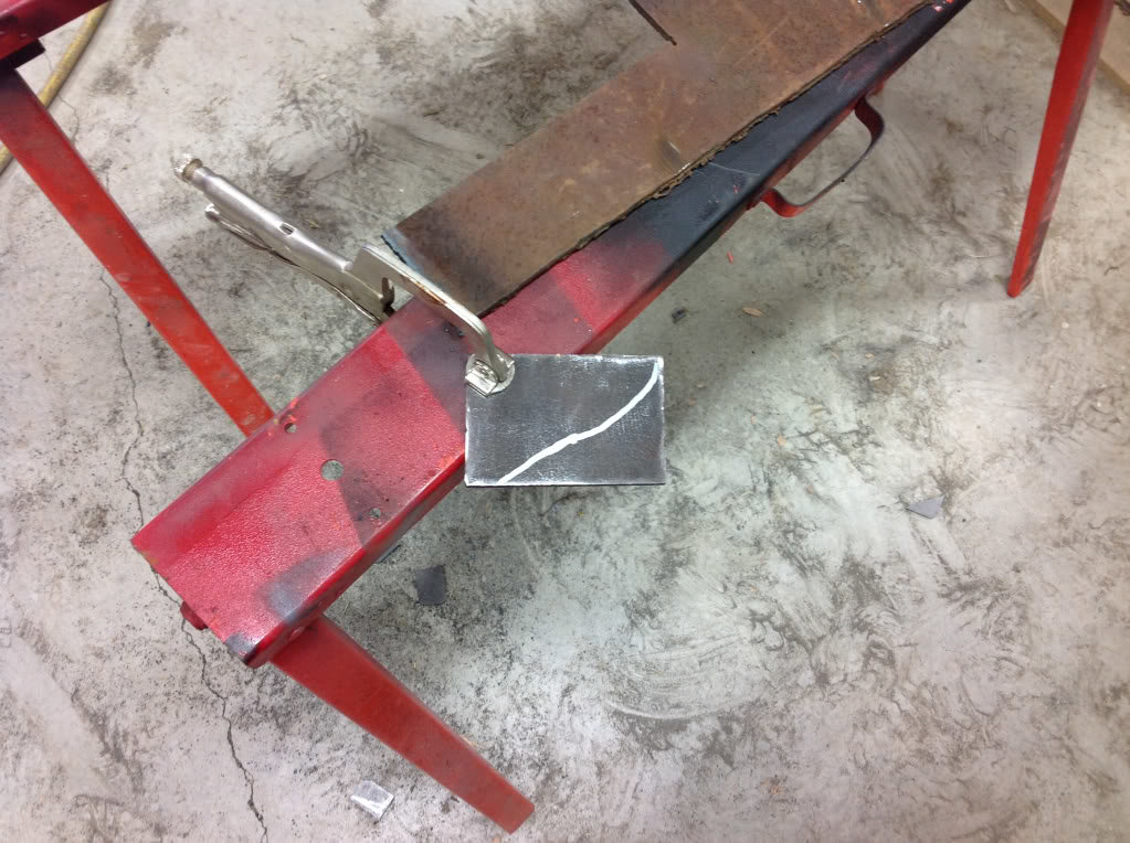

    Did a ton of fabbing today with my dads torch. Was fun. Not as nice as a plasma cutter but I was glad I had it!
    Cut out plate to weld to cover the TRD and the oil drain hole and add an extension to the rear. And cut out and fabbed a plate for the rear bumper and a swing out pin stop.

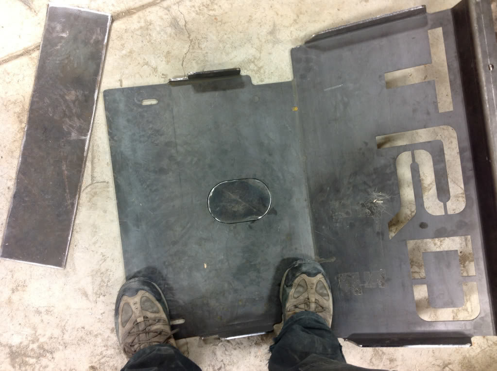

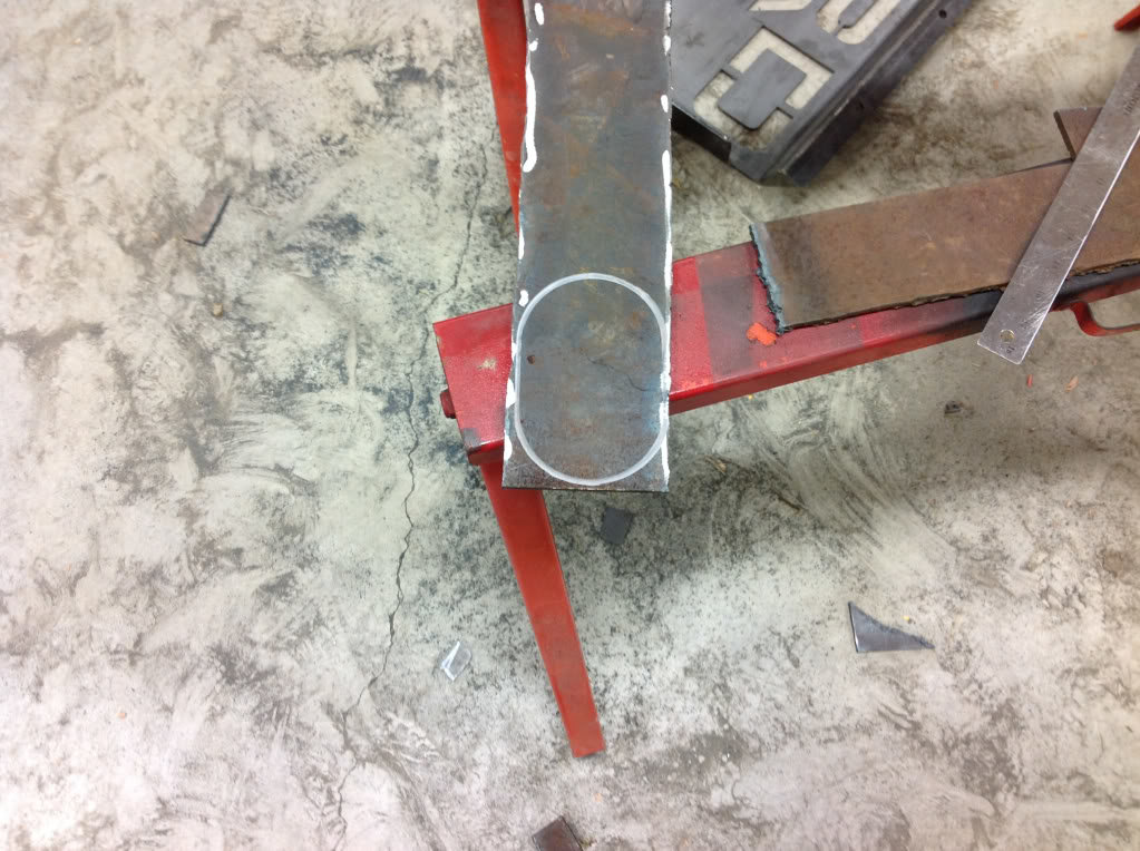

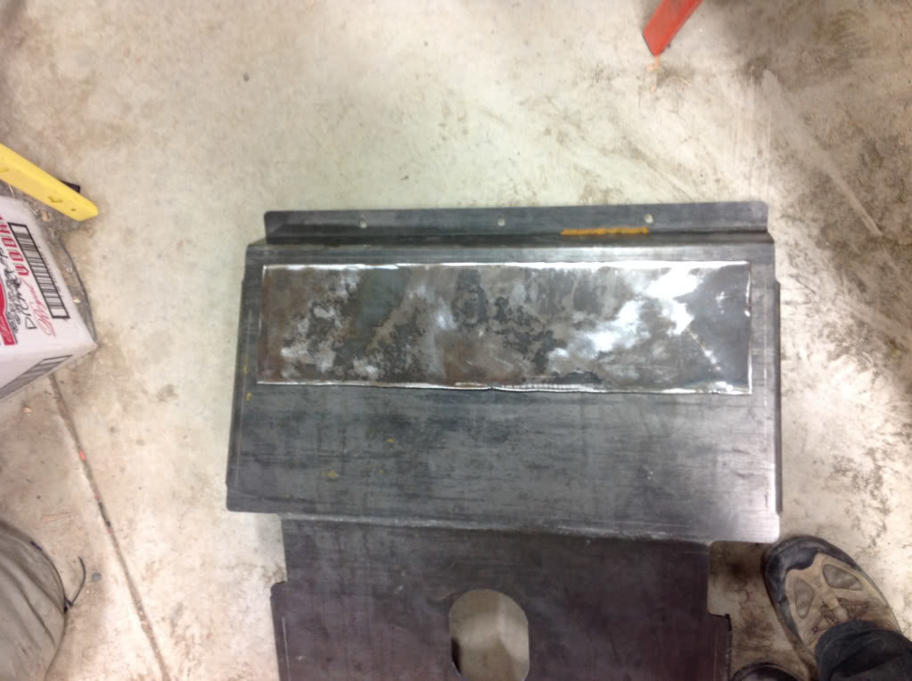

    Here is the bumper part..
    43b0303d6c9f0c68b51e35d44ed97916_zps3815_6bc4a9773e6820b7b28713618621ace01e37c6ae.jpg
    f963044faf15081fcb6ae1caa119bb03_zps8d2c_1935557354972211d3cc4a9e954be963d9216f49.jpg
    Some grinding..
    f0994035adcc1714268c41af9c987184_zps657d_3955f6d8b833b5581e74e961c97f5bd30e138809.jpg
    Final version just have to weld it.
    25e65b279a25e07e7297d32b0e07dd9d_zps9111_74684c4af2d54bef042eeabcc2d30d44771bba6f.jpg
    Rear extension plate
    36b7f13a54bace5ab6c1e0af28c572fb_zps744b_c8dab84990271c6de04d16b778a4dab8d5e9fcea.jpg
    Front plate
    1cc18a52ac860dead18b704712d4432d_zps8363_b87f79581a0c1ab25c41480a0f115f69e583b2dc.jpg

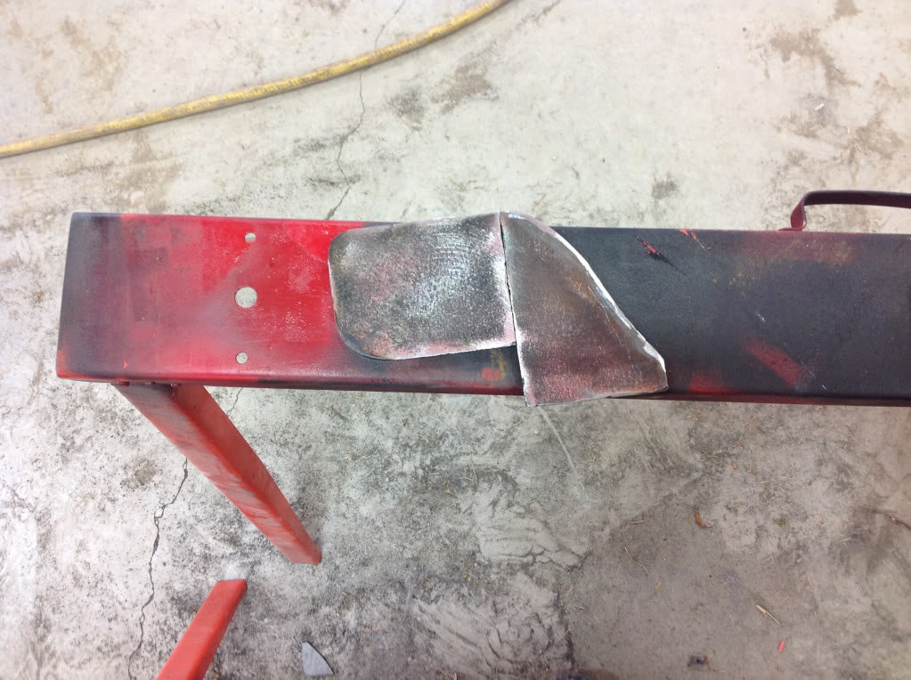

    And the tricky part
    92f886d227a71566a5d31a1aab999847_zpsf951_83f6648a52441a4a3ce5fbb848a70686207eb48b.jpg
    f0be11780f63bf508267ff8ae58a3976_zpsf3bc_46db62f985f54e626fb464a1e430f1a95a916ab7.jpg
    b5c35eda074100cf2b31c79b14013de5_zpsdc57_4a8d9401f3e1b015dbaecf492b8ef49ec415b3a6.jpg
    Lots of welding tomorrow!!
    Plus finish the Jerry can mount hopefully..and weld the tabs for the table.

    What was your reasoning for covering the oil drain gap? Just for less things to catch on?

    Yea and it didn't line up with the oil drain in the first place..it would hit just before the forward arch. So fuck it. I'd rather it be flat then catch on some rock. :cool: I have no prob with taking the skid off to change the oil.
    My dad had a cool thought of possible putting a hose one the drain pluge and a valve on the edge if the skid..might fiddle with that. Got all weekend now.
    So gonna weld shit tomorrow. My dad is gonna pick up some welder, hopefully a miller. Especially since a bed rack is in his future. And sliders. So that'll be sweet!
    Then change my cvs and oil. Then clean up some more wiring and other stuff. No camping for me this weekend sadly. But my bro want to go climbing so ill take my new truck for that.

    Straight as an arrow:rolleyes: Although I get the idea it is supposed to have an S shape to it.
    Nailed it the 2nd time though, holy shit that is clean!

    Hahahahahahaha right! You can tell I got better with the torch as I went lol. Was tricky at first.
