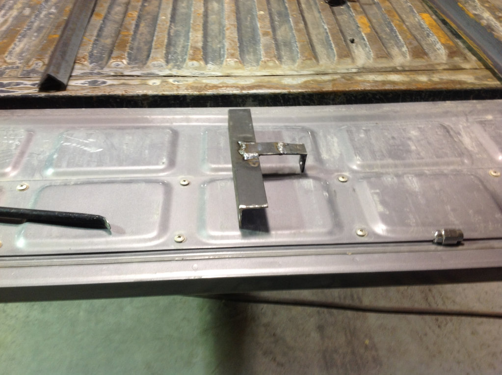

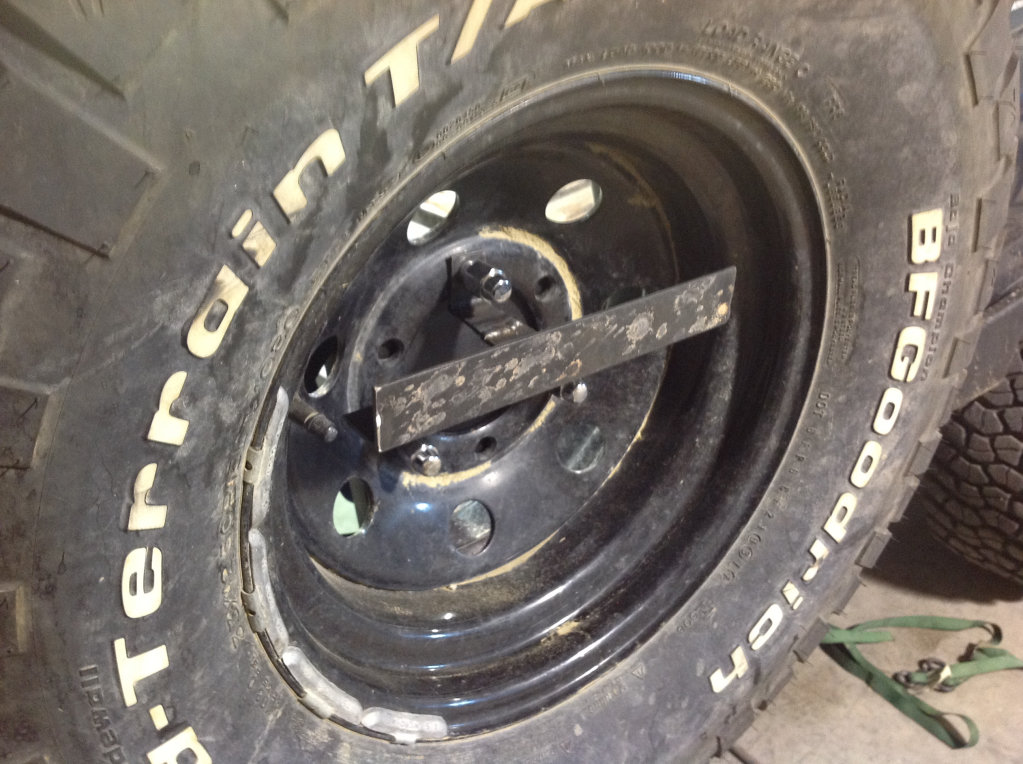

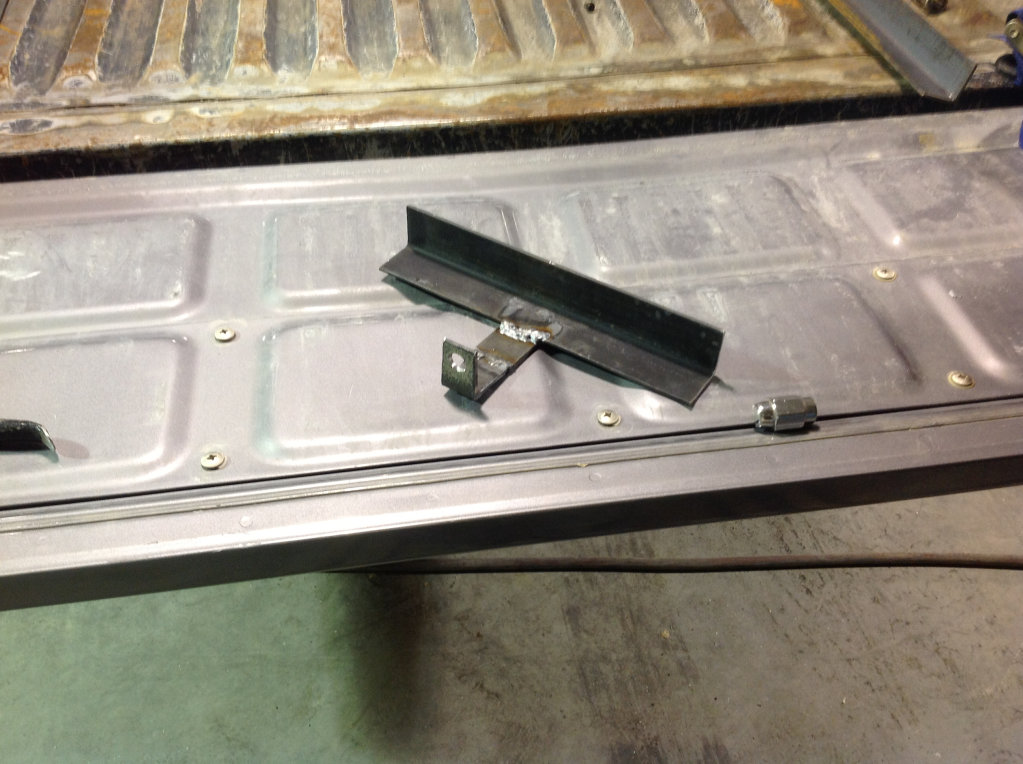

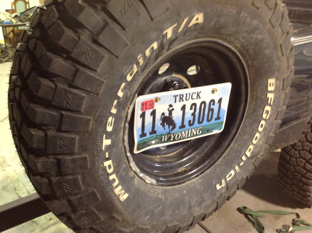

    Monte, how did you attach your license plate to your spare tire? I'm looking at ATO and Pelfreybilt H/C rears, but the ATO doesn't really seem to have a well-thought out license plate mount, although it is much cheaper and still an awesome bumper so I am keeping it on the list. I would like to get the ATO if I can figure out a way to mount the license plate on the spare tire like you do.

    haha well made a bracket. Super simple. Im sure you could or get some one too.
    Just used some 1.5'' angle i had left over and some strap to connect the two pieces. You just put it on the top lug that holds the tire on like a washer. You do have to use a wrench instead of the tire iron but i have a full set of wrenches with me at all times. Its pretty handy really. I have plans to put a small light there to make it legal too just never got to it.

    Bah! Waste of steel. Just screw the license plate directly to the spare. :D
