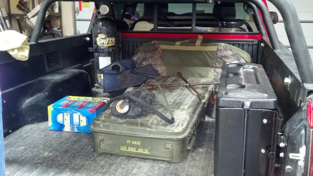

    Monte,
    I went back and looked at about 20 -30 pages of post, but I don't remember seeing pics of how you mounted your c02 tank. care to share?

    This is how I mounted it in my truck after I stole it. :D
    Two carriage bolts into the rail. Sitting on a piece of wood.
