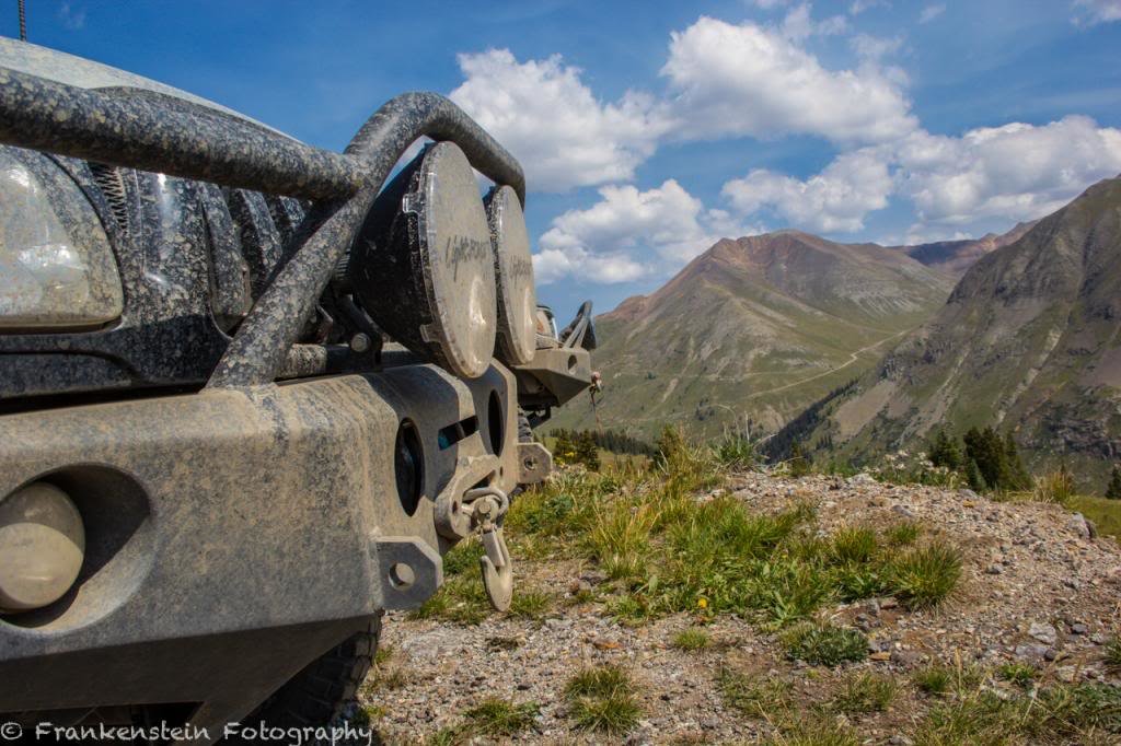

    I'm about to hit the hay so I'll respond to that last post more tomorrow. Take a look at this quote from you in another thread:
    Do you happen to have a side shot view to show how far they stick out? Would you have anything different done-- drill the light mounting holes a little farther back, toward the grille few inches more?
    I'm getting the half guard & have LF 240s already wired up and ready to mount. Just emailed with Tim and my bumper is currently being cutout so I feel now is the time to ask for simple modifications..

    The lights do stick out in front of the bumper, but not the light hoop. And when something does hit them, they just tilt up. But yes you could just drill more holes a bit further back. That said i have the slimmest grill that comes on tacomas (95-97) and i probably could only have gone 1'' back.
    All in all..im not totally worried..LF lights a freaking beef and like i said, they just get tipped up generally or there are plently of replacement part if something does infact break.

    Your lucky day! I have the perfect pic to show you what i was talking about.
    Truck in the foreground is Cody's, he works at Lowrange Offroad. That a bumper built by Tim this year. Mine is in the back ground. We both have LF240s and you can see they over hang the bumper, but the hoops protect them perfect.
