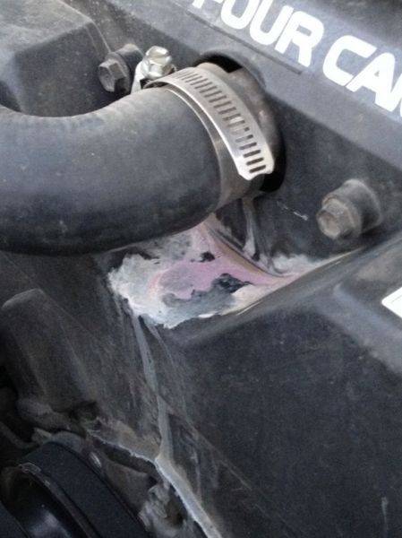

    I have another question, i noticed this
    the other day, no noticeable drop in the coolant resi and i haven't seen any fluid sitting there, thoughts?

    hmm..looks like some coolant came out some how. Check the hose right there and make sure its not spliting and that the clamp isn't coming loose.
    squeeze the tube with your hand to see if its starting to split from age at all too.
