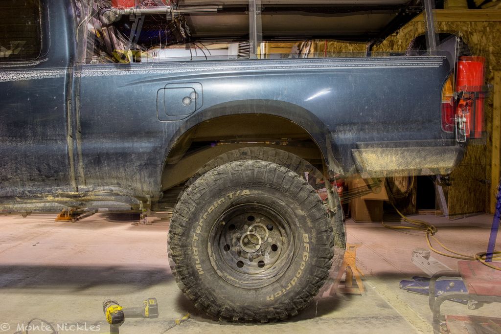

    :woot: 1st 35 is on! rear driver side. Wasn't too bad. Need to pick up some door trim to put on the fender and it'll totally done.
    on to pics! all pics where taken with my camera on the tripod..it never moved.
    33..
    IMG_7895.jpg by Monte Nickles Photos, on Flickr
    getting ready to mark it up
    IMG_7896.jpg by Monte Nickles Photos, on Flickr
    Marked! i will get a shot of my tool i made tomorrow.
    IMG_7900.jpg by Monte Nickles Photos, on Flickr
    Relief cuts made.
    IMG_7901.jpg by Monte Nickles Photos, on Flickr
    No going back now!
    IMG_7902.jpg by Monte Nickles Photos, on Flickr
    I used an air powered spinal tool to finish getting the final 1/8'' to make sure it was as smooth as possible. turning out great.
    IMG_7903.jpg by Monte Nickles Photos, on Flickr
    35 :cool:
    IMG_7904.jpg by Monte Nickles Photos, on Flickr
    these things are big..haha
    also might get an axle relocate plate to push my axle forward .5''..not sure yet..
    oh and i cut 1.75'' out of the fender.

    thanks! i kinda liked it myself haha thinking about doing it for one of the fronts too..just maybe at a different rate so its not quite so short haha

    Looks like way too much work to me. I tried using a tool to make the line but ended up freehanding it, no tape and just used the angle grinder with a cut-off wheel. Guess I'm just lazy. :eek:

    Yeah but the front ones aren't round. Plus you'll probably need to take a little more off the front near the corner light. Might not. All these trucks are a little different.

    for the front..it'll be interesting for me as i have fiberglass fenders. I know ill be taking a ton out on the cab sie and bit out by the corner lights too. But idk if ill have to touch the middle. Yet..ha
    Also have to trim the front bumper and just a touch on the sliders i think..
