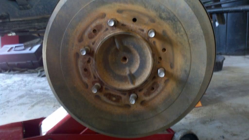

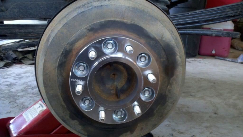

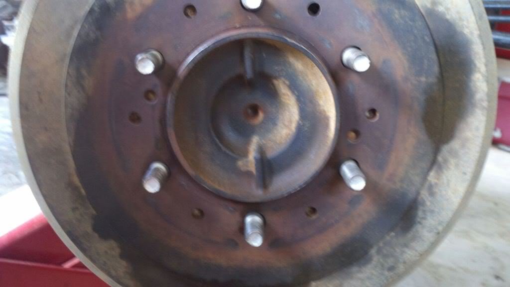

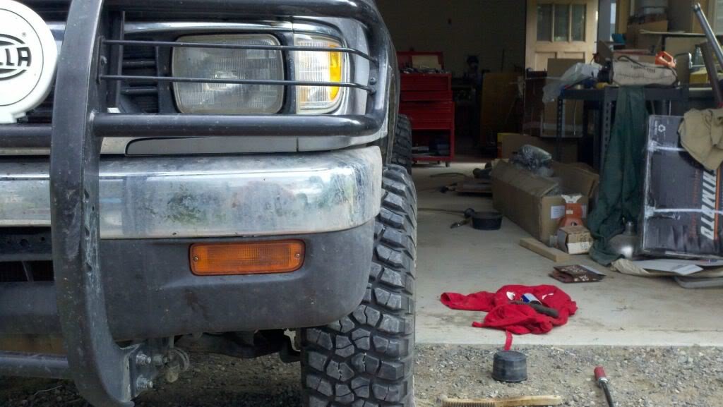

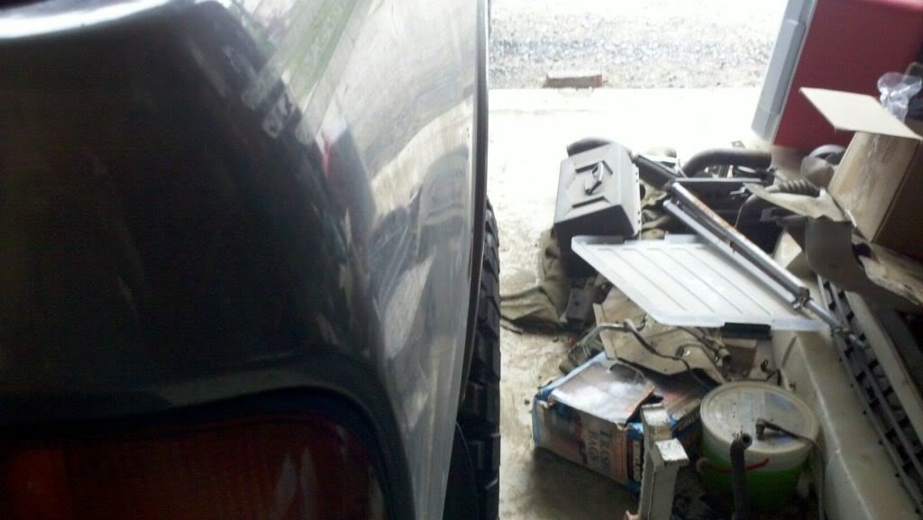

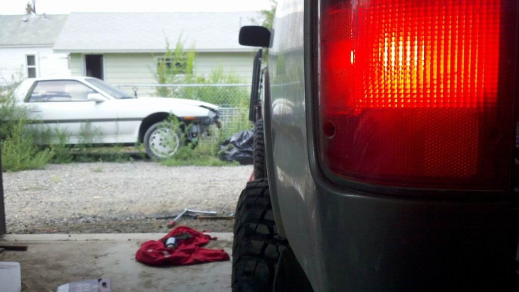

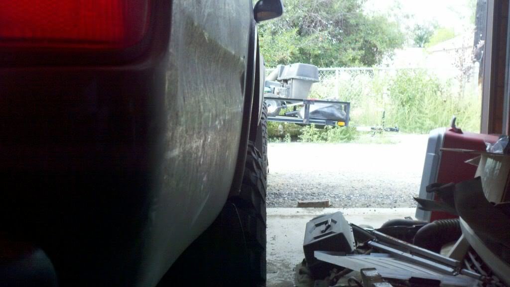

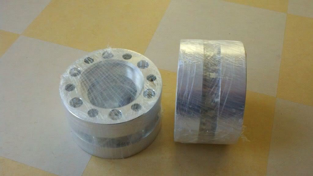

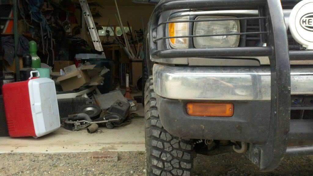

    Wheel spacers came!
    Hubs were pretty dirty
    Using a wire brush, scotch bright pad, WD40 and a rag latter
    Much cleaner.

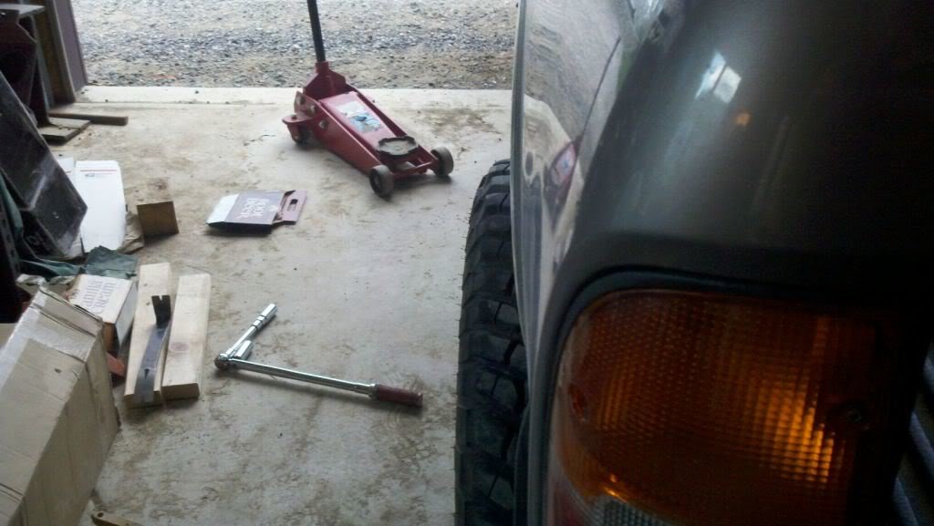

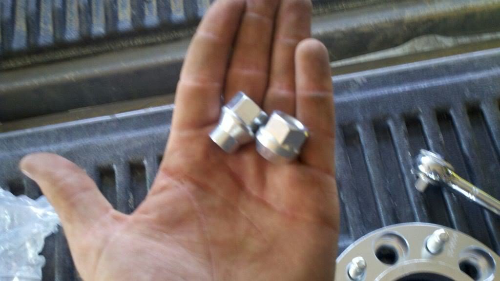

    Spacer installed at 90ft/lbs, i used Allpro 1.5'' spacers and also Used the Allpro ET nuts. Didn't REALLY need them for the back...defiantly glad i got them for the front.
    Here is a ET nut next to a standard thread nut
    Rear driverside tire with spacer
    rear pass side tire without spacer

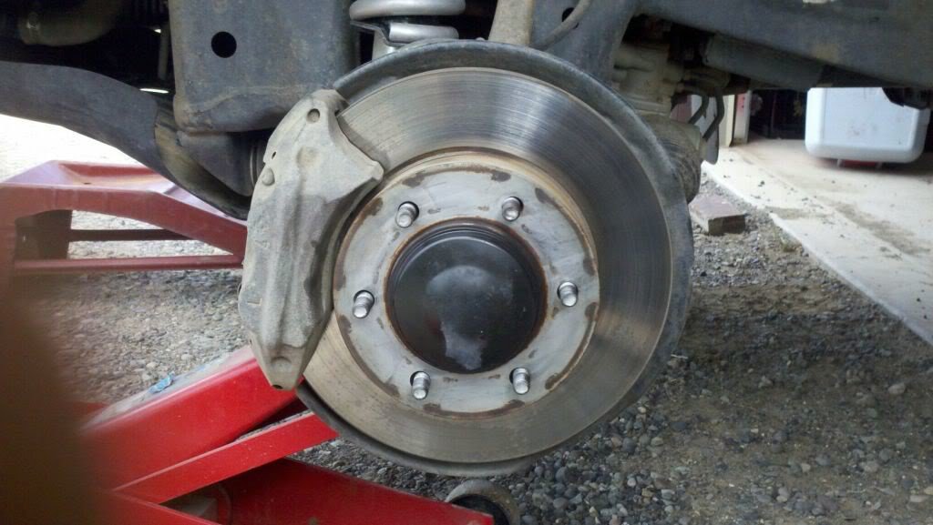

    The fronts were much cleaner then the backs. Cleaned up better too
    Driverside with spacer
    pass side with out spacer
    Driver side with spacers
    passenger side with out spacers
    Over all im very happy with the look and parts. I will be checking the torque tomorrow to make sure everything is still snug. Defiantly made my truck look more aggressive and meaner. Just putting around i have already noticed ppl lookin at it. Sorry i dont have any good pics of it but they will come!
    next big thing is my Elite bumper, whenever Tim finishes it, plus color match grill, satoshi, think ill paint the skid plate too, and im gonna get exhaust too i think. im tired of not being able to hear it. Also Deckplate mod will come very soon, just waiting for the deckplate to show up. I have been talking with Marco of DSM to see if i need 10'' 5150s. Will have an update on that soon.
    thanks for looking!

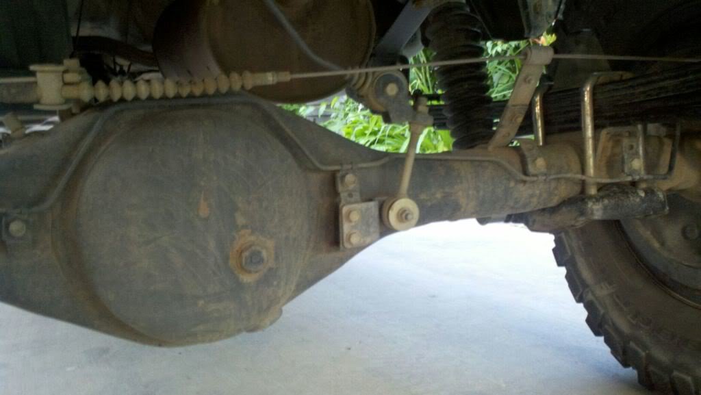

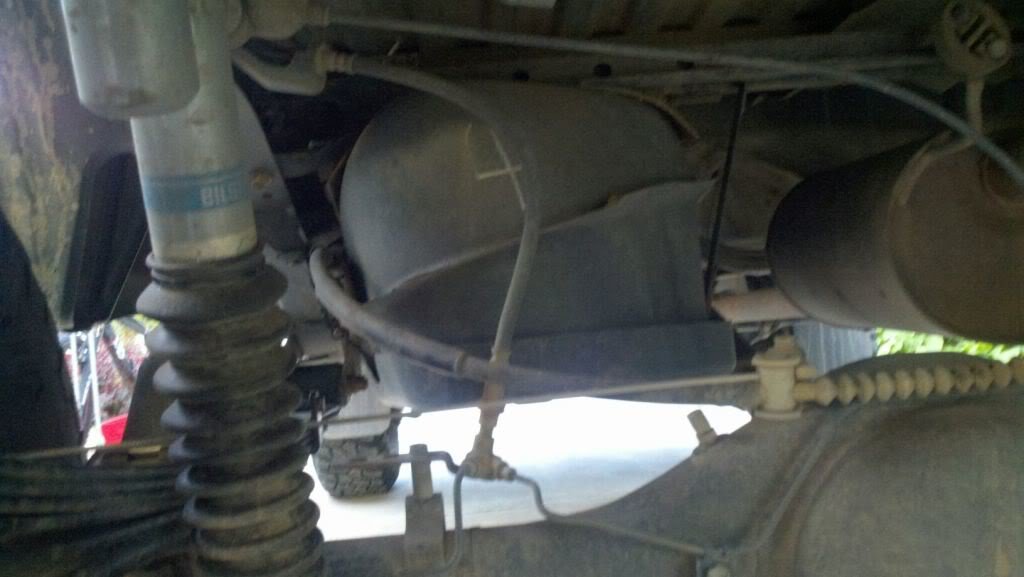

    Yeah, thats the brake proportion valve. It balances the braking pressure for the rear brakes. If you lift too much, you can loose braking power in the rear.
    Your suppose to raise the same aboum you lift your truck. (eg. 3" lift - raise it 3")
