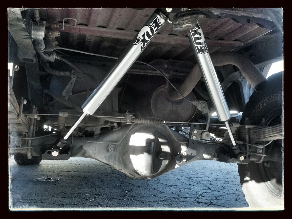

    I think they are close to finalizing the design. I think those are 12" shocks.

    hmmm..some interesting options there. Woulda made our job a hell of a lot easier.
    Yea those are probably 12s. Looks like you could set up 10s easy though. Some short body 12s would fit easy looks like too.

    i realized my shock triangulation is going to get another step added to it, ill have to sandblast the axle to get rid of the rust before i can weld tabs to it then repaint it

    Ugh, won't be running these Icons for long if I want to go for some more travel. 12" short bodies would be awesome....

    Haha..that is gonna be pricey.
    just relocate your 9.75s.
    I did mikes 8.5s and i bet he has just as much travel as me if his leafs would let the shocks use all their travel. Has 1-0.75'' down travel of shock left and about .5'' i think till bump give or take. No actual numbers..But with the 8s he has 10-11'' travel numbers with how they are mounted. You could get 12'' travel numbers with the 10s.

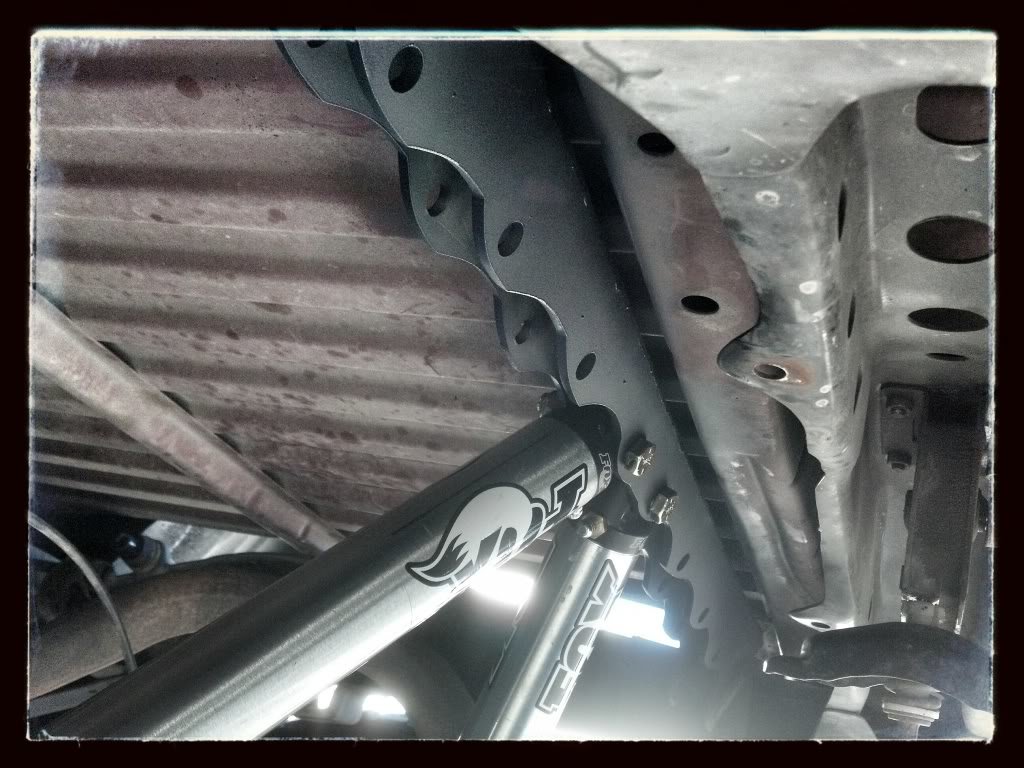

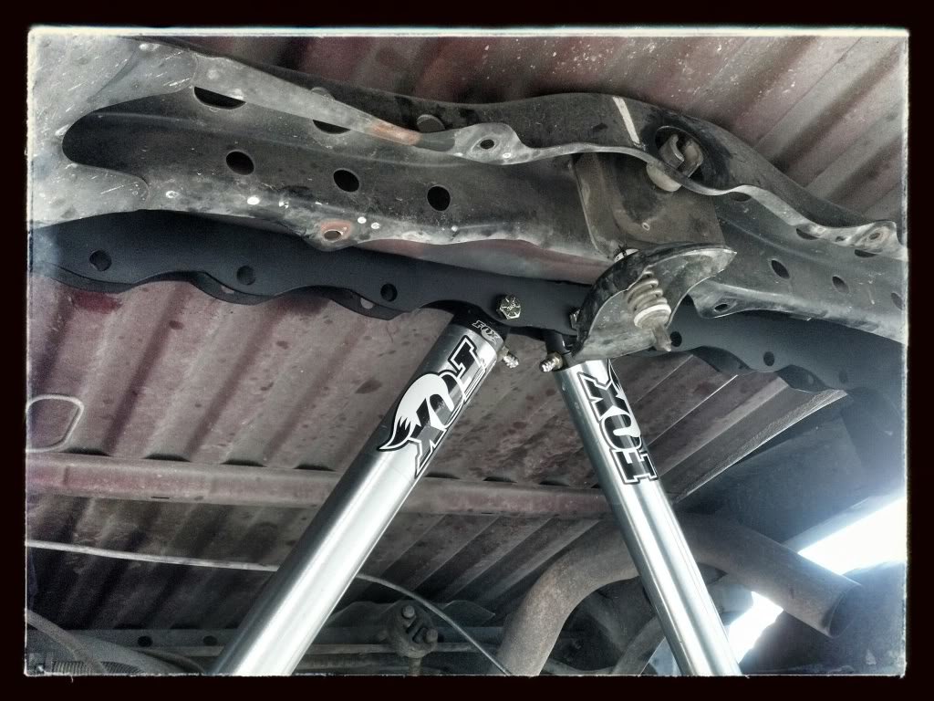

    The only thing I see there is the bottom "trays" seem just a bit exposed. I could see coming down on a rock with one and bending or breaking one off. :notsure:

    its possible i guess..
    but not really that different from a lot of shock mounts off the back of axles.
    It looks like 1/4'' knowing jerry or even thicker..ha so i bet it would be fine.

    It definitely gained some flex. :cheers:

    yea it did :cool:
    now if your leafs would let it droop more...

    yes. 63s with triangulated 12" shocks is definitely the plan now. that combo has proven to give great articulation, and its really not that expensive. so thats the plan.
