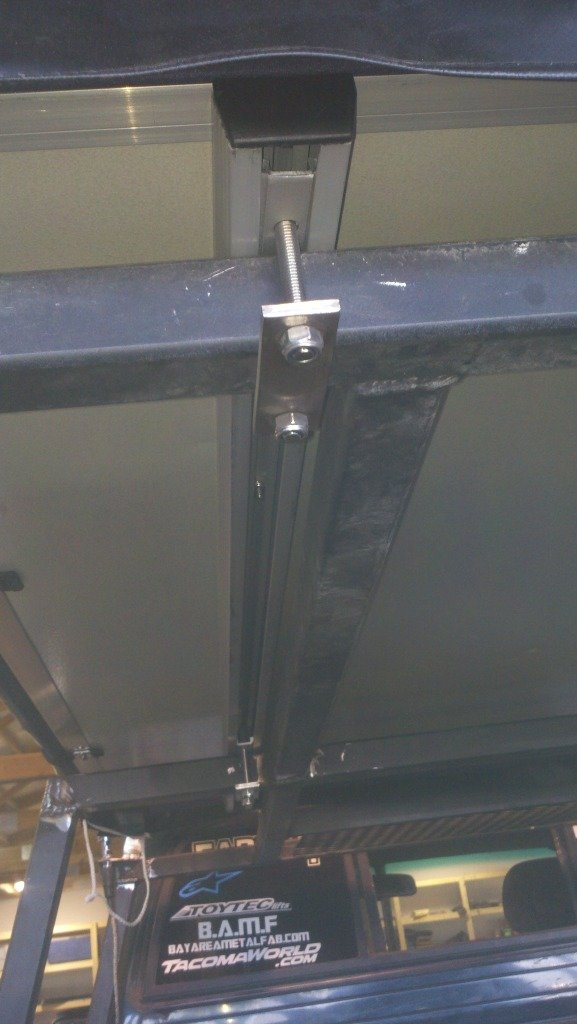

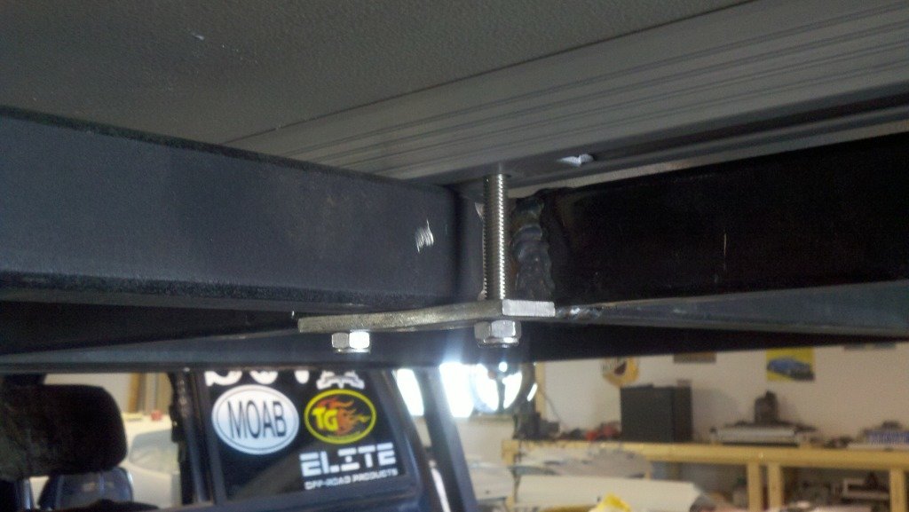

    does the awning mount similar to the tents?

    No the awning is just bolted on with L brackets. Tent uses two bolts and a plate as a washer to clamp on tubing.

    hahahaha
    okay..pictars help? :p
    RTT mounts like this:
    Awning is mounted like this:
    Better? :D haha

    I already have the tent :p
    Just wondering about the awning and if it could suit my build.
    Great pica though monte

    well basically..the whole back of the awning is just like the sliders that hold the bolts for the RTT. Works the same. two bolts in each rail and you have to bolt it to something with the slide area. and really...probably doesn't even have to be an L shape, could work flat..but you'd lose about 3'' of height.
