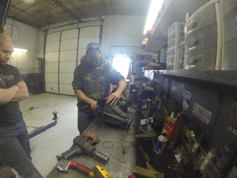

    your pinion depth is shims of course...let me go look at my 8.4.
    if you can see, here is my 8"
    that silver wheel (and an adjuster on the other side) is what we used to align it. those would set the tension/depth of the ring. we used a ghetto made spanner wrench to tighten or loosen that wheel.

    Is that brady sleeping? Looks like a super fun time.

    yea think its the same Mark.
