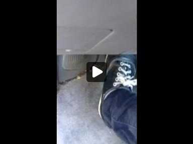

    Damn it sorry. Throw out is what I meant. The one on the input shaft.
    It'll still spin when truck is in neutral.
    I'm guess if a new spring in the slave was put in then it would go away

    It does yes.
    Be curious to try it anyways. Say to pull the slave and take it apart. Then just bleed the lines

    Can't see the video but one thought is it could be the input shaft bearing in the trans case. I had to replace one on my Integra a long time ago, sound went away when the clutch was in. Throwout bearing typically makes noise with the clutch out.
    Pretty simple to replace.
