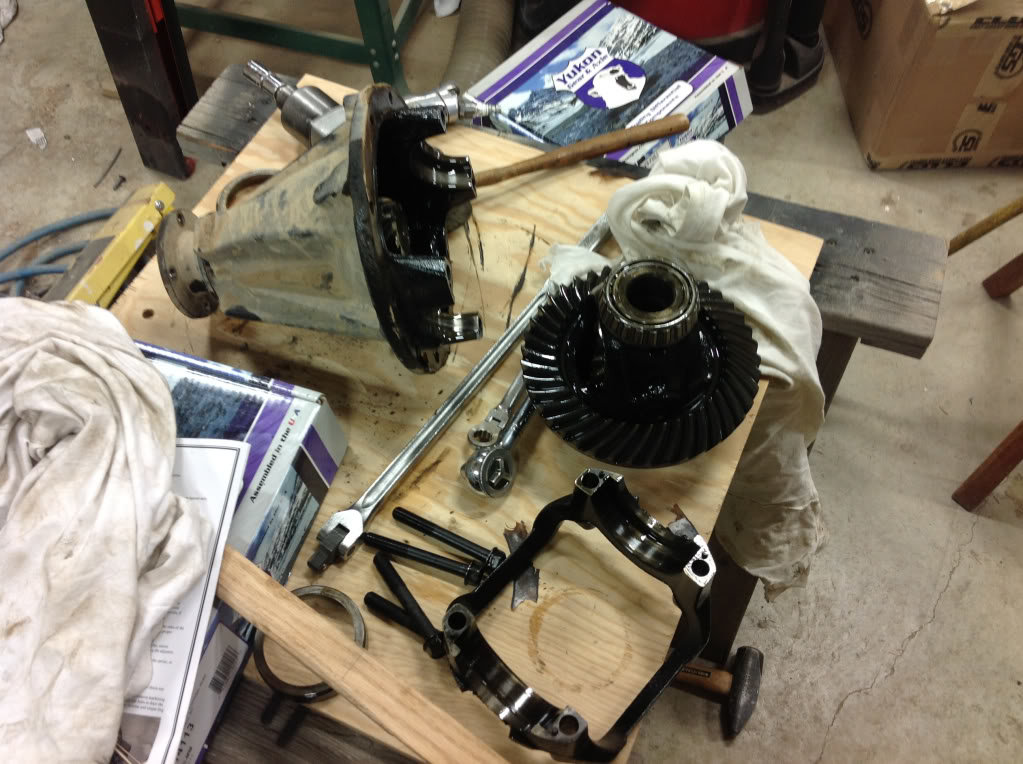

    1) here is my final pattern for the front. Almost perfect. pinion is a touch deep but changing it affected the backlash too much so this is where i ended up at.
    Cool tool we had that just needed tweak to help tighten pinion
    [​IMG]Front diff.jpg by Monte Nickles Photos, on Flickr
    and wear pattern.
    [​IMG]Front diff-2.jpg by Monte Nickles Photos, on Flickr
    Done!..minus the seal..
    [​IMG]Front diff-3.jpg by Monte Nickles Photos, on Flickr

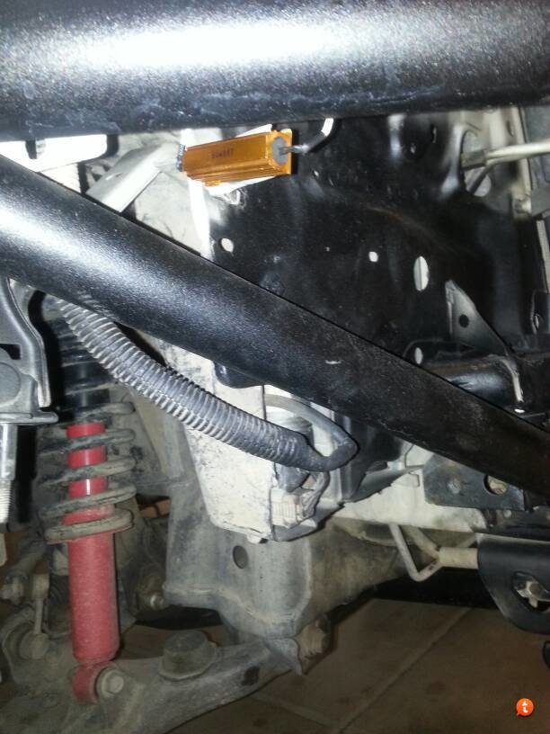

    Two questions:
    No low fluid sensor?
    Hard to tell in the pictures but is the pump prone to getting rock bashed?

    i don't have a low fluid sensor. Think its a new thing. Didn't have on on the stock one anyways. :notsure: so not an issue for me.
    Not at all. The skid covers it completely. When i mount it back up ill take a photo for you.
