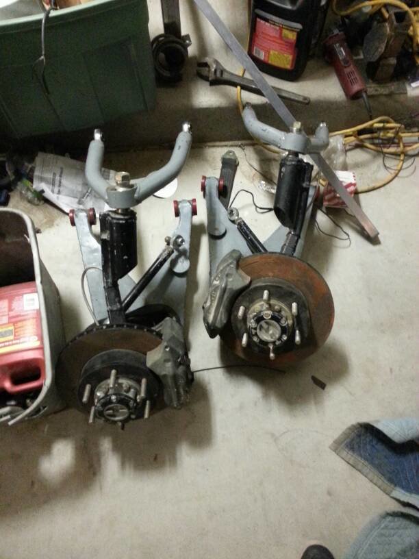

    #8239
    JuansTaco
    JuansTaco JuanInAMillion
    Nov 18, 2012
    #91397
    8,904
    Juan
    gilbert az
    2004 PreRunner SR5 stormtrooper
    ESB long travel kit, Deaver f67s with DTF 12 inch shackles.
    Here is the kit i picked up. It has stock modified spindles with 4wd manual locking hubs so all I would need to do is get custom half shafts
  20. Aug 14, 2014 at 1:26 PM
    #8240
    Blackdawg
    Blackdawg [OP] Dr. Frankenstein
    Dec 31, 2010
    #48500
    81,652
    Monte
    Wyoming/St. Louis
    The Trifecta of Taco's
    Yea see thats a custom kit. Cool yes but not really helpful to anyone else.
    The reality of it is that there isn't a easy non outrageous pricey option for going uniball lowers.
    Sadly
    Also ball joints last longer then uniballs anyways. Most uniball stuff is 30-50k on average. Ball joints are more 60-100k. Depending one the abuse and treatment they get
