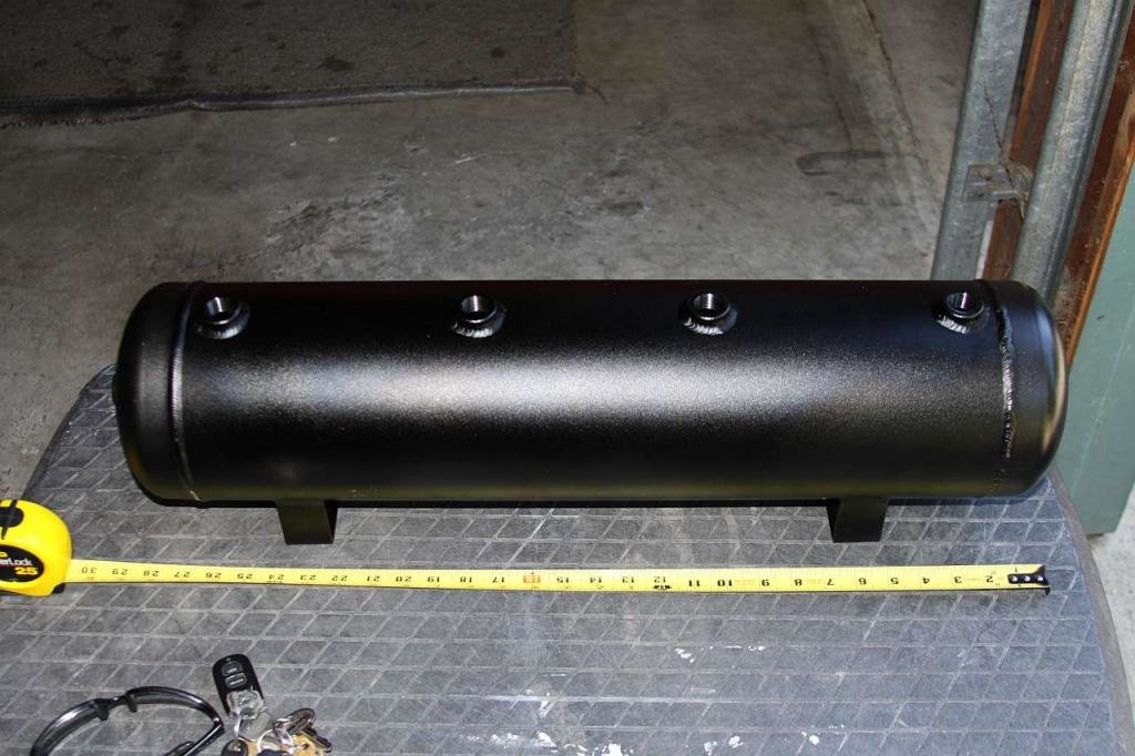

    Yea what I'd have done.
    Could still do it mike. Then for the bottom use 3 or 4" wide flat bar and attach the tank to it so that the bolts go where the ridges are up. Then attach the 3-4" flat bar to the bed in the places where the ridges are down

    Or what Timmy just posted

    Haha, guys frorget who it si you are talking to. All that that bajataco did may seem simple to you guys but to me...:eek:
    " I started to create a frame for the air tank to mount to, first by fitting and trimming some angle-iron to one of the cross members under the bed. Then it was drilled for bolts. "
    He makes it sound so simple... :pout:

    If the built in mounts wont line up, seems like this will not be optimal.
    Also, it looks like bajataco is mounting directly above the diff and driveline because he has already used the space where the spare was. I don't think there is room under full compression of the rear axle.

    I'll draw up a nice way to do it where all you'll have to do is drill holes. And make one or two cuts of flat bar.

    Awesome. Need dimensions of the tank?

    Looks like ~28" x 6.5"
