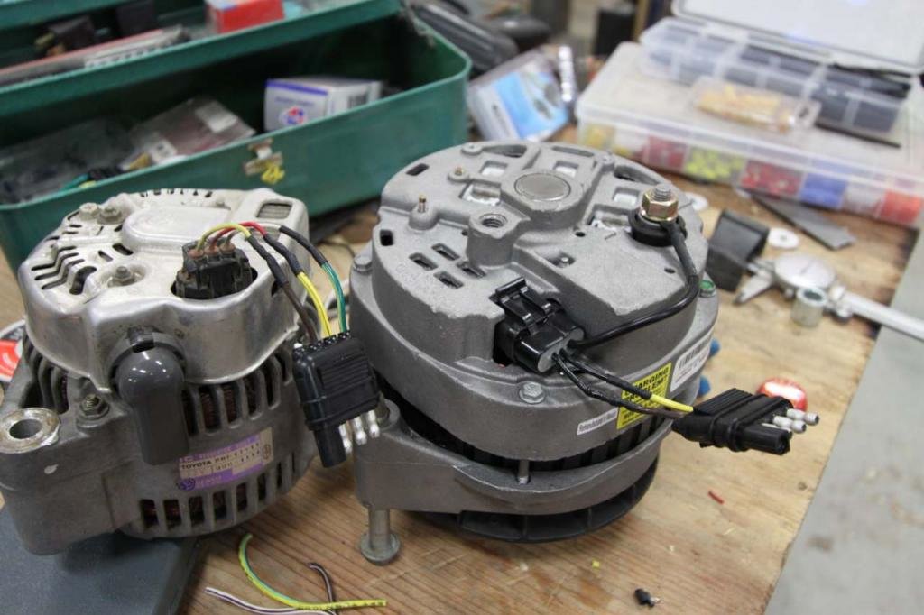

    Like a plug in play harness too the Toyota one?

    Yea I used all weather trailer plugs to connect to the Toyota harness and put the same end on the stock and cs144 alternator. So I carry the stock as a spare and stock belt in the OSK.
    Pigtail is easy to find. Just a sec

    Sounds like a plan. I ran 4ga for the cs144 but left the stock harness intact and just un wired the normal positive lead from the stock alternator. That way I can wire it to the stock one in a pinch.
    I think you can make a tray of some sort to sit right behind the cab under the bed. Just gotta make it strong.
    I don't see the benefit to moving the starter battery really..but could if ya wanted.

    No I'm not going through the stock fuse box. The stock one does. I'm saying I have the stock wiring still in place so when/if I have to swap the stock on back in on the trail in bolts right in and wires up just as stock.
    The cs144 goes straight to a break. Then the battery. Then the fuse box.
