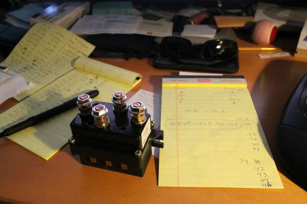

    Took the winch box apart.

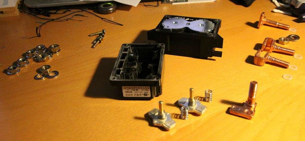

    Checked all the connections, couldn't find anything unusual. The solenoid seems to be the issue. It will engage the motor in the 'out' direction but just clicks on the 'in' direction.
    I am wondering if it would be worthwhile to take this thing apart?

    You can Taj the solenoid apart. Could just be a dirty contact that needs cleaned

    I took my solenoid apart to seal it on my smittybilt. Wasn't any worse than taking the box itself apart. I say go for it.

    Yes take it apart and clean the contacts. It works we could hear it clicking, the contacts just need to be cleaned. Use some fine sand paper to make all of the pitting and Burned areas shiny.

    Yea do what my dad said mike. Shine up the contacts good. Then maybe apply some silicone sealant to the outer case when you put it back together

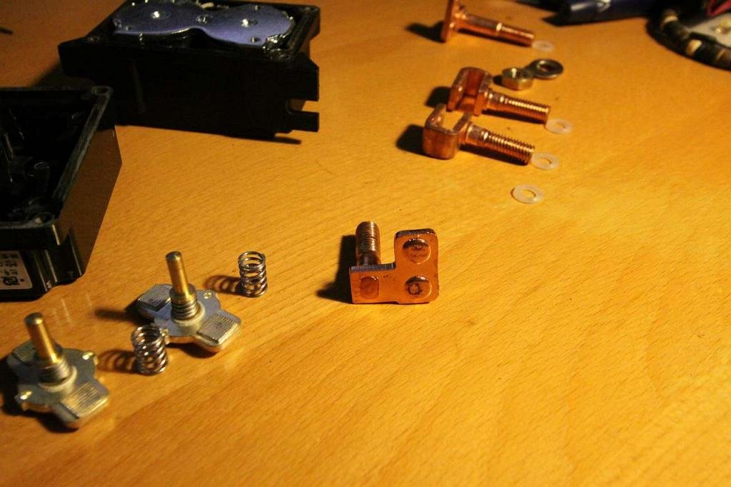

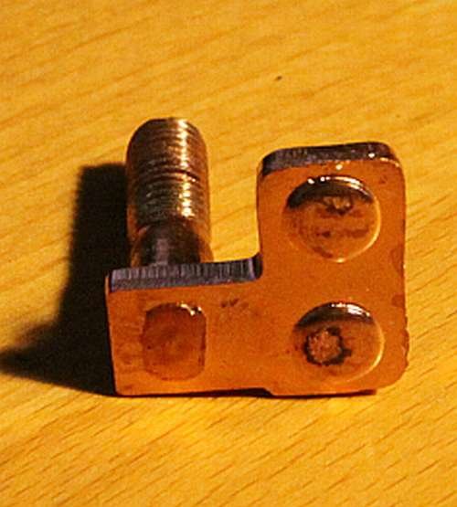

    You guys were correct, one of the copper contacts had a small burn mark.
    I guess that was enough to keep it from engaging correctly. Cleaned it up and it is working again. :woot:

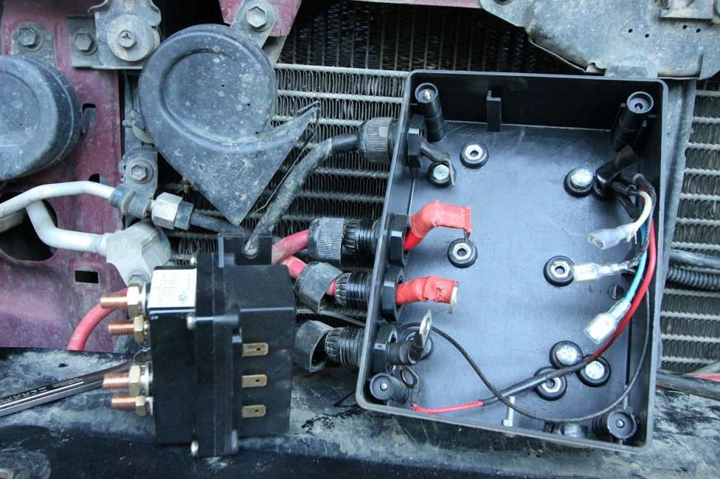

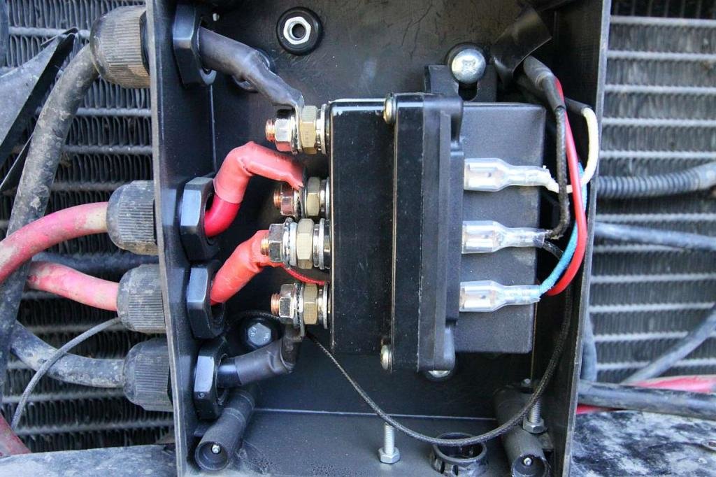

    Yeah, I did this, even tho it was very clean inside the plastic outer case. There had not been any moisture intrusion into the case at all. And inside the solenoid was spotless except for that one center contact where a bit of arcing had occurred.
    It is an interesting design. Unfortunately, I think it is going to happen again. :(
    I also moved the box from where it was. Is now tucked inside the bumper, between the fog light and the winch motor on the passenger side. Had to remove the headlight and the fog light to get it in there. Barely, barely fit, but everything went back together correctly. These bumpers are so tight for space.
    I did have to extend the winch controller lines that run to the cab to do this. Got to practice my soldering skills. :cool:
