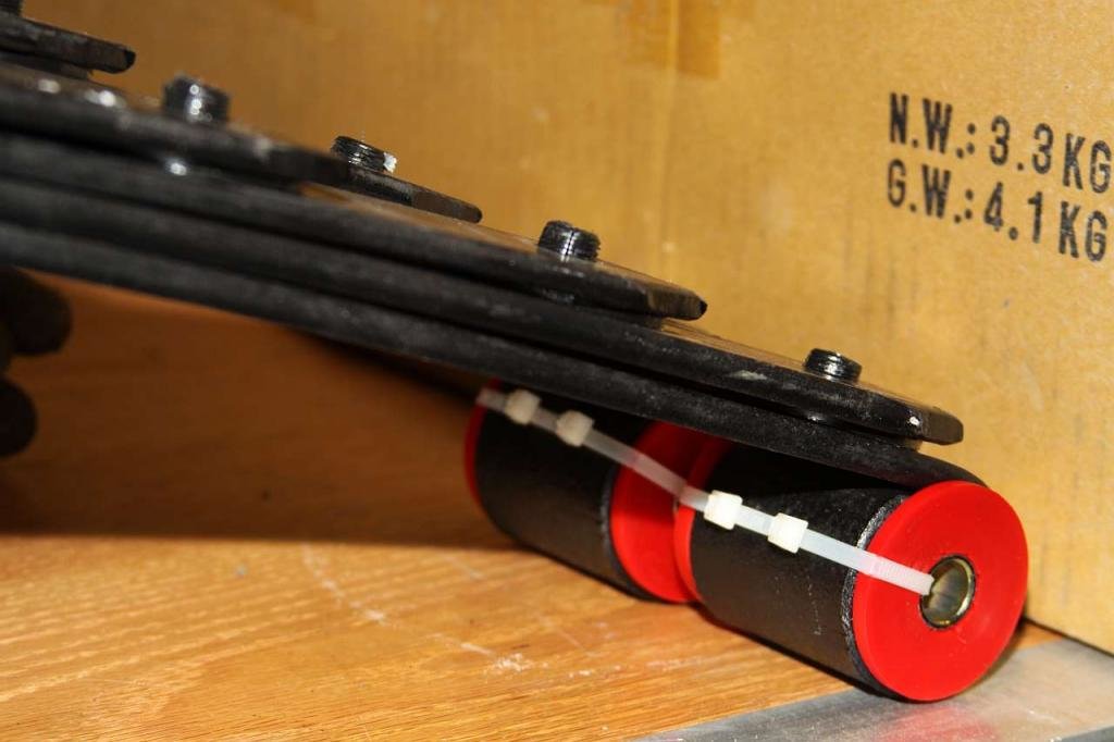

    Leaf spring bushing question. Do you grease the O.D. of your poly bushings or leave them dry?

    Grease em. Or they will be a bitch to install.

    They are already installed. :eek: Is the only reason for greasing the OD to ease installation?

    NO! you want the sleeve moving not the bushing in the spring! You'll get the squeaks. Grease the insides and the sleeve, plus the outer face of the bushing that meets the mount but not the part of the bushing that touches the leaf on install. Might be a bitch to press in but it's supposed to be.

    So they weren't pre greased??
    I greased em in and out.
    Also....new leafs :woot:

    Thanks Marc. See the above post.
    It was also interesting the the inner sleeve ID is .575 and the shackle shaft is .550. Is .025 too much slop? There is definitely slop.
