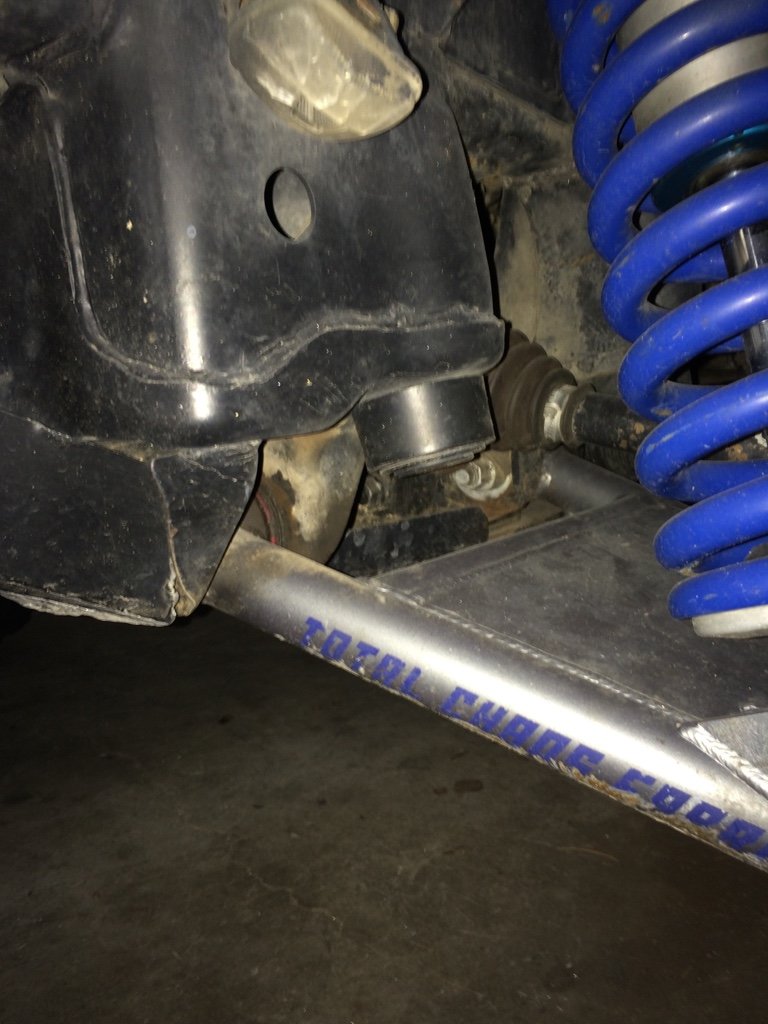

    True. I'll see what happens. Gonna need to align it then go for a ride. I hope it's not too bad. Considering my rig is near 6000lbs for trips and my 620lbs suffered I was hoping 700s would be good. That and mike has 700lb Kings but they are 14"s.
    Hey do you have a photo on how you did your bumps too? Did you tap the lca or the truck??

    UCAs and LCAs are so fucking beefy haha I love it

    This kit is bitchen man. So well made.
    I will show you what I did there in my write up :cool: I'm kinda proud of that idea.

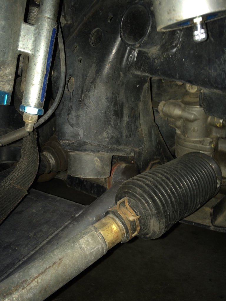

    I used the factory threaded holes in the bottom of the frame. They are metric. I just re-tapped it with sae threads for my bumps and used red locktite. Never a problem
    edit
    I did have to shorten (grinder to the rubber) one of the bumps tho so they contact the LCA at the same time. Factory bumps are two different sizes.
    YRMV. Just cycle it with no spring in the coilovers.

    Hmmm...interesting. I guess Toyota must have switch ped LCA design from 95-97? My stock bumps and in the LCAs and bump off the crossmember. Not even sure if the metal there is thick enough to tap
    I have the same Foam bumps you do

    Yep..mine is the exact opposite...balls..
    Hydros it is then..
