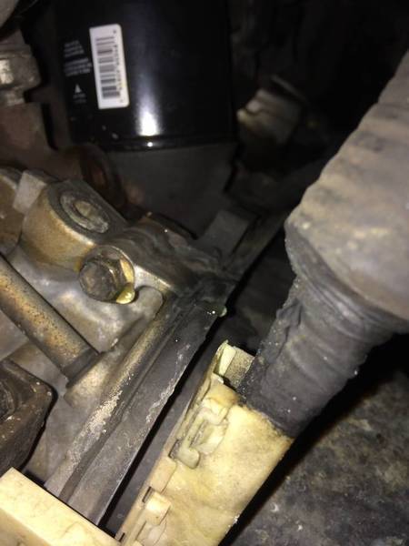

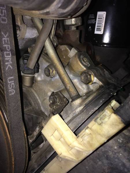

    Sorry to bother you monte. Got a quick question. My 4runner is leaking antifreeze pretty bad. It's leaking and dripping off the bolt to the right under oil filter and around the oil pan right there. Any ideas of what's causing it. I replaced thermostat a month ago

    Could be the freeze plug right above the AC. Or..head gasket. But I doubt it's that.
    What's the loose hose dangling there though?
