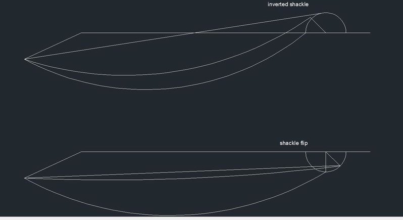

    pretty sure i drew this up right. just for other people to reference. top picture is inverted shackle, lower flipped.
    top line would be up travel with the pack flat. middle at typical ride height (45*) i think thats right? and bottom with shackles at lowest droop before risk of inverting?

    Alright... wow. Ok guys so it seems like shackle flip is actually detrimental. So in my position. Would you just go with an expo leaf pack or should I build my own? Also, since we're saying screw shackle flip should I still get a shock relocation kit? I suppose it will all be based on me measuring full droop/compression without shocks in...

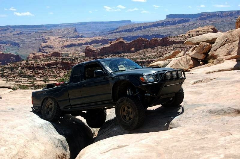

    ^^^Uptravel is definitely nice for keeping your rig level. I wheeled with Mark a lot in Moab and most things were sketchier for him than they were for me because my extra up travel kept my rig level through everything.
    The downside to up travel is that the more up travel you have and use the closer your frame and such get to the ground. I get hung up a lot more than Mark and drag skids, frame, and sliders a ton where others don't.
    ^^^This picture was one of my big motivators for going SUA in the rear!

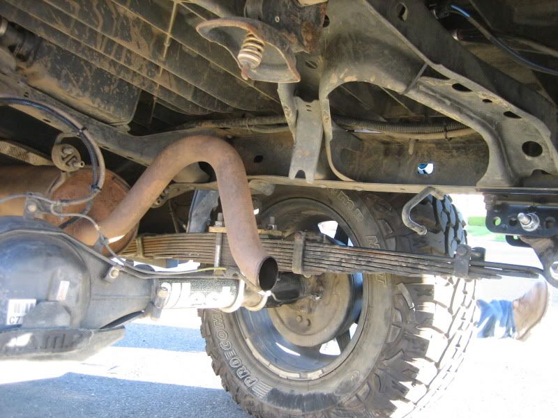

    Like I said...draw a line. Use a piece of string and tie it to the front hanger. You will lose uptravel unless you let the pack go negative arch. It's simple math. You can't gain droop travel without sacrificing uptravel unless you allow the pack to go negative arch. You certainly can allow it to go negative, but springs are consumables. They are not buy once cry once. They have a terminal life expectancy. And allowing the spring to go negative will shorten the life span. I'm on my third set of spring under leafs, and I set my pack to bump about 1/2" negative arch.
    Here's an example of a flip kit at stuff. See how the bump stops don't even touch the frame and the pack is completely negative.
    And simply put...you don't need a flip kit to get some good droop out of a second gen. Shock relocation is key. Again, example. Here's Pelfrey's kit with 35's drooped below the sliders...still with factory inverted shackles.
    If all you are concerned about is droop, then cool, go for the flip. But based on your other posts it sounds like you want something more balanced so you can still do some of the go-fast stuff. And for that...I'd say stay inverted.
