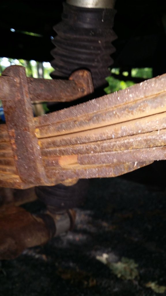

    I would not purchase the all pro springs again either. I've had mine on for about a year and a half now and both packs look like this. Actually both packs have 2 broken leaves, and one of them is literally in the middle of the pack almost dead center on the leaf. This is after just one winter(taken this summer)
    That is the standards with stock bump stops. I think they need to have longer bump stops with the leaves. They flex like crazy and get way into negative arch. To all pro's defense they did contact me after I posted a few pics of my leaves in another thread and they offered to work with me to.replace them. I bought them second hand off another member(with<5k mi on them) so I wasn't going to try to trick them into giving me new leaves. My next set will be Dakars. Don't need crazy flex of crazy droop, just a decent all around leaf pack.

    My deavers look about like that after 1 year... though all of my dunes wheeling has sand blasted the paint off of everything and then the winter salt has rusted everything up... maybe they aren't quite that rusted though. No broken leafs though.

    Ya I'm not too concerned about the rust, if you think about it I'm not sure what type of coating would be flexible enough to stay on a spring and durable enough at the same time. At least not up here in rustachussetts. Maybe powder coat, but even then it doesn't last long. The broken leaves is definitely from negative arch. I have scuff marks on my frame from my 31's hitting it near the top. With stock bumps I am real close to stuffing my 31's into my fender wells

    I've never found a leaf spring that didn't turn to shit without maintenance. I spray the outsides of mine with rustolium a couple times a year. And the insides are sprayed with a dry aerosol moly lube. Especially in the rust belt, leafs need maintenance.
    Looks perfect to me.
