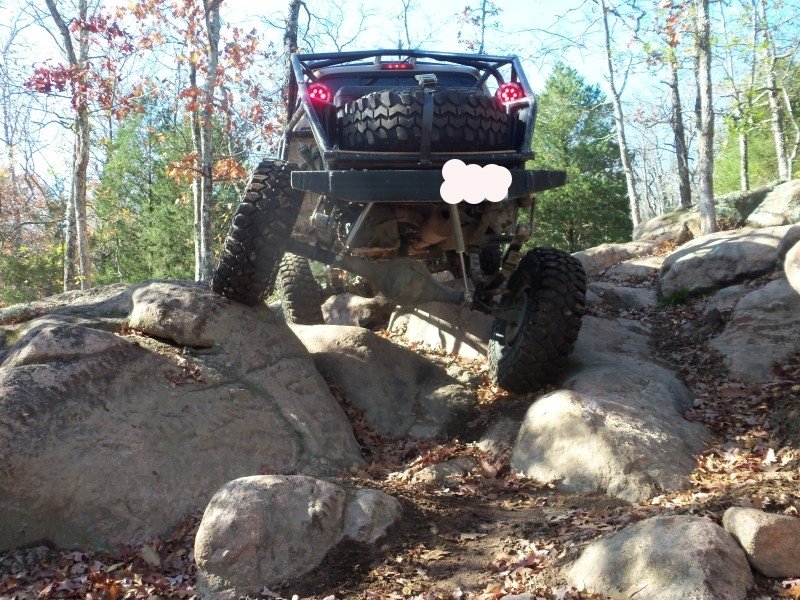

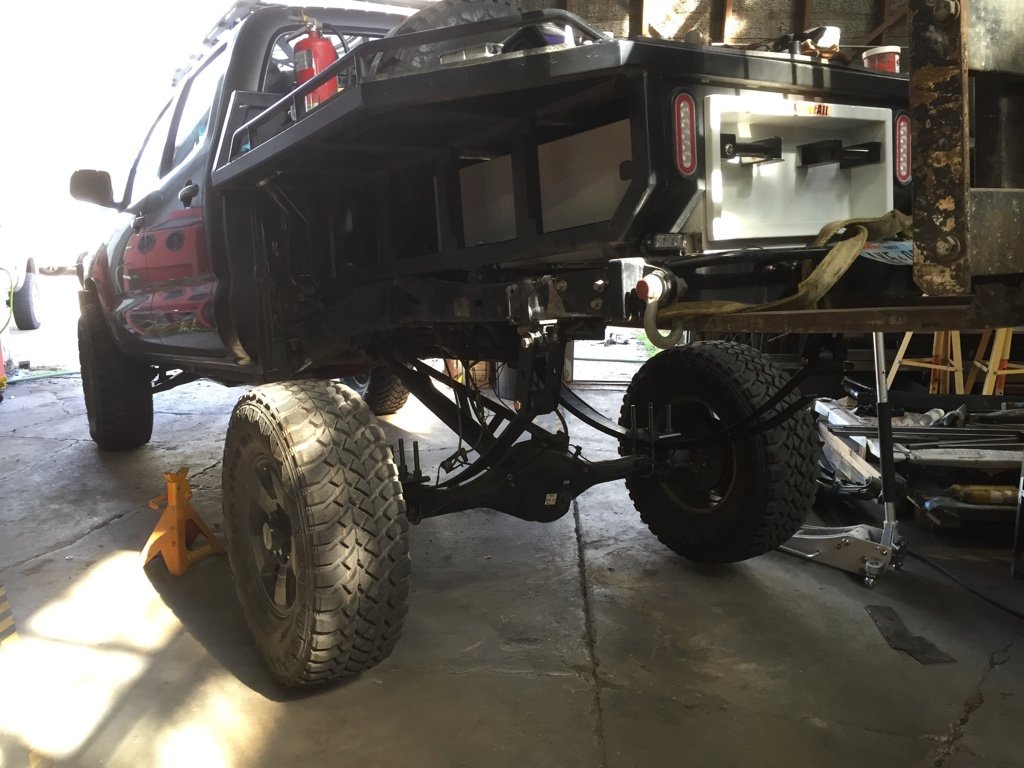

    I too agree uptravel is underrated... Everyone be riding on them bump stops... I see so many people 1-2" or even less uptravel... Gotta have some uptravel at least. Even if you are crawling, we don't go 2 mph everywhere, there is hundreds of miles of trail travel sometimes.
    Here is aftermarket leafs and similar stock location shocks and 8" shackles...
    Here is chevy 63s with better shock location and 6" shackles

    Not trying to step on toes.... But Tyler is running the ATO Shackle flip, he had it then removed it at some time and is running it again. He has the XJ 5" shackles to run with it and the expos. Was out wheeling a few weeks ago with him and his droop is crazy. Perfect pairing with his shock relocation and the shackle flip for more droop.
