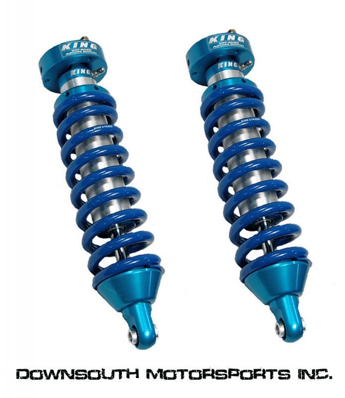

    This is what I have, and sounds like I need to get the UCA.:rolleyes: All research re-valving and making it mid travel, sounds like what i'm looking for.
    I have the stock TRD skids, need to build some tho. And still have the sway bar on, been meaning to take that off.
    Always liked the fiberglass look, but will see. And I have a work truck so its really just a weekend warrior.
    Moab trails, logging trails. More overlanding then anything.
    Even if I get to it before you all be looking forward to your right up. You never know might give me a thought and all tear it down again:D

    Yea Id stay with mid travel for now.
    Take the sway bar off too. That'll help a lot by itself haha
    I'm actually in Wyoming for half the year and in Missouri the other half. Couldn't really say what colorados economy is..
    I'd mess with the mid travel though. You can dial it in so its smooth and comfy. Trust me. I'd also try taking some preload off the springs. Judging by your sig pic the front is a bit high. Taking off preload will lower the front a bit and make the ride smoother too

    All for sure revolve, I have a free revalve from king. They will take out that shaft spacer Monte was talking about. Then UCA's:D If I don't like the second round all dig into them myself.
    Yeah I didn't think it was the coils.
